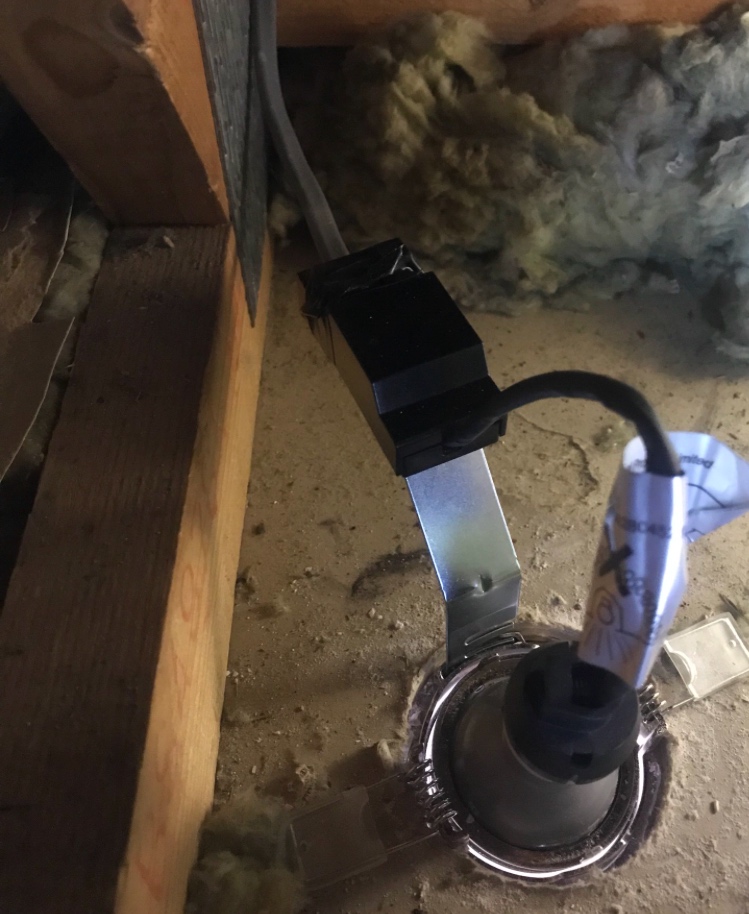

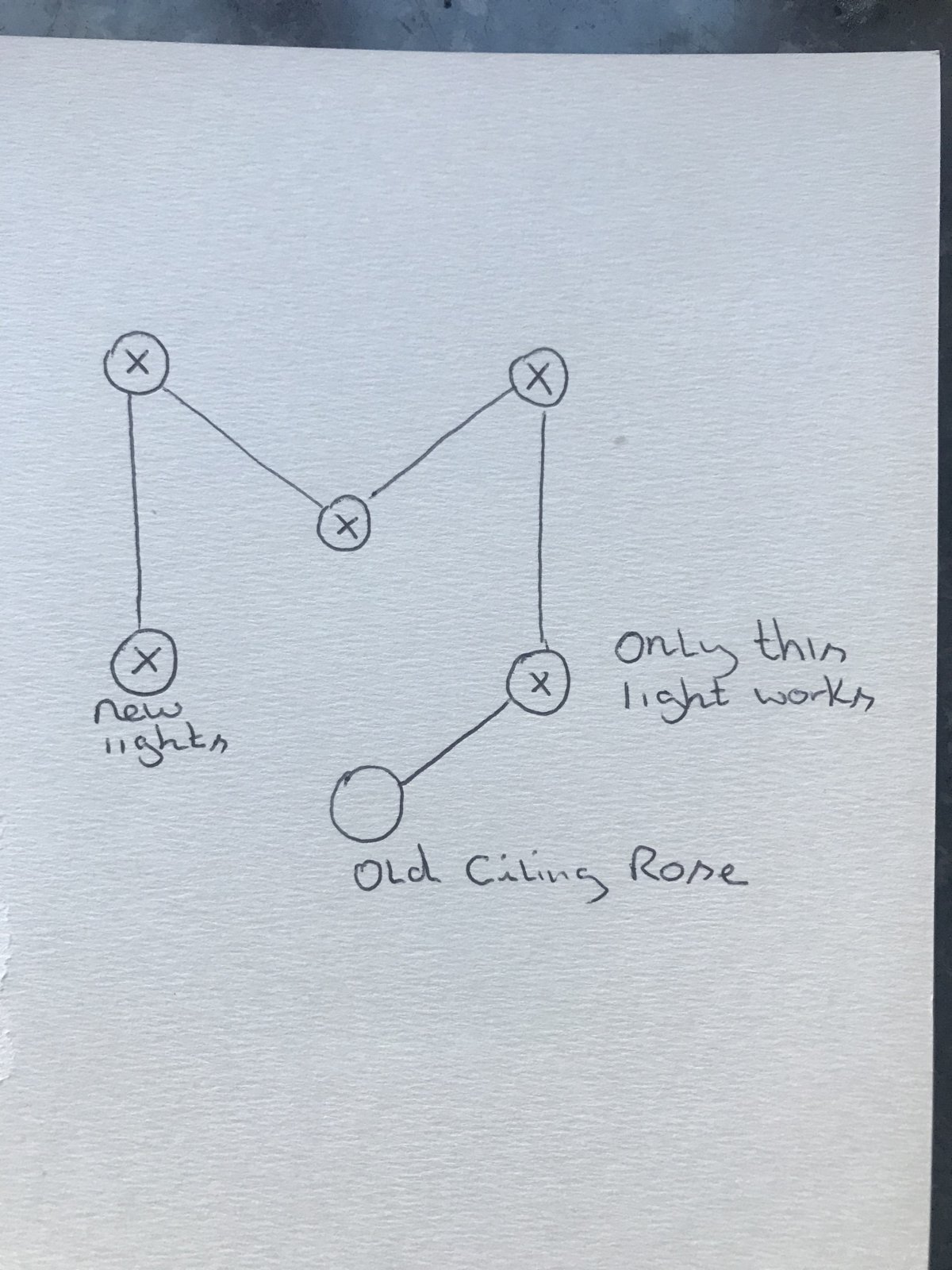

hi , advise needed, just fitted 5 spot lights in a row , all have power supply going in then out to next one except the last in the line and the first which is connected to power supply of old ceiling rose , problem is only the first light comes on ? What am I missing thanks , picture of last light in the row .

Layout of lights

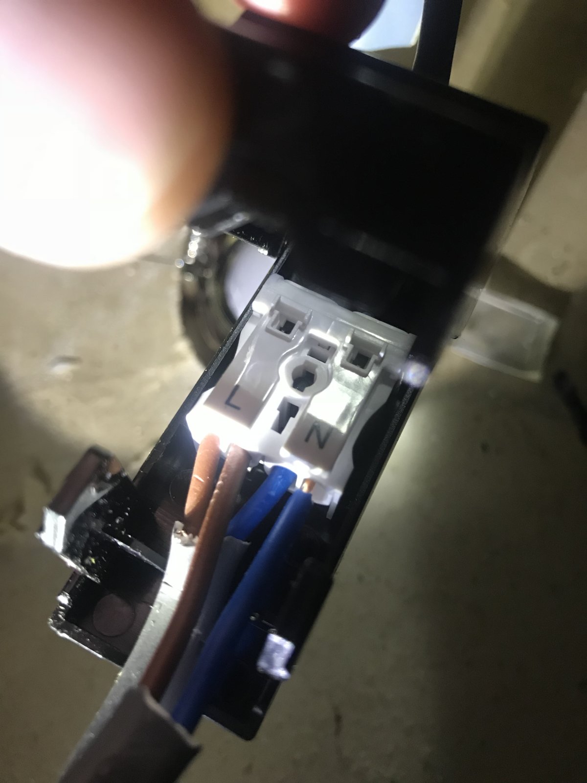

Check the connections at the Light that's working. You able post a photo of the Terminations
Just a simple clip connector , tried other lights in its place and still only first one will light
Seems to me that the fault is therefore on the connections or the cable that is between Light one and light two (call this cable 2).
So first thing I would do would be to re-push-in the cable that on light one is going to light two.
Second thing I would do would be to re-push-in the cable that on light two that is going into light two.
I say this as your image suggests that the neutral wire (Blue) is not pushed in to the connector properly.
SFK
Off back in loft to give it a go , see what happens cheers
All sorted must have been bad connection from light 1 to 2 . Re connected and bobs your uncle we have light
