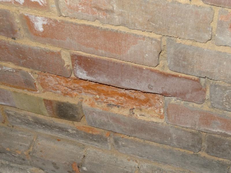

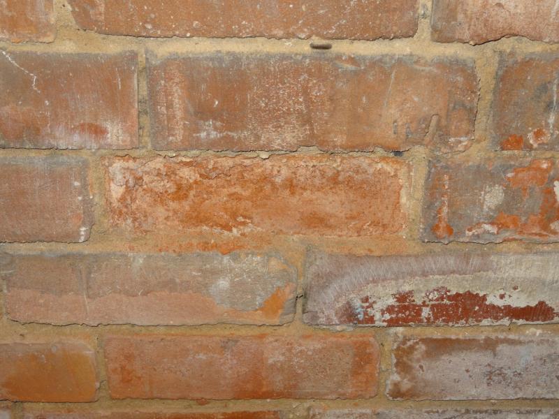

Something which is worrying me is that some of the brick work is literally flaking off, is there a good way to fix this sort of thing?

I had a few spalled bricks in mine that I have gradually replaced. If you post a photo then we can advise you on the best thing to do. A few dodgy bricks won't make the house fall down, but if there are extensive areas of spalled bricks then it might be worth getting a pro to sort this.

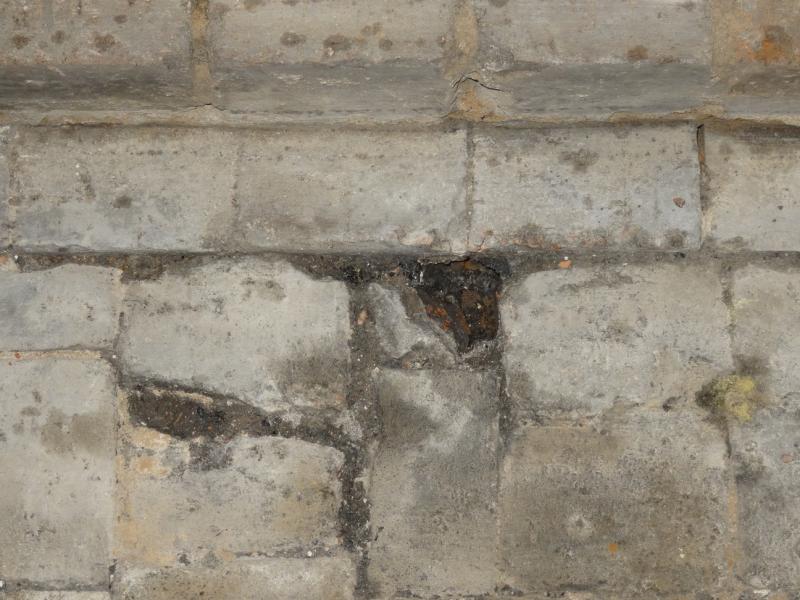

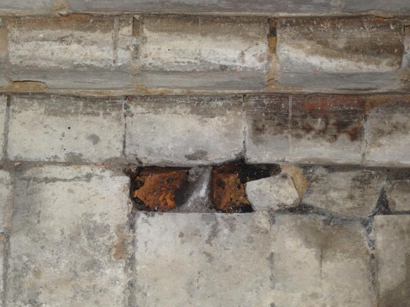

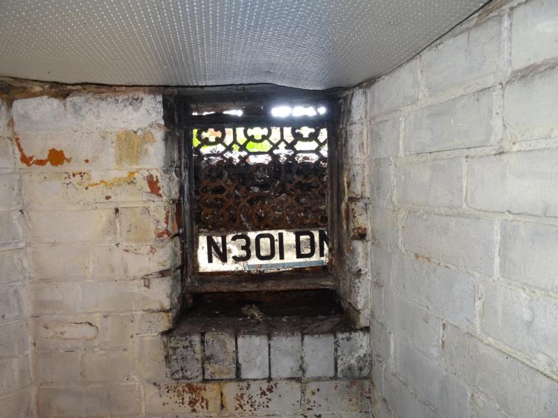

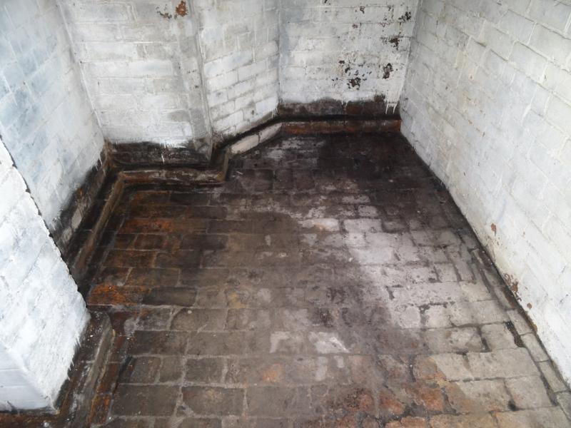

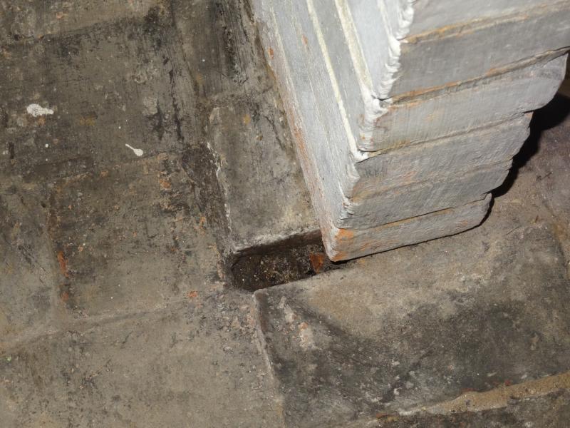

Hello thanks for the reply, I just took some photos.
Here is the floor on the side I cleaned out, as you can see it is very damp and there is all this weird white paint on the walls:
This one of the air holes and there was loads of soil in the gap there, I was thinking I should maybe fill the hole with something?
Photos of the floor where some of the brick work came up when I was hooving:
Some of the crumbling brickwork on the walls:
I want to do the other side now which is a bigger space and there's loads of soil in there also :(
Should I have all the three air holes fully unblocked? I'm aware this will make the house considerably colder though right? They were blocked up with polystyrene when we moved in.

Unblock any vents if you want to reduce the damp in the cellar as much as you can.
Forget about the spalling bricks.

A well secured fine mesh over the vents will prevent rodent entry etc.
Unblock all. The cold issue is solved by properly insulating the ceiling of the cellar (under the floor of the rooms above).
Unless you want to spend vast sums of money, cellars will always be cold and damp. Consider carefully before storing anything in them.
