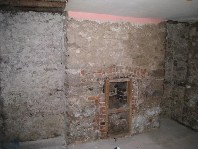

Hi everyone,
Just wanted to get a heads up on what I have planned for this basement wall.
The wall in the picture is a party wall not an earth retaining wall, in fact despite having a basement none of the walls are earth retaining. The earth is retained in the garden with another wall.
Now I am intending to use cement, sika waterproofer and sharp sand and render this wall. I then intend to paint on something called a cementone aquaprufe, which is a cold applied bitumen to the wall, and then finally dot and dab standard 12.5mm plasterboard to the wall, and then skim with finishing plaster.
My question is, is there a maximum thickness I should not exceed when I render with the cement? Will I get cracking? The front section of the basement had been rendered by the previous owners and is 20mm.
There is an opening for the fireplace which I will fix 12.5mm board to and a vent to allow for ventilation. The concrete floor has a DPM in it fortunately.
I just want to make sure I'm doing the right thing if I can have some opinions from you chaps? Thanks
P.S I am going to take more of the lime off the wall before I start because there is still quite a bit on there and may take the ceiling off where it abuts the wall. That pink stuff at the top is the old lime render with horrible pink decorating scheme :mrgreen:
Barnett thanks, I agree with you and decided to take all the stuff I've bought back and go with the lime option

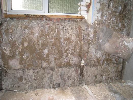

I use a SDS hammer drill + flat head chisel which you can buy cheaply in screwfix.
All the render you see taken off my walls here was 20mm thick. The key is to get in behind with the flat head chisel and drill along the wall not into it. Some of the time the cement cracks and drops off in large chunks. Other time I had to work away at tiny pieces at the time, the bottom of the walls seems to be most difficult - I'm assuming perhaps the cement had some sort of weatherproofer in it already, who knows
I can see where the brown, original lime is saturated with water and where there's clearly black/dark damp patches at the bottom where the waters not been allowed to escape!!!
Next thing is to carry on around and under the staircase!! Some of the highest damp meter readings are in this area so I want to get it off ASAP
