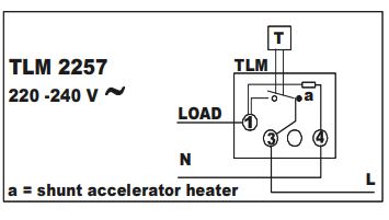

Hello. Im about 90% sure I know what Im doing here, Just looking for someone to check over before I dig in.
Im removing a Centaurplus C27 with stored hot water and fitting the Evohome setup that I had from my previous house. Old house was gas with on-demand hot water, so I have bought the hot water add on for this, Which leaves me wiring up 2 BDR91s in replacement of the old C27.
Im pretty sure its as simple as connecting the live and earth from the C27 to both BDR91s, then C27 1&2 go to the BDR91 for heat conections B&C, C27 3&4 to the BDR91 for hot water B&C and a link L to A on both BDRs
The honeywell system should then take care of the thermostat, however, there is a room thermostat that needs to be removed, and that part Im not sure of. I suppose I could set it on full and let the evohome do the job, but Id rather remove. Any tips? or anything I havent got right?
Thanks in advance!
With what you propose, you are connecting CH and HW control wires to the same BDR91. For example terminal 3 is a HW control wire and terminal 4 is CH control wire, yet you propose to connect them both to the BDR91 for hot water. :confused: The same is true of terminals 1 and 2 if they are actually fitted.
The wires should be moved from the C27 to the BDR's as below:
C27 N & L → Both BDR 91’s N & L (If using 3 core cable isolate/insulate earth wire safely)
C27 ‘1’ → HW BDR 91 ‘C’ (if fitted)
C27 ‘2’ → CH BDR 91 ‘C’ (if fitted - very unlikely)
C27 ‘3’ → HW BDR 91 ‘B’
C27 ‘4’ → CH BDR 91 ‘B’
Link ‘L’ to ‘A’ on HW BDR 91
Link ‘L’ to ‘A’ on CH BDR 91
As you have figured, the old room thermostat can't simply be disconnected as this would leave the heating wiring 'open circuit' and it would not operate, the integrity of the circuit needs to be maintained. As not all thermostats are the same, some working out will be required.

Yes, Well noticed. 1&3 to one BDR for HW, 2&4 to the other for CH. L to A on both
The Room Stat is a SUNVIC TLM model, and I am assuming is wired to the boiler house (The C27 is on the other side of the house, the boiler on the other side of the wall from the Room Stat) so hopefully shouldnt be too difficult to trace. The Room Stat is also right above the radiator for that room..... Sensible.....
If it's this model, the live switching wires are connected to terminals 1 and 3. Trace the cable back to its origin; note where the wires that go to 1 and 3 are connected and then disconnect all of the wires in the cable going to the thermostat completely. Finally link the terminals where the wires that went to 1 and 3 have just been removed from.
If your thermostat is different, or you need any help, post back.
As a suggestion you could do the BDR's first & set the TLM thermostat to max to test everything is working OK. Once you know all is well, then you can decommission the TLM.
