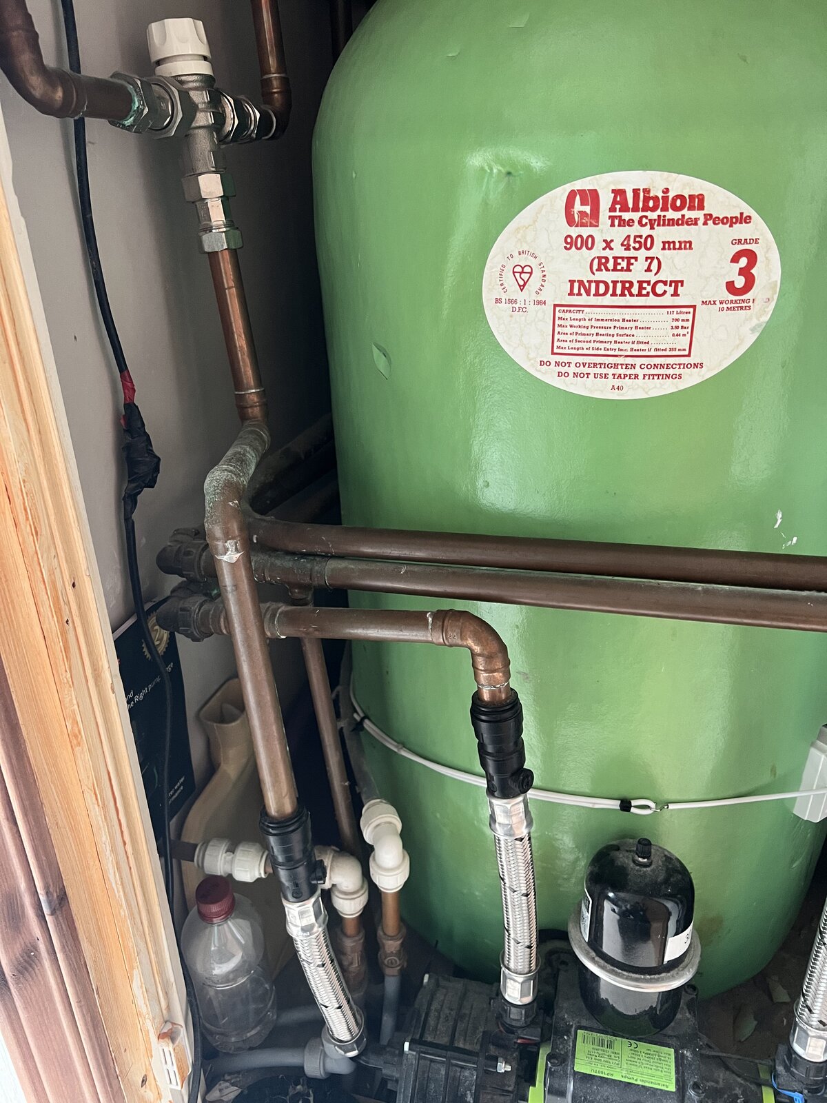

I would say you do, based on the Centaur. I think you may have an S plan, x2 valves in the wiring/cylinder cupboard. Post photos if you’re unsure.
That cylinder thermostat is for the Honeywell kit I was attempting to fit.
Previously there was only the C27 and a room stat in the kitchen.
For I only ever had the choice of HW or HW and CH. No CH by its self.
Yeah. That’s what I thought. Time to eBay this lot and decide between hive or nest, which seem to work with a gravity system.

Evohome will do what your previous programmer did and more. The controller will display hot water temperature but not able to control that ceiling as you do not have motorised valve ( based on previous programmer switching HW on when CH required)
Prudent to instal a motorised valve as well to HW zone to make better use of Evohome. Add smart heads to rads, now you are saving gas as heating can be activated where you need it instead of whole house
When binding the HW kit to the evohome, the instruction as what type of valve I have. None is not an option.
It is not possible to use evohome without a valve. (I checked with support also)

Just put in two port valve
I will do a drawing to replicate gravity hot water operation
BDR will operate to a demand. Relay within can fire the boiler. As said above, will do a drawing that will run hot water to TEMPERATURE when no heating called. As soon as you ask for rads to come on, hw temperature is out of the window.
How is Evohome going to know you are operating a valve or a boiler.
As most systems are fully pumped, perhaps support says cannot be done. In fact getting a programmer other than one or two, most are aimed at fully pumped valves installed. Use to be able to get Danfoss FP715, now it costs arm and a leg.
