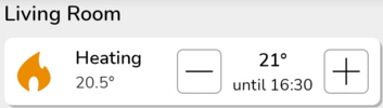

1757942189129.png Not too cold yet, but heating on again, so I wonder what faults this year, specially since the guy who normally services it never turned up this year.
Last year has a stuck micro switch in the motorised valve, got new switch, but never got around to changing it. A few taps of the valve head on the cupboard floor freed it off, and not problems for the rest of the winter.
I expect I will need a load of AA batteries, for the TRV heads, the eQ-3 easy to change, but others need a screwdriver. So how important is the service? He will normally do all his clients in the same area in the same week, and even if not in on the day, get an invoice through the letter box. There is a sticker on the oil boiler with name of installer, but seeing what it was like when I moved in, don't really want to use them.
I switch CH on when the condensation in the windows cause the first black mold spots in a certain ceiling corner.
