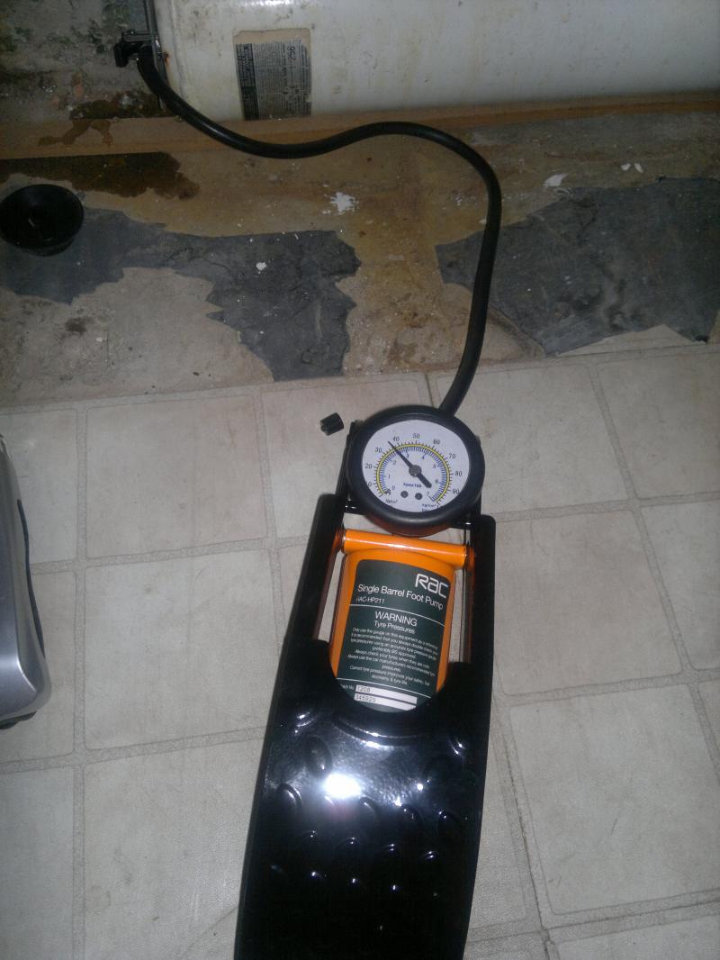

Never got a chance yeterday but the wife is out the way now and I've started pumping this up and just wanted to make sure this is standard procedure what I'm doing and observing.
I've turned off the mains water supply and opened a tap in the kitchen. I stuck the end of a match in the valve to open it and water come out right away so connected the foot pump. As I was pumping up water was flowing out the tap until a point where it stopped about 2 bar. I've continued pumping to about 2.5 bar.
Some of you said it would be hard to get to 3.5 bar but seems to be no bother with this foot pump. Should I give it the whole pressure or see how it goes with 2.5 bar?
EDIT--If water is coming out the valve then it's a burst diaphragm and any air pumped in will just find it's way out the system right? So needs a new vessel that is rated for potable water?

I've turned off the mains water supply and opened a tap in the kitchen. I stuck the end of a match in the valve to open it and water come out right away?
Then surely the diaphragm is burst time for a new one . I got a new one off E Bay - that`s OK because the heater I was connecting up was under 15. litres - it was in my own house and I think I`m competent ;)

No,you should be replacing the vessel as that on is likely goosed
How much water was coming out the Schrader valve?
You are also not charging it correctly

Basically just leaking out, once charged I tried the valve again and it was more of an aspiration rather than a jet of water.
What is the correct procedure?

Is it not the case that moisture can appear in the diaphragm side through condensation etc and that is all that is being expelled?
Sourced from a heating engineer, "Some people will tell you your diphragm is bust but it's just condensation that's been drawn in on the air side over the years due to continued heating and cooling. I've seen some guys say you need a new vessel then just pump up the vessel and put the same one back on knowing fine well there is no burst diaphragm"

Then it is likely to be ok mate
I usually keep the valve depressed until the fluid stops ( or doesn't) that's why I asked how much
But yours does sound as though its ok

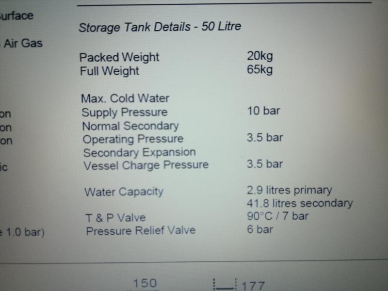

You need to take it up to 3.5 bar
