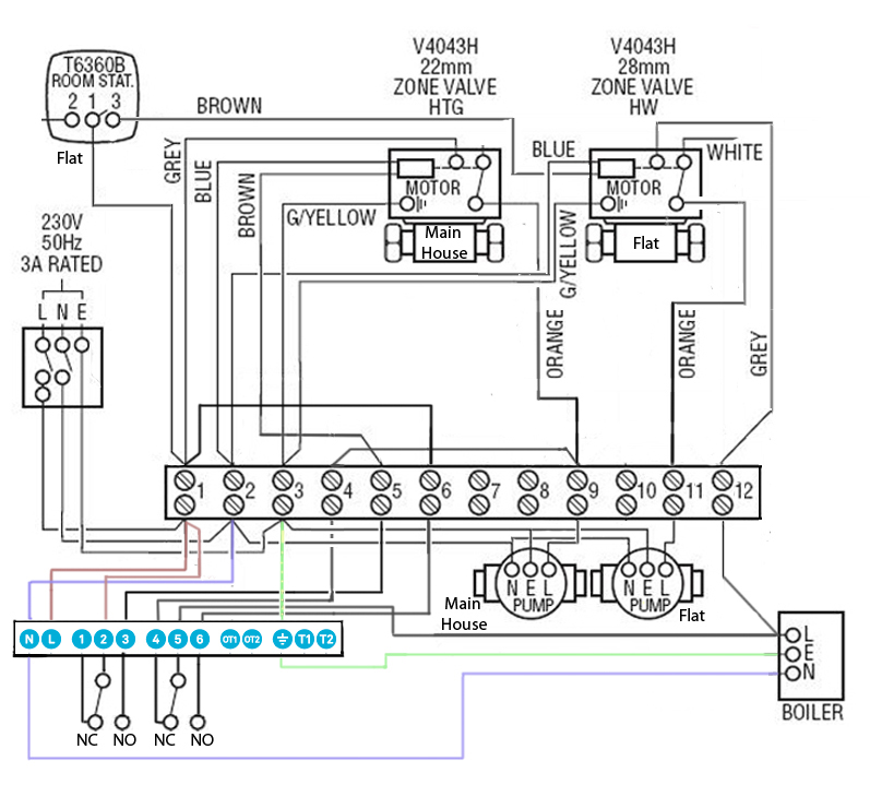

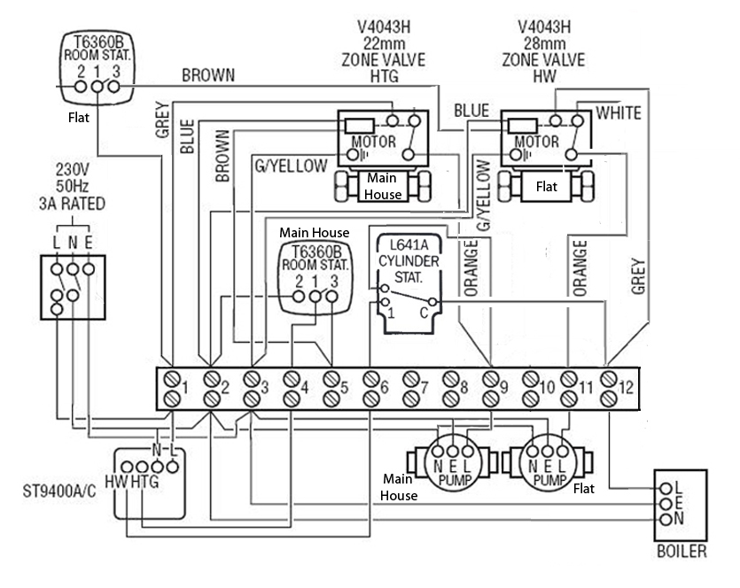

I have worked out the above for my central heating, pump and valve for main house plus pump and valve for flat, and the domestic hot water is thermo-syphon.
Idea is domestic hot water will run boiler but not any pumps, and once the cistern is satisfied then the boiler will turn off, unless there is also a demand from main house thermostat, in which case boiler and pump will run, domestic hot water will clearly still be heated, but this is not a problem.
The flat heating will only work if the boiler is already running, however since the flat is smaller than main house and more sheltered it is unlikely the flat will need heat when the house does not, so that should not be a problem.
The original system had no valves and not any thermostat for main house, the plumber is fitting valves, after doing tests which showed central heating was thermo-syphoning and or having water forced around it in reverse direction, so it needs valves so I can heat water without heating house. I don't want a pump running if the valve is closed, so micro switch in valve works pump.
I think it's OK as shown, but I am not perfect so can anyone see any errors?
Had to rethink to use existing cables between main house and flat, and between flat wall and cupboard at side of boiler where pumps and motorised valves are to be housed. So 4 wiring points new Nest 12 volt thermostat goes to old programmer location and a simple block connector connects cable from thermostat to cable to flat, the old FCU will become redundant and programmer replaced with a JB.
Then on flat wall old supply wire one to boiler becomes supply wires to new thermostat, and the second supply which powered the wireless thermostat receiver will now power whole boiler. So Honeywell wiring centre, heat link and flat thermostat all together on the wall.
Again old cables reused to old wiring centre to power the motorised valves and pumps in a cupboard at side of boiler.
Final plan completed today, tomorrow will start to wire up.
The block with the solid blue terminals - is that the Nest unit ? With the two switches representative of it's relay outputs ?
Assuming yes, then it all looks OK now I'm able to follow it on a larger screen.
Yes the blue terminals are the Nest, still waiting for plumber to fit valves, but with bridge 5 to 6 is does seem to work, but without motorised valves upper floor radiators get warm when set to DHW only.

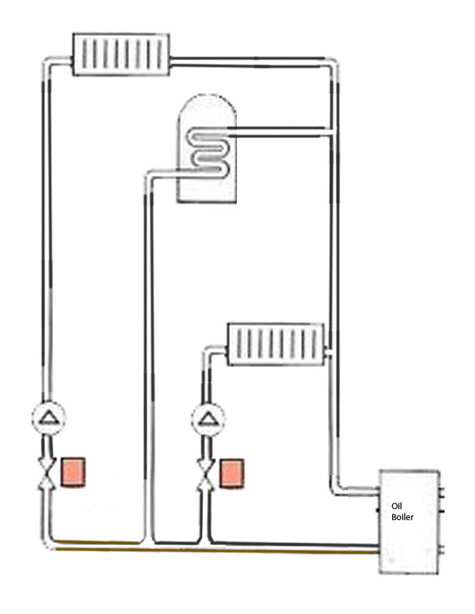

View attachment 166181 This is the basic intended plumbing, there will be header tank etc. But this is the basic way it is to be plumbed up.
Do the arrows on the pumps actually indicate direction of flow ? If so, t is circulating in the wrong direction. Are all of the pipes existing? Your post talks of both future and present tense
Arrows are wrong direction, sorry missed that, all pipe work existing just adding motorised valves with each pump as pump when not running allows back flow and thermo syphon. And without motorised valve it would need a relay.
Some where from the cistern we have expansion and fill pipework, the problem is not sure exactly where this pipe work connects, the plumber advises that to add a motorised valve to domestic hot water we could in error interrupt the expansion and fill, and also there is no run on with boiler which with thermo syphon it does not need, so safer to retain DHW with no motorised valve, have considered a thermostat on the tank, but it would only do anything in summer, and now I can have ½ hour a day domestic water heating instead of original 3 hours minimum time, not sure worth the effort in wiring up tank thermostat?
... just adding motorised valves with each pump as pump when not running allows back flow and thermo syphon.

Well I seem to have a further problem, got home last night, put hand on radiator and warm, put hand on input to cistern nearly burnt myself, went into flat where boiler is and it was running, turned off on isolator, then on and restarted so off to check this morning, dropped tail to boiler clearly don't want it running in this weather, powered up and tested and no supply to boiler reconnected boiler all seems A1 again.
