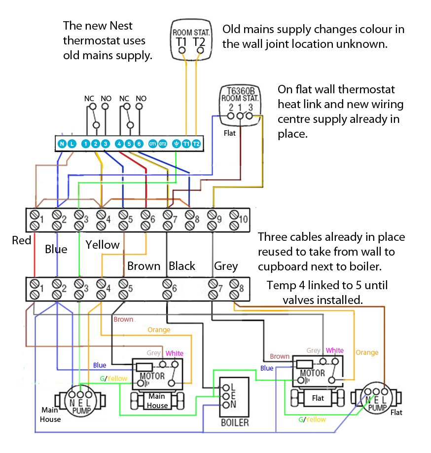

Well latter today the plumber is due to arrive to complete the work, the gap has been good as been able to iron out some problems. If using two pumps this

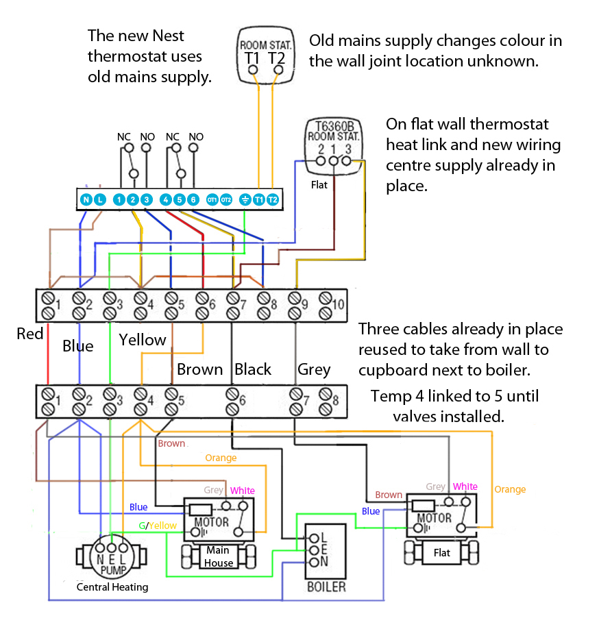

diagram was to be used, however with a single pump this
this actually works better giving full central heating control in the flat.
