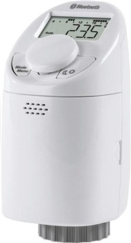

The problem is the cost of control can cost more than it will save, so it is a compromise, Drayton Wiser is likely the best, but can cost £1000 in total so I used cheap TRV heads EQ-3 Bluetooth Smart Radiator Thermostat.jpg they cost me £15 each with bluetooth, but that was before Brexit, seems price have gone up.
