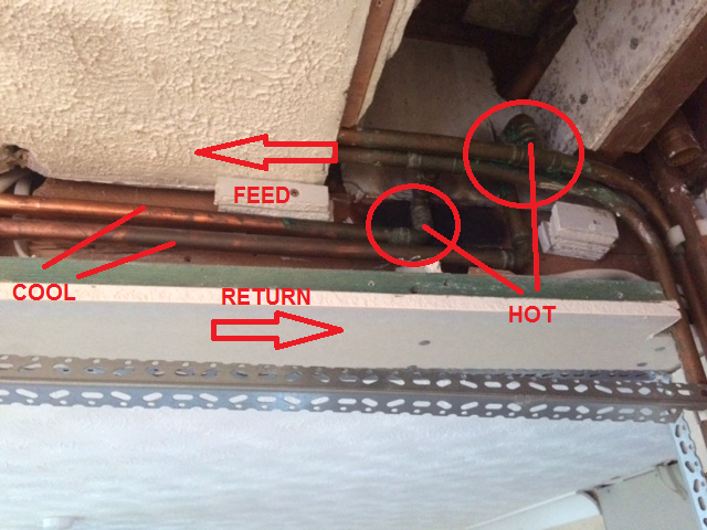

In the pic below I have circled two sections which I believe is what they fitted.
The two areas circled in RED were hot to the touch, but within a foot further along to the left were cold.

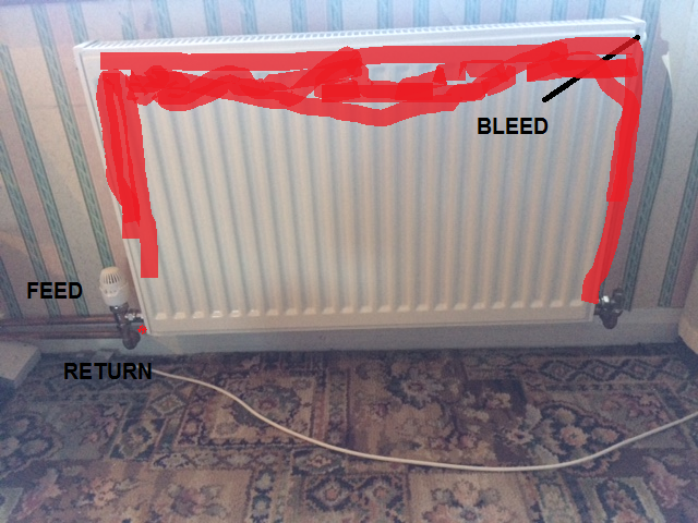

Bleeding the radiator out of the tiny bleed hole for about 20 minutes, pulled the hot water through the feed pipe and eventually the downstairs rad started to heat up, around the edges, but an hour later, no additional heat, and the water coming from the bleed hole was hot.
Nothing ever seemed to go back to the return as this pip remained cold.
Closing the bleed hole on the rad, caused it to cool down again, and eventually the feed pipe in the ceiling cooled also.
In summary:
1. The feed and return in the ceiling both start to cool after the angled sections (I have determined which is feed/return purely from how the pipe heated up when bleeding)

5. Pic below shows area on rad which heats up when bleeding

1. Why are both the feed and return hot at the the angled join in the ceiling, and then cool down after the join?
2. When I open the bleed on the rad, the feed pipe gets hot as the water has an escape through the air release hole. When I close the bleed valve, the hot water stops. So the water is unable to return through the return pipe - couls this be a faulty blocked TRV, a blockage (physical or air in the rad). How can I test this?

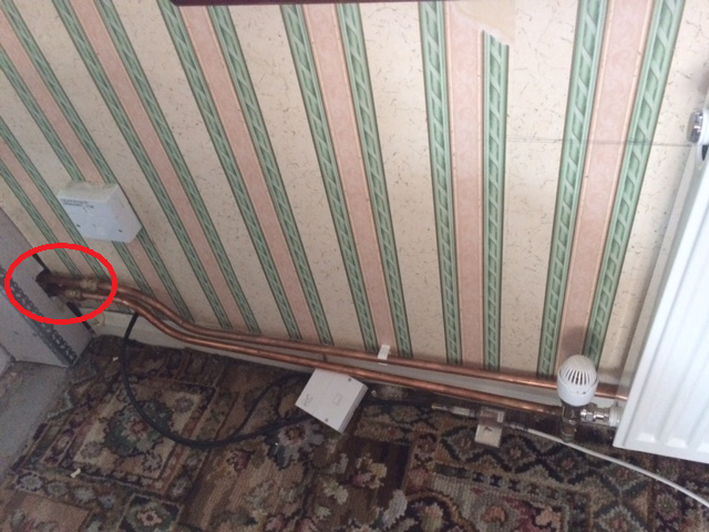

Circled in the pic below, are the two pipe ends I was left with by the previous plumbers, not knowing which was the flow and which was the return I have ended up plumbing the longer one (which I now believe is the feed), in to the lockshield valve, and the shorter one (which I now believe is the return), into the TRV.
I believe they are both bi-directional so this should not be a problem?!?
I have loosened the nut at the bottom of the TRV and it leaks, so water is either passing through it, or going in to it.
Q. Once the system was drained down, both feed and return were empty. As there is now water on the underside of the TRV, can this only happen by water passing through it from the rad, or does the feed naturally also fill with water when the system is re-filled?

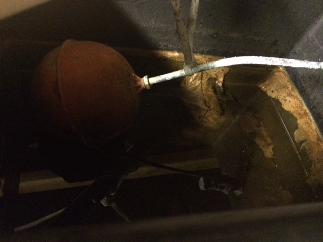

FYI, just looked in the header tank and there is some mossy/sludge sitting on the bottom inch or two of the tank, could this be contributing to anything?
Could do with a clean out , crud in your pipework will never do any good ,and will cause problems. Fit a bung into the outlet at the bottom of the tank to prevent any crud going down into pipework and clean the tank. Make sure you use long rubber gloves to protect hands and arms. Dont forget to isolate the incoming water supply first ,and when your done make sure you take the bung out !!
Is there something tied to the float arm of the ballcock ???
I've drained the system so I can fit a couple of ball valves to the feed and return - thats some cord to close the ballcock so the header tank doesn't fill.

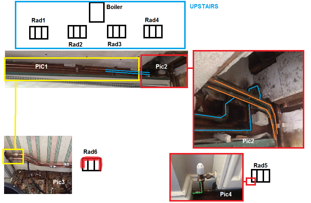

I've added a drawing below to clarify the issues:
Pic1 - This is part of what I believe is new pipework going up and over the old kitchen doorway, then back down to where it terminates in Pic3
Pic2 - a bit difficult to explain this section, but I'll try. The orange marked pipes I think have always been there - these are very hot to the touch. The blue marked pipes I think have been added (sames pipes as in Pic1), as there are char marks on the wood around these extensions - these blue marked pipes feel hot at the point where they are connected to the orange marked pipes, by then cool rapidly the further along the pipe you go.
When I bleed the new Rad6 of water, the top pipe in Pic1 heats up, all the way until there is hot water coming of of the bleed hole of Rad6 - I have highlighted the area of Rad6 which heats up - it never gets REALLY hot (only warm), and the return pipe stays cold (maybe as the all the hot water is coming out of the bleed valve?). When I then close the bleed valve, eventually the radiator and all pipework cools back down.
Pic3 - I then fitted the ball valves and closed Rad6 of completely and turned all the rads upstairs off to try and get Rad5 working again (Pic4) - the green marked pipe barely gets warm to the touch, no other part of the radiator heats up at all (this rad used to take a long time to heat up, but never got REALLY hot).
And that's where I am. I've drained the system a couple more times and re-filled top/bottom, bottom/top. I've also added cleaner to the last fill - no change.
Closing off completely Rad6 to bring the system back to what it was originally doesn't seem to be working either.
Grateful for any further advice?!?
