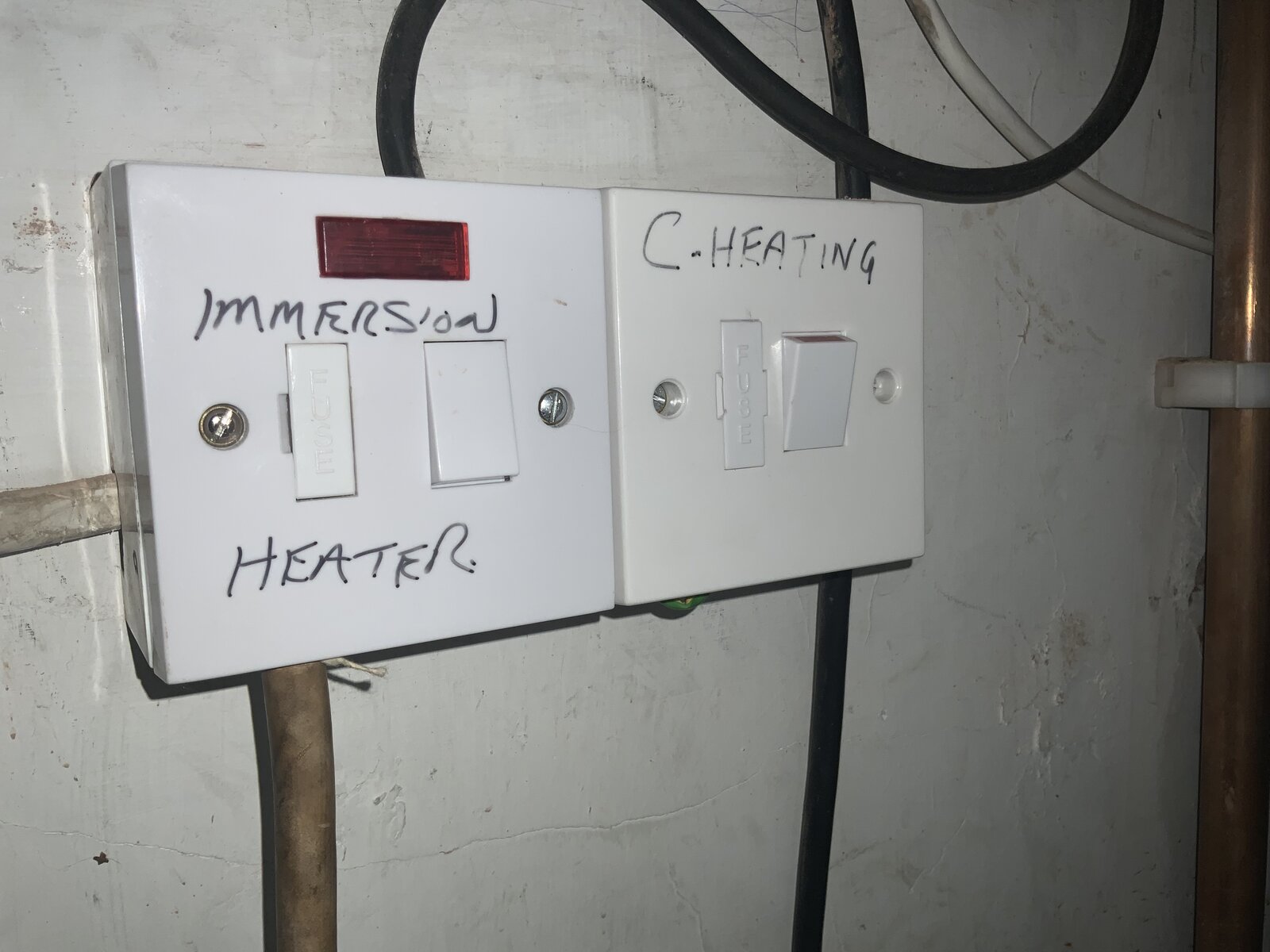

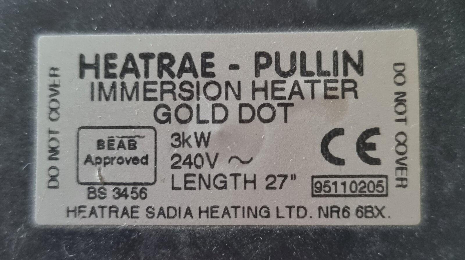

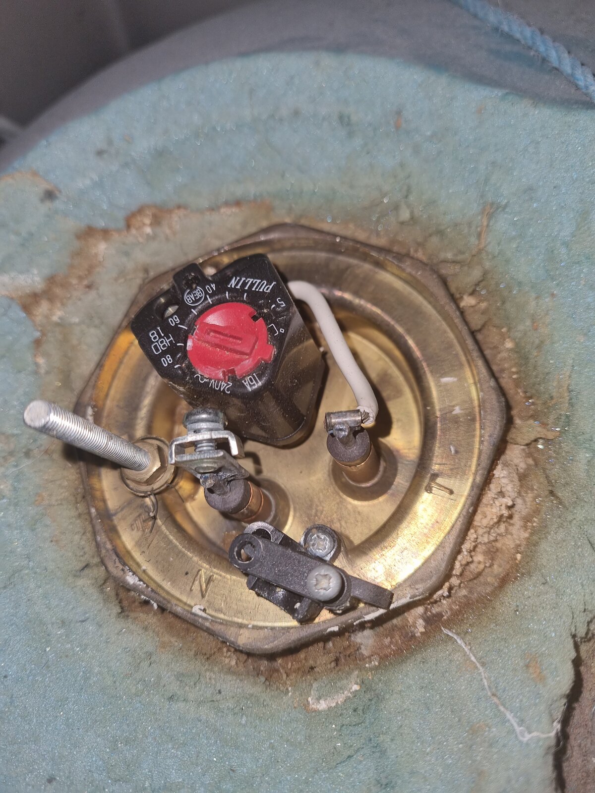

I had a plumber years ago in to fix a leak at the HW cylinder and he ended up replacing the whole thing.
The immersion element was moved to the new cylinder but never wired back in.
I would like get the immersion wired again and on a smart switch which I thought should be a simple DIY job but taking a look at the electrical wiring I can see why the plumber didn't want to touch it...

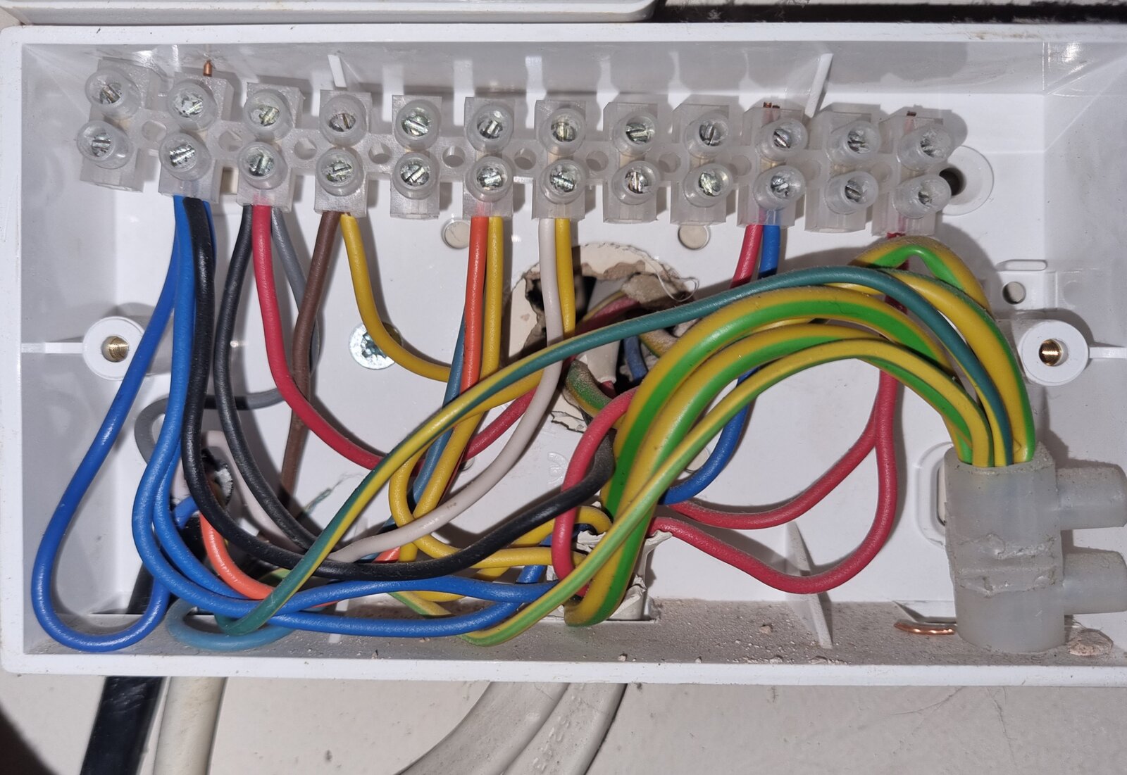

One 3-core bring power down into a fused switch which then enters this junction box from the rear
Two 3-core cables exit the bottom to the junction box and go up to the boiler upstairs (at least one of them does dunno what the other is)
Black cable (grey and orange cores?) goes to the motorized valve which doesn't seem to work)
White cable exits bottom left and goes to the thermostat on the cylinder
Something exits the hole in the back and goes the heating controller/timer mounted above.
So my question(s) is is this the "normal" way to hook all of this up? How would this be done properly? or is it perfectly fine?
should I just get some heat resistant 3-core and "jack" into an earth, live and neutral in this box and take it to immersion element via a smart switch?
No, the immersion needs its own supply from the consumer unit - usually 16A

The "consumer unit" is an old style Wylex wired fuse box with 4 circuits. upstairs and downstairs, ring and lights.
Don't know which the input on this junction box is connected to...
I'm only assuming the immersion used to be off this junction box.

Don't think we ever used the immersion and the wife now thinks that it used to be on a standard 13A UK plug on a long cable that was coiled up on top of the cylinder for "emergency" hot water. Probably the plumber didn't want to put it back as it was not sufficient.

Would I be better just putting a plug/cable back on the immersion as it's only for occasional use?

Do not try to connect your immersion to this wiring centre. It’s not suitable and nor will those cables take the continuous 13A load

The 13 amp socket needs a plug with a fuse, and a fuse works by melting, so they get hot, so running 3 kW for a short time like a kettle OK but for a long time the fuse will make the plug hot, and it needs to be in free air to cool, or in a large lump like a fused connection unit (FCU) to dissipate the heat. The 15 amp plug did not have a fuse.

Just for clarity, what hasn't been mentioned directly yet - your system is "normal".
In a system like yours, the hot water is primarily heated by the boiler, as gas is cheaper than electricity; the immersion element is usually only used as a backup.
This means that the boiler electrics are a separate entity - your 'junction box' is a wiring centre to control and supply the low current zone valves, thermostats and any pump associated with the boiler.
As has been stated above, an immersion heater should ideally have its own circuit, and shouldn't be connected to the wiring centre.
As "own circuit" would effectively mean a rewire (unless it's an easy job to run new cable from the fuse box) I think we will have to weigh up if it is worth it.
