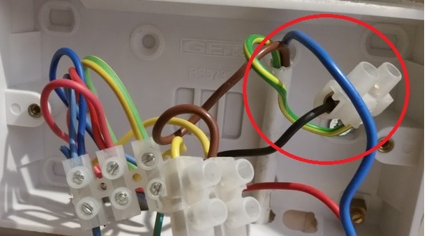

Morning All After bit of advice
We were due a wireless thermostat fitting by a (unnamed company )
due to how my system is they could not wire it in needed a live feed
After they went things were not right after they had poked around . boiler would not fire
My dads a sparky although works on industrial machinery when we opened up we found the grey wire was loose we have now fitted it to the correct connector or so we think . my dads offered to come back and have another look but he works alot and has no time at the minute .
The boiler fires
But symptoms are if the boiler fires for HW all is fine . if CH comes on the valve moves to CH and stays there will not move to mid position or back to HW .
So if the cylinder stat calls the boiler fires but it just heats the radiators due to the three port valve stuck over in CH
If turn the system off three port valve returns to HW
position
Any ideas?
Is that a Green/Yellow being used for something other than Earth
If it is then replace that cable with four core ( or five core ) and use the Green/Yellow for Earth. Do that even if the item at the far end does not need the Earth
The grey should connrect to the "HW OFF". Google for Y Plan diagram
Bernard is right (strictly speaking). Looks like the earth wire is being used for HW Off.
If the cylinder is not in the same space as the junction box - I.e. you can see the full length of the flex in the same room/cupboard - then you should change the flex to 3&e.
The cylinder is right next to me in this pic . So do i need a plumber or a electrician ? to come sort this out ? anyone to recommend Leeds/Wakefield Area ?

At a guess I would say the earth core from cylinder stat is hot water 'off' , remove grey core from terminal block and terminate into block with earth/black , see if it works..
If you can take a photo of the cables entering the box then you will get a confirmed answer........or simply remove programmer and post which colour core terminates @ 'HW OFF'.
Ok i have taken some pics just to make sure but it looks like your Right Black wire is hw off
i just need to change over grey wire to black/earth terminal on block ?
There you go , easy ain't it..:censored:
