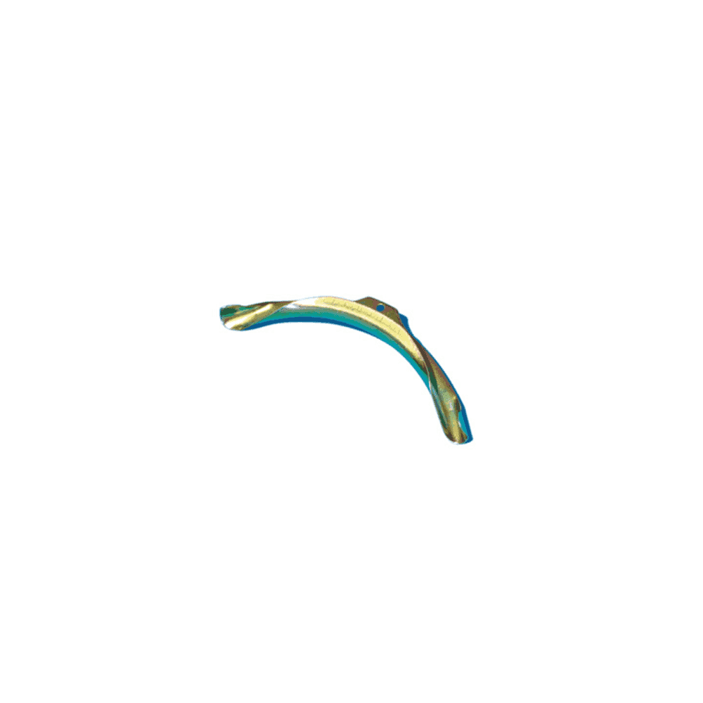

You could use Hep2o in flexible conduit with cold form bends to take the pipe from the screed to vertical in the wall behind the radiator then compression fittings with chrome copper to the radiator valves.

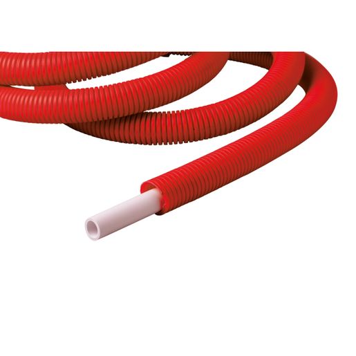

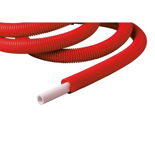

As above use Hep2o Barrier pipe in Hep2o conduit, water regs may require pipes in solid floors (excluding UFH pipe work) should be removable.

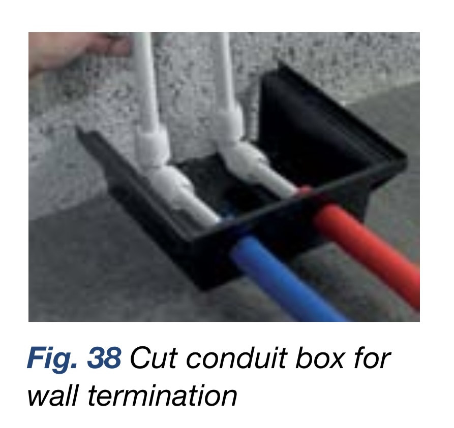

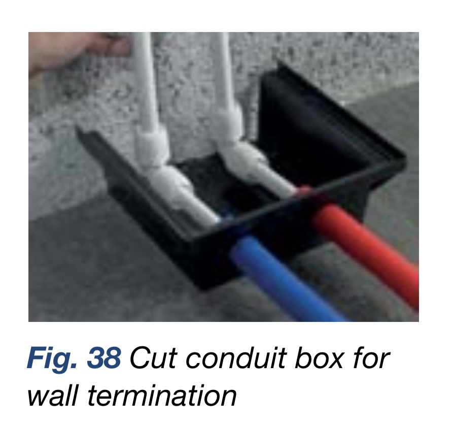

You could use cold form bends to come out of the floor and into the wall or use half of a Hep2o conduit box with a plywood cover with similar at the other end meaning the length of plastic pipe can be disconnected at each end and withdraw from the conduit and a new length slid in should it become damaged etc.
