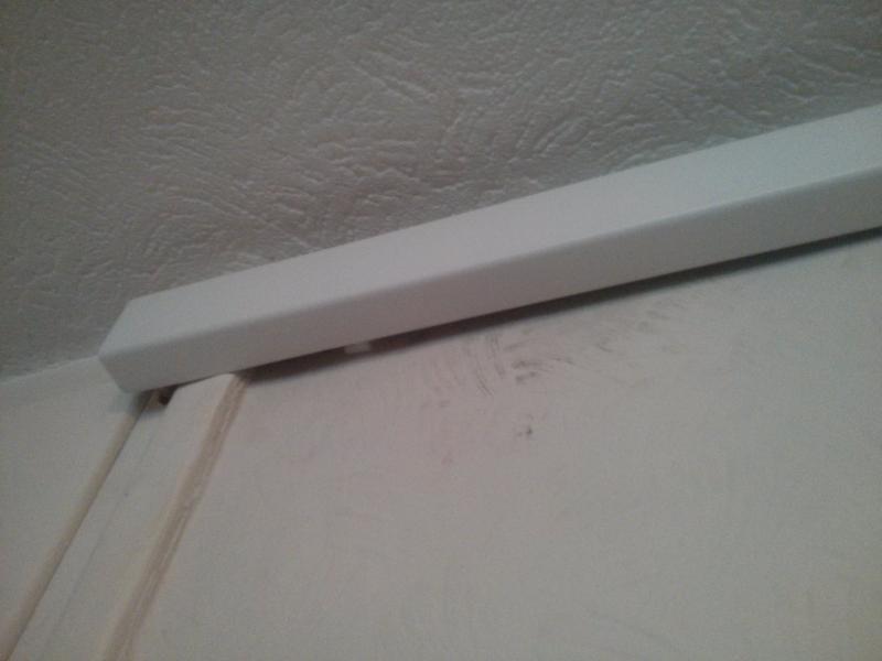

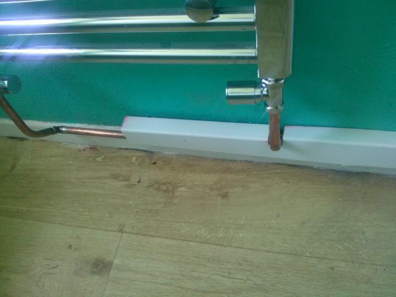

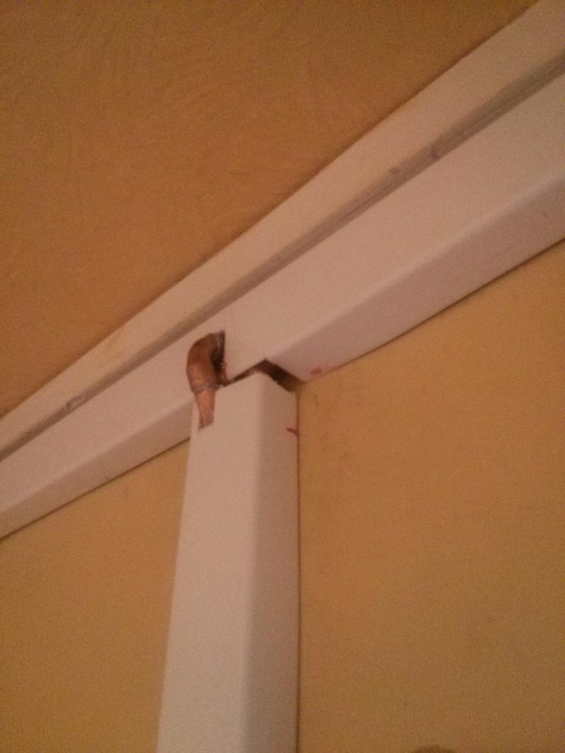

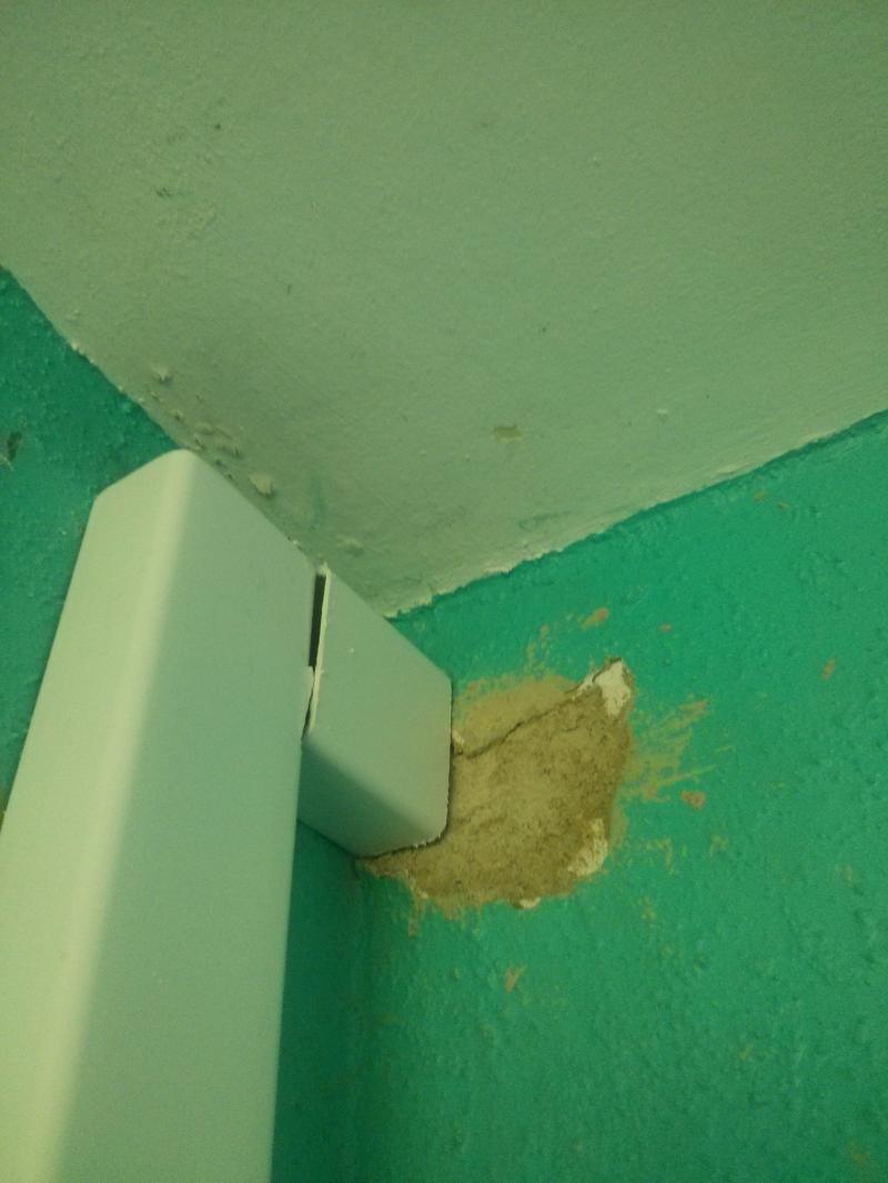

My girlfriend has just had central heating installed. Her flat has hard flooring and ceiling so the initial plan was to chase out pipework through the floor.
The plumber then suggested plastic trunking as cheaper and neater than chasing out. The finished product however is far from neat (See pictures for some highlights).
Does anyone know a) if trunking over pipes can be done well and b) where we stand in terms of getting the work corrected and paying for it?
I guess it comes down to how much she paid and whether he explained it fully before starting the job.

If it was presented as being of a similar quality finish to chasing the pipes out then you may have some come back, but tbh by the standard of the work he looks like a cowboy and your chances of getting it corrected or money back are slim to none.
If she's paid up then she's accepted the work as being to a standard she's happy with. If she hasn't, call the installer back and have him correct the work, it does look pretty awful. It can be done nicely, but it takes time and effort
Talon do a proper range, but it isn't universally stocked and will never be as need as hidden pipe work.
Those pictures look like he started off with the right intention but got bored/over budget /let down by supplier/was working beyond his skill set.

I can see that you might be able to get some straight pipes inside some trunking but anyone with a bit of knowledge should know that it would be difficult to hide bends inside it. The trunking should at least be right in the corner of the wall so that it can be painted and appear less obvious.
Maybe as an alternative 'boxing in' could be used, particularly behind the rad where the boxing could extend to the whole width of the wall.

The boiler, pipework and radiators have been installed well. The issue is with the blatantly poor finish to the trunking, which could clearly have been done better. I agree with Dan_Robinson in that it looks like he was working beyond his skillset and possibly ran out of time/materials.
I have already said that I don't like trunking but the problem with this is that has just been done so badly. He could have at least used proper couplings. It seems as though he is not particularly good with a junior hacksaw or measurements.
