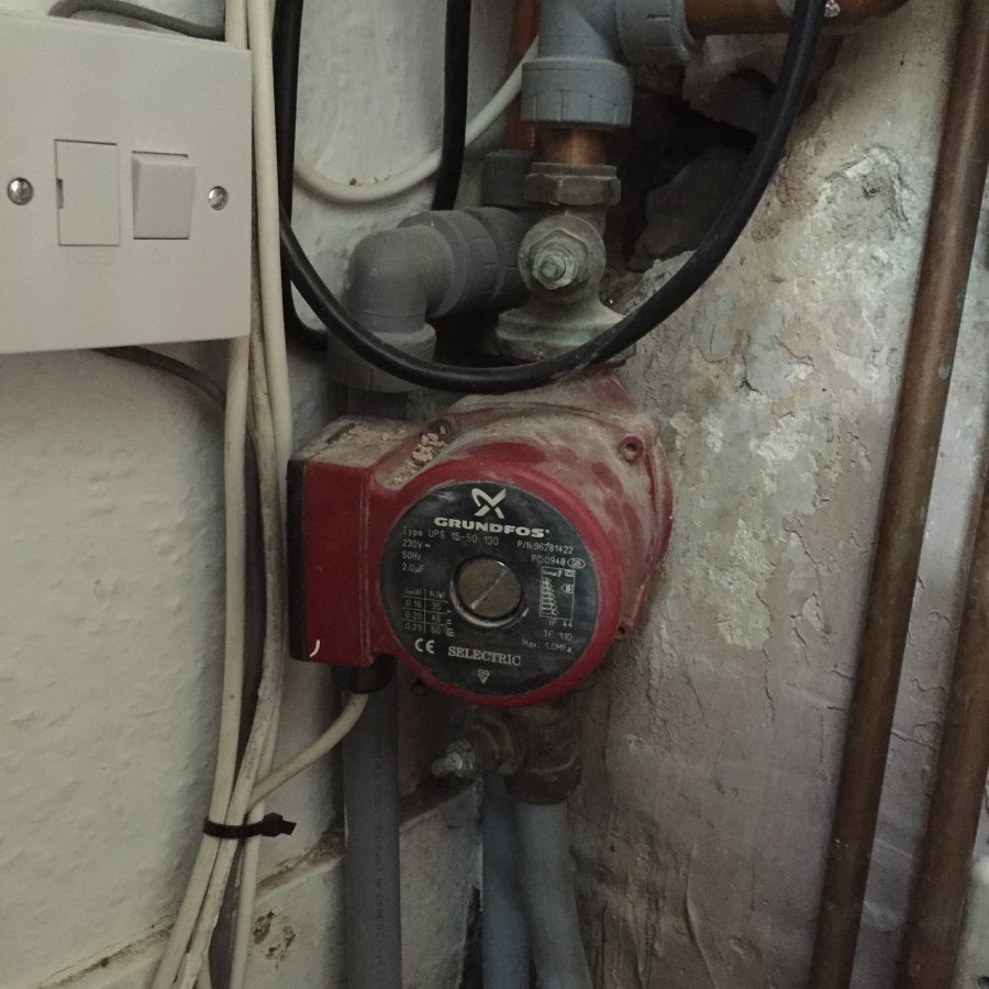

There is probably no need to "fix it" as, from a heating point of view, it doesn't matter which way the water travels round the system. What is important is that the pump sends the water through the boiler in the correct direction. If the pump is built in to the boiler it will be correct; but if an external pump it will normally be on the flow side, pumping away from the boiler (arrow on side of pump). It can be on the return side (rare), in which case the arrow should point to the boiler.

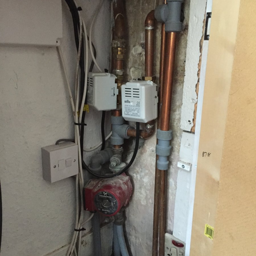

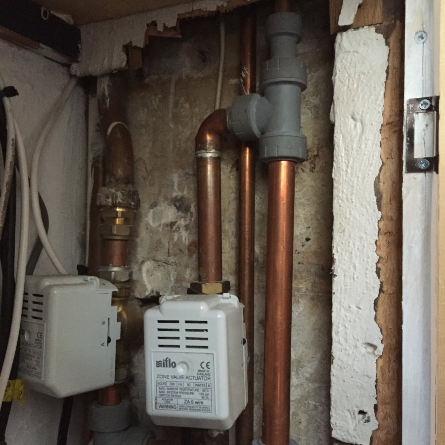

Hi - i dont believe the boiler has a pump in it as if it does then we have two!
These are some pics of the pump and the valves - the valve on the right is for the rads and the one on the left is for the HW - I have no clue how i would work out which side of the boiler from a flow point of view this is, any clues as to how i could check?
cheers

I would contact the people who installed it and simply ask the question. That's not the best example of the heating engineers craft that I've ever seen.
