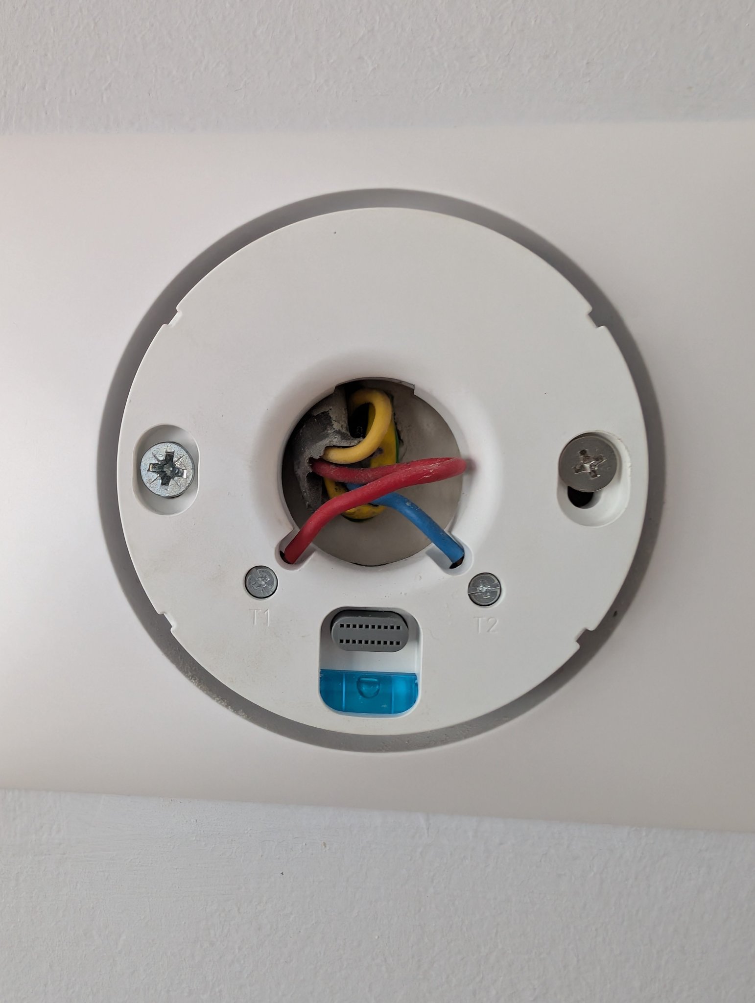

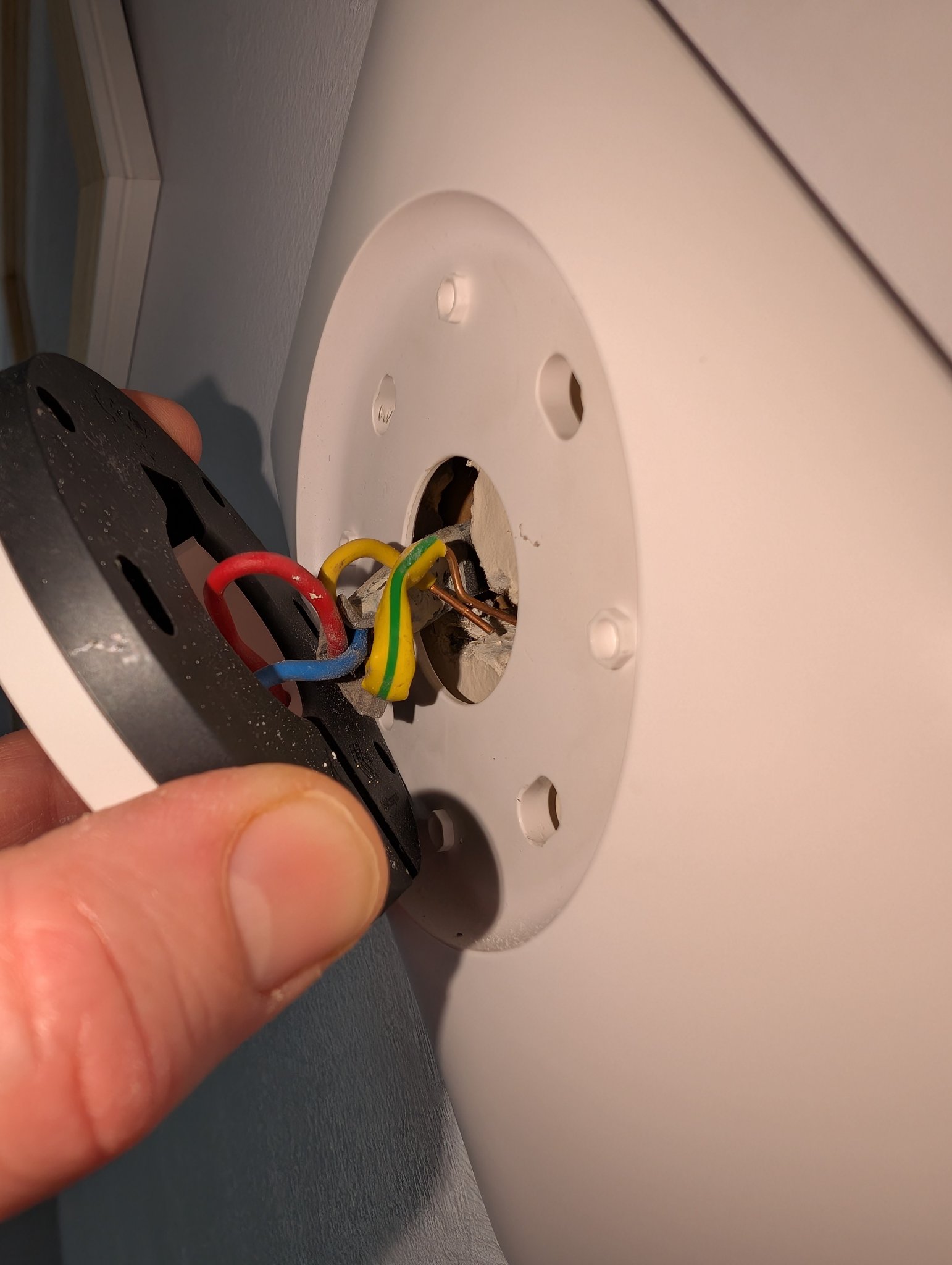

Hello,
I'm soon going to be redecorating the front room, so so went to remove a fascia plate from our Google Nest thermostat and noticed something odd with the cabling. This was installed by an electrician about 3 years ago
The red and blue cables are terminated into T1 and T2, but the yellow and the earth are just folded back and placed within the wall (the ends are not terminated or taped in anyway).
Does this seem ok? I'm wondering whether the earth and yellow were required in the previous thermostat but are not required for the Google nest thermostat, so have just been left loose in the wall. It just doesn't sit right with me that the ends are just exposed.
Thank you
Does this seem ok?
No, as you say terminate them safely so that they cannot touch anything or each other.
It's not right. It doesn't matter why.
