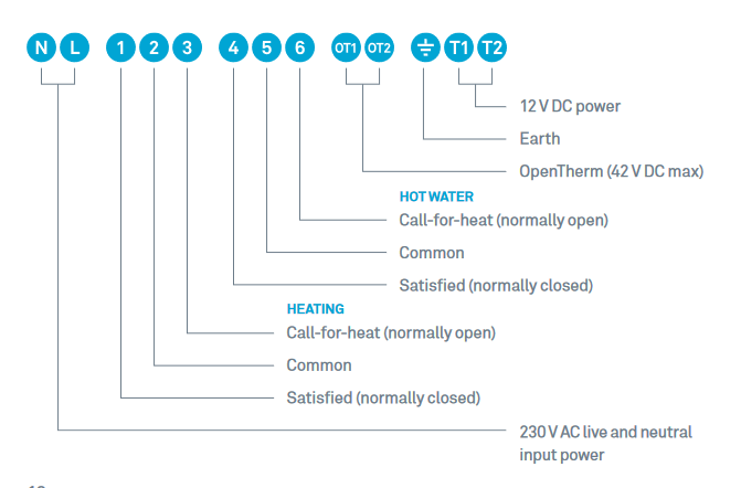

Nest I know, Vaillant I don't. So I am assuming Nest Gen 3 not Nest e? With Nest Gen 3 it has two methods to control boiler, one is volt free contacts, the other is OpenTherm, so to start with which method are you using?
The advantage of volt free is does not matter if boiler uses 230 volt (low voltage) or 24 volt (extra low voltage) it will still work. And since you have access to the com terminal it can work even with a C Plan.
The centre button on the heat link will work even if the thermostat is not connected, so start by pressing centre button, that is what my maintenance guy does to run it when servicing it.

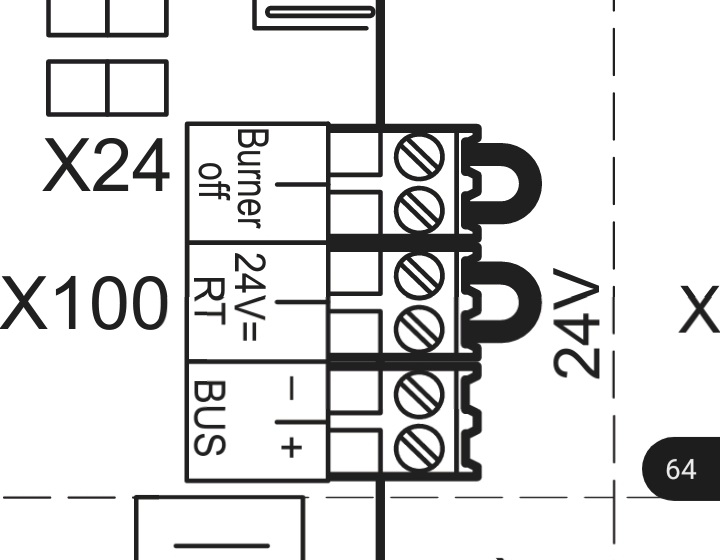

This 1723980298776.png may help others, full guide here. but I have no idea what RT is? I have found one manual which says
Do not connect any mains voltage to the eBUS (+/-) and RT 24 V terminals.
so it seems likely

Assuming yours follows the standard Vaillant wiring methodology, the 230V RT terminal is the correct one to use.

Vaillant also use the RT symbol on the 230V return...

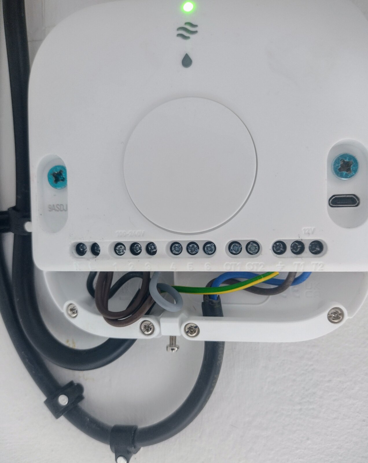

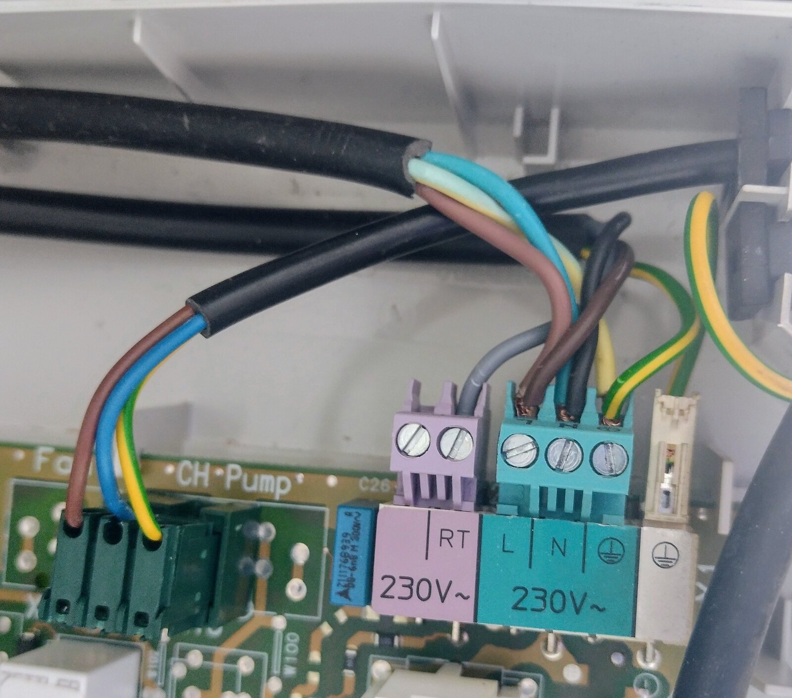

I've attached images of the wiring so far
The boiler is a Vaillant ecotec pro 28
Looks correct to me.
If you connect the grey wire in terminal 3 directly to the brown in terminal 2 (after safely isolating power, etc.), does the boiler fire?

Yes,
That is what the relay in the heat link does anyway - it simply connects those two terminals together, when there is a call for heat.
