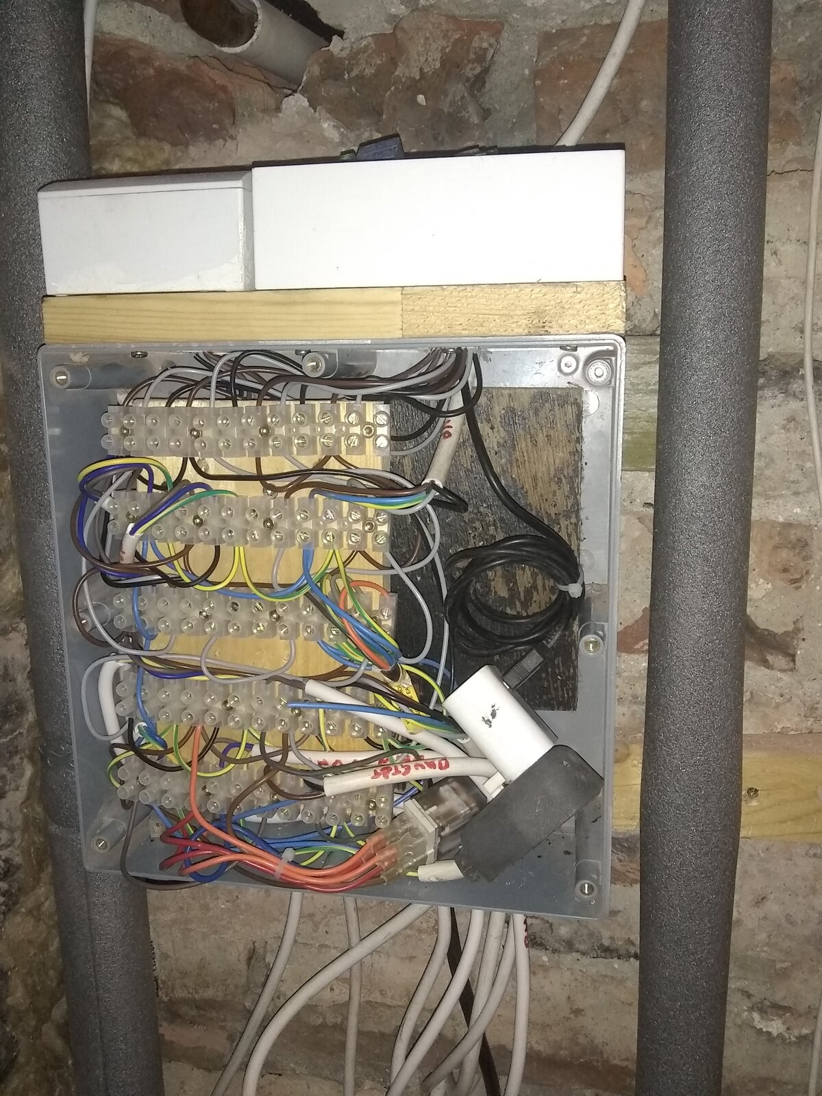

Brill will give it a go. Presumably find a decent box for all wires and about 15 wire holes. Just mount relay on a din rail?
You can go DIN rail if you want, or get an 8 pin or 11 pin base and screw it to the back of the box or you can be shoddy like me and just tuck it in a corner somewhere...see pic :) 16028333060202864180637332408274.jpg
EDIT. That's a plastic box about 250mm x 250mm x 100mm deep. Terminal blocks are mounted on a backboard to make it easier to wire in to. I've done it the telecom way- cabling from thermostats, pumps, timeclocks etc comes into the blocks and link wires go between the blocks. There's a lot to be said for having an earth block and a neutral block for all the common stuff but there we go, its in, it works :)

1x 240v 2 pole NO relay will do it.
Your normal zones connect direct to the main circ pump as now (via the internal microswitches).
The UFH zone valve switch fires the coil on your 2 pole NO relay.
Pole 1 has live to the circulating pump (effectively in parallel with the heating zone microswitches).
Pole 2 has live to the UFH pump.
Easy life. The attached link will work, there are plenty of others https://www.amazon.co.uk/sourcing-m...ocphy=1006669&hvtargid=pla-357842209603&psc=1
All wired in and seems to work a treat. My box is like spaghetti junction inside but will tidy up later. Thanks for help.
