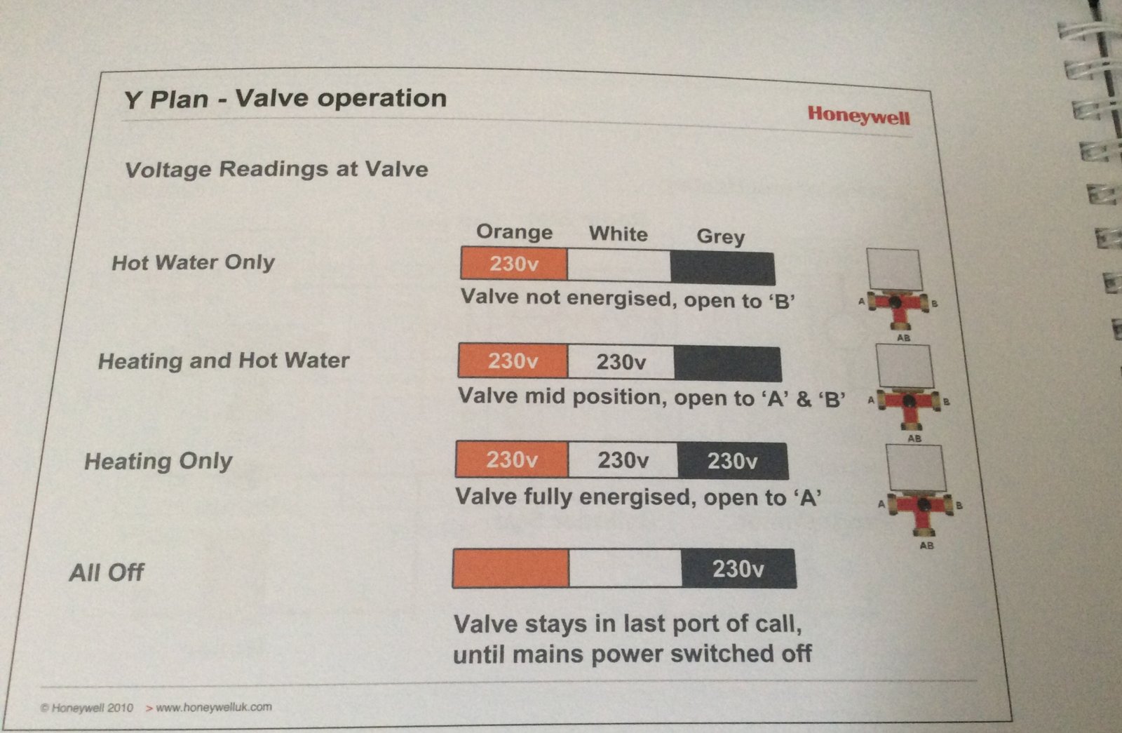

Hi all, thank you all for your help and suggestions but after about 6 weeks of trying I give up FOR NOW, I have tried three 3 port valves been in touch with the manufactures of the thermostat & programmer made adjustments moved the wiring more times than I can remember. I have hot water that's fine I can get heating if I push the leaver in the 3 port valve over, but that means that the water has to be on also. I am now sick and tired of spending my life with top half of my body in the cupboard.

if you can get HW on its own and heating and HW but not CH on its own you have a HW off fault is the HW off wired into your programmer ?

Hi ianmcd, I was thinking that but not sure if I can test the valves without fitting them.
you could wire them up without fitting them and see where the valve moves to , but better to test the wiring of the valve already fitted with a multi meter to see what voltages you are getting, @The Novice posted an expected voltage very simple guide in another post I have tagged him so hopefully he will be kind enough to post it again on here for you

Hi ianmcd, The Novice and all, it's sorted at last, a bit of help from Tower and an old thermostat everything is now working. Thanks to all and hopefully I will not be back for a while and I'm now out of the cupboard for a while.
