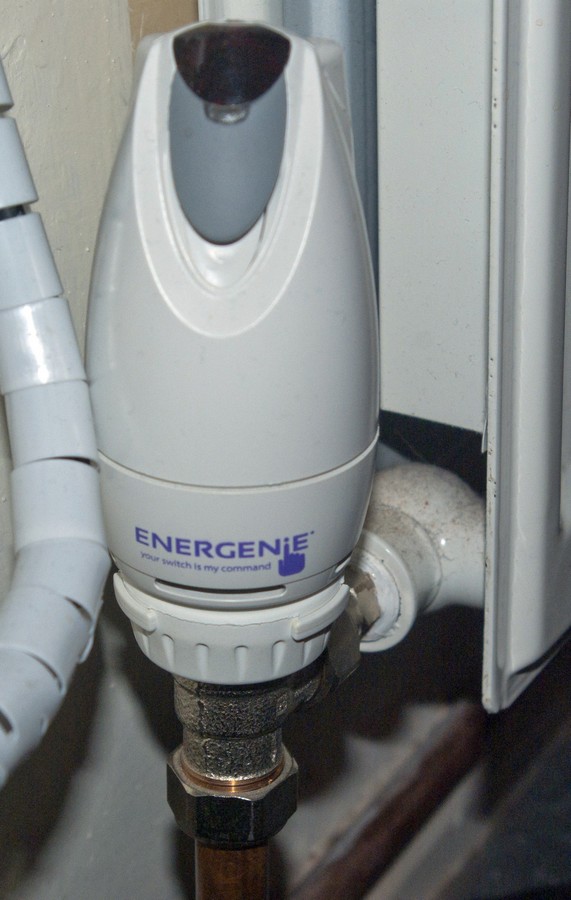

have the option for geofencing, as does my wall thermostat (unfortunately they don't talk to each other) but as will many central heating devices some are better than others, Drayton wiser TRV works out time to heat the room, so you set time you want it warm by, and it works out when to switch on, my cheap Energenie MiHome TRV's have OTT anti hysteresis so the geofencing does not really work, and my Nest Gen 3 does not allow the distance to be set, only the Eco and Comfort temperatures.
