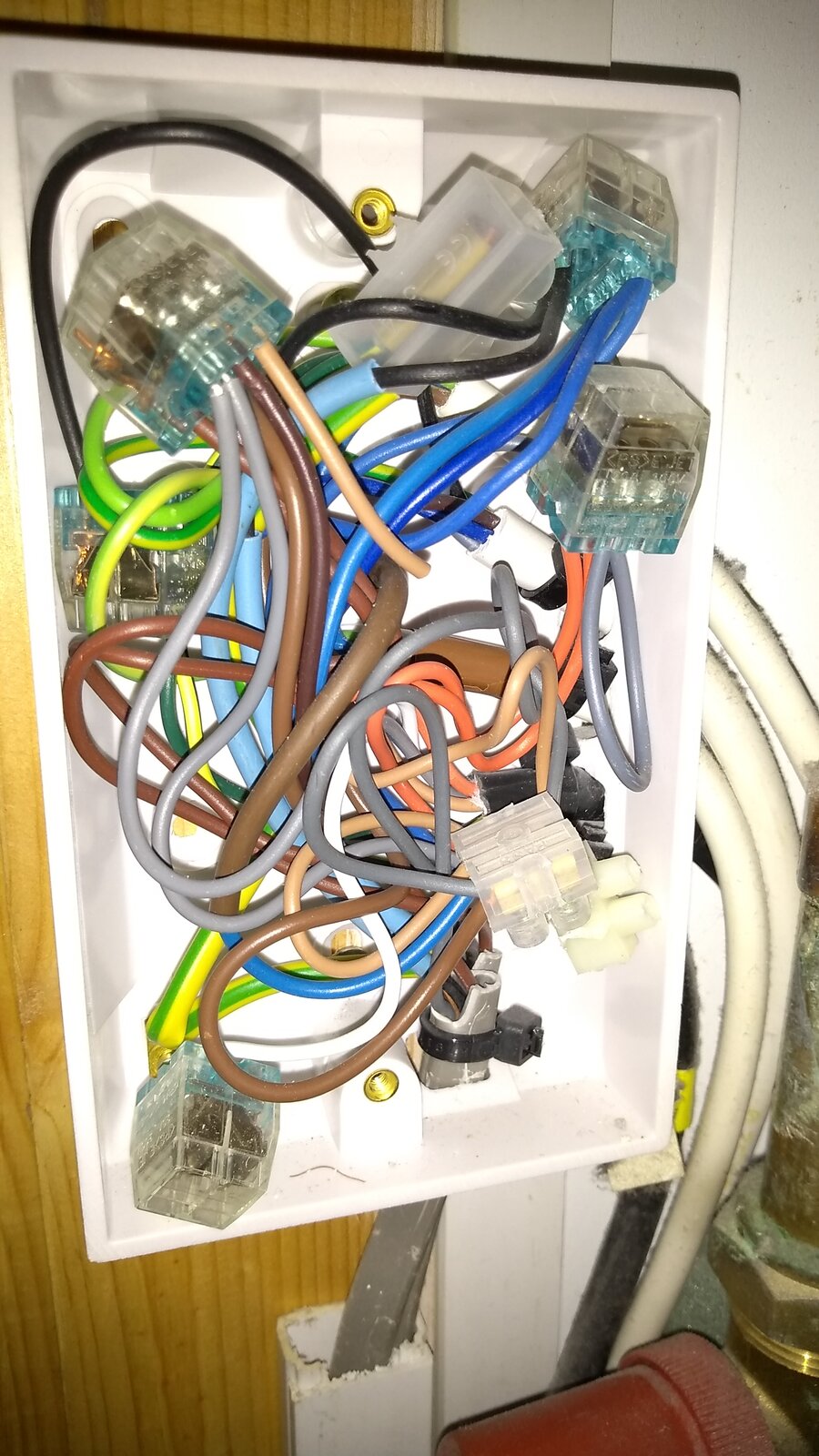

Measure the voltage at the wiring centre...you won't have access inside the zone valve. Brown and blue wires feeds the motor.
OH great --------- thanks for that.:unsure::D

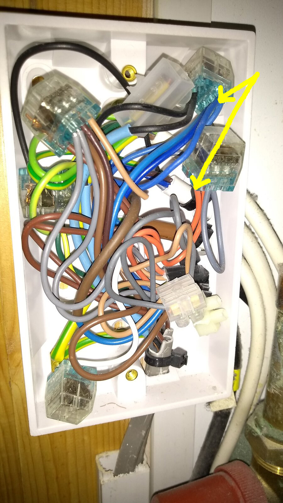

So do I stick my meter probes in these two blocks Sorry wrong picture.
Ones blue, does the other look orange? It looks like grey to me, with some browns in there. I believe polesapart said, neutral (generally blue) to orange (switched output).
Edit: I’m not 100% you can test the wago, I could be wrong.
Yes :D, and test both, as you probably won’t know which is which
Dont joke with me, because im not sure now. Are you saying I put the probes one in the orange and one in the blue, and should get 240. Or are you saying both probes in the blue - should be 240 then both probes in the orange - should be 240.
I’m not joking. Create a demand (heating on) one probe in blue, one probe in orange, if you get 0 volts, then keep the probe in blue and test other orange, if you get less than 240vac on the heating then you have found your issue.
Ohhhhh I get you now. Yes there are two orange one from each valve.
