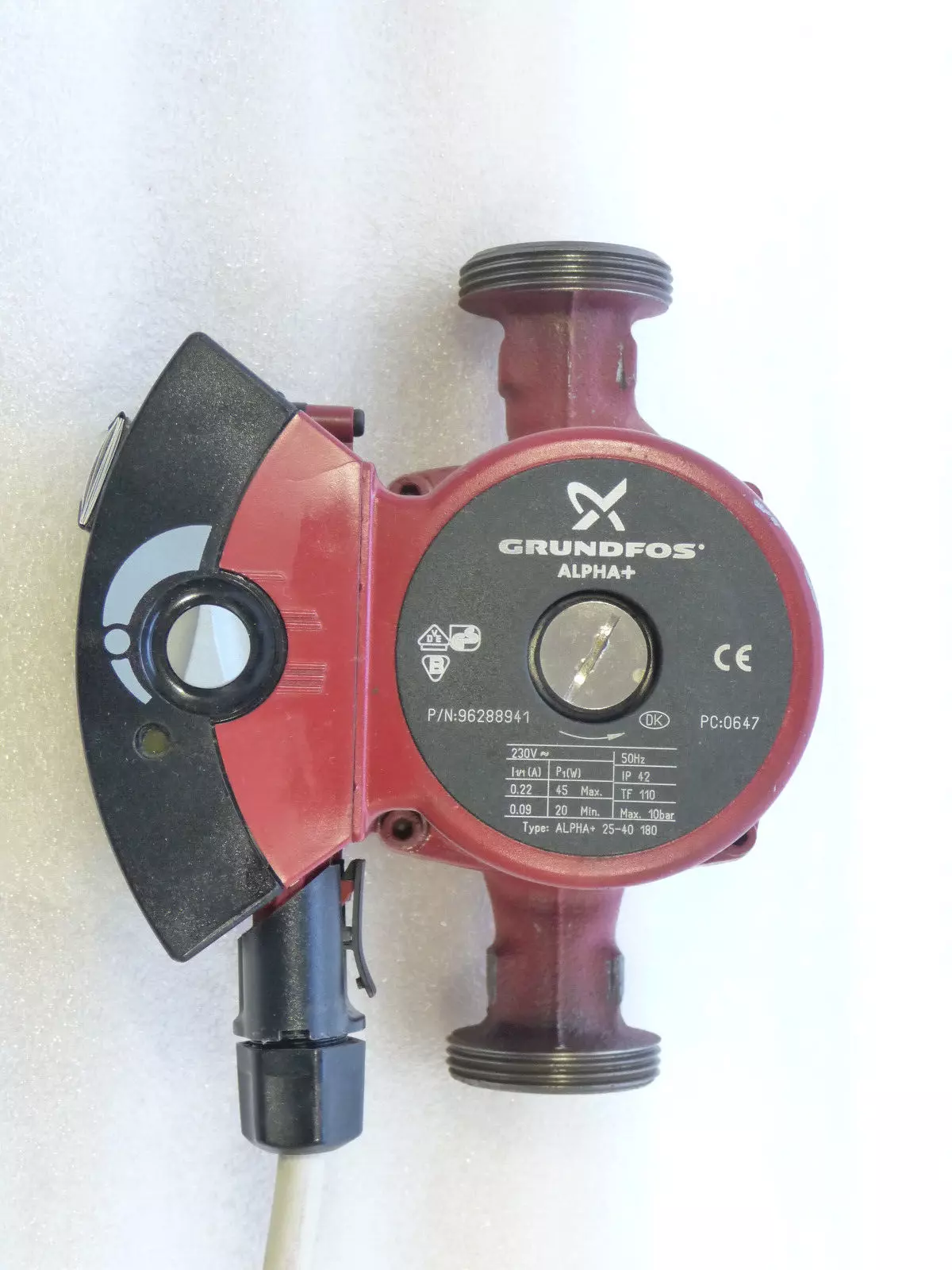

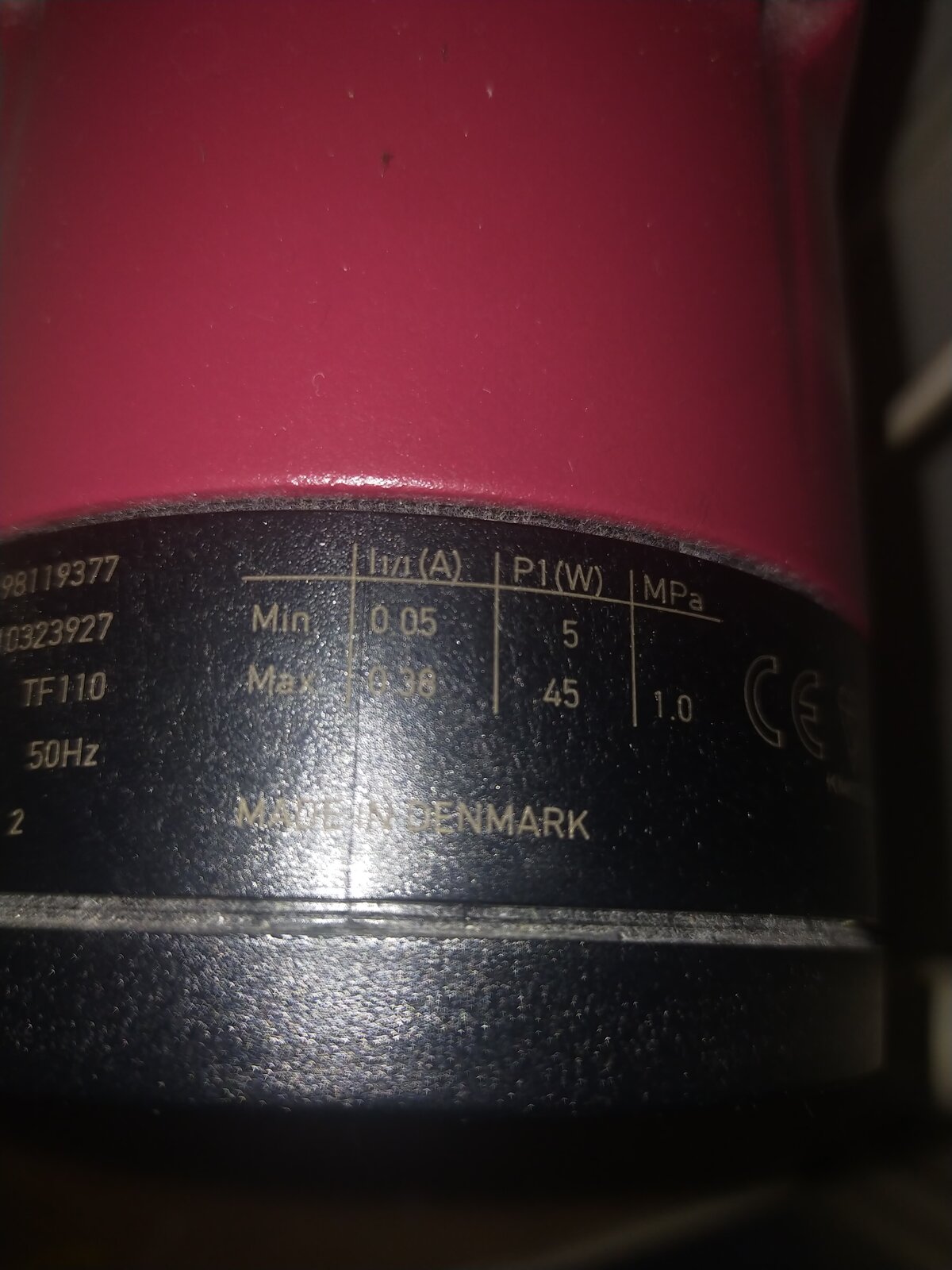

How old is the Alpha, if fairly modern it will display the power, watts, as W or/and some display the flowrate in m3/hr, so check for this and whether they are displayed or not, post a photo of the LEDs (running!!) and also check for the pump model like below, it will/should be either 45W or 35W.

You said you pump is the Alpha + so probably a fairly old pump with no LED display etc, if its set to either II or III on the fixed speed mode then should be plenty of pump head to circulate the water. You could shut the pump isolating valves (but only if they are the gate type), remove the pump head and clean out the impeller vanes with a tie wrap and back flush the pump inlet and outlet ports, there should be a venting screw on the front of the pump, you can remove this to see if the pump shaft is rotating, just hold a cloth under it while checking it, you won't get much leakage.
Is this your pump? the pump shown was made in week 47 year 2006, PC:0647.

Yes, I suppose, no harm in spending a few quid now after 20 years or so, would suggest a DAB Evosta 3 (not the Evosta 2) or, like my own, a 6M Wilo Yodos Pico, both of which display the power in watts and the flowrate in m3/hr, very useful.
What setting is your present pump on.
Traditionally it's been at the mid point - in other words the narrow point of the grey pointer on your picture above has been pointing left (west) and in that position the heating has seemed perfectly adequate.
I have though in these last weeks turned it clockwise to the point the one in your picure is - I assume thats maximum.
Yes, try it on that, I is the lowest speed/head, if Rads not heating up fully, try it on II, if nothing changes install a new pump.
