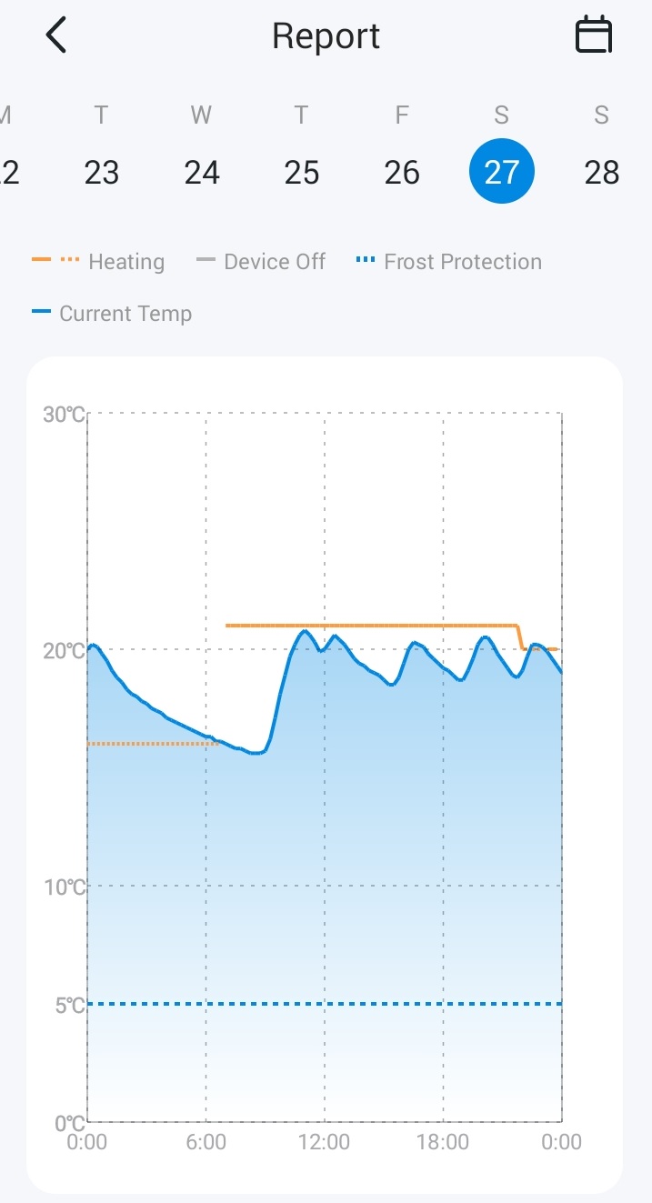

For me, with a non condensing, non modulating oil boiler, it does not matter if I use on/off zone valves (digital), or up/down TRV's (anagoge), the boiler will switch on/off, so the temperature will always form a sine wave. Report full day.jpgAs one can see from the TRV report. I also turn off heating at night, and you can see how the temperature has dropped during the early hours. If I had a gas modulating boiler, then I would have a far smoother day temperature.
The whole idea with a modulating boiler is to slowly open or close the water supply to each radiator and for the boiler to match the demand. However, unless the TRV's are linked, there is a problem, the boiler will never shut off. So we fit a thermostat in a room on a lower floor, as heat rises, in a room kept cool, as on a fine day the heating will turn off, with no outside doors of course, and also no alternative heating, of my 14 heated areas, non-fit the requirements as the sample room for the wall thermostat.
So as with most homes we go for a compromise, and in my case it has failed, it worked A1 with late mother's house, we had a TRV and wall thermostat in the hall, and when front door opened the TRV would open and ensure rapid reheating, and as the temperature set was approached it would close slightly before the wall thermostat temperature was reached, unless on a warm day. So the boiler modulated as it was designed to do. However, it is not the heating which is the problem, it is the cooling.
My hall cools too slowly, so the living room got cold before the wall thermostat in the hall reactivated, I say "got" in past tense, as we have fitted new double glazing, so this may not now be the case. But the type of boiler does not help, if the boiler modulated then it may have still worked?
If there is still a problem, I will fit a second thermostat in parallel to ensure the boiler runs if living room cool. I was conned, the TRV said it worked with my Nest thermostat, it seems when Google took over Nest it stopped working with Energenie, not that it would have done much anyway, as it worked the wrong way around. The wall thermostat told the TRV what to do, rather than the TRV telling the wall thermostat what to do.
