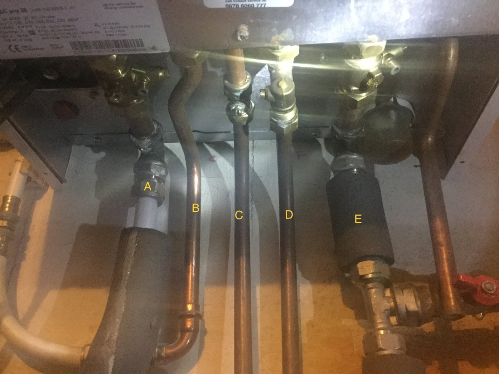

Hi All,
I've searched and checked the FAQs, but can't find the answer, sorry.
By Ecotec pro heats the water fine, but when I set the ch temp to say, 65 it fire's up and move quickly from 17 to 21, 22 degrees, then move very slowly to 27 and the boiler stops.
No fault code.
Have I inadvertently shut a valve?
Thanks in advance.
Paul

If you mean fully clockwise when turned with an Allen key, then no they are closed. Post a photo if you need to double check.

My apologies Paul, no they’re open if fully clockwise
Here's an image, which ones should be fully left? Thanks, Paul
A and E, and they’re open. What’s behind the insulation on pipe E? Why is your safety discharge not connected anywhere?

Hi,
Thanks, I'll nip down and check that they're open and have a look behind the insulation.
The safety hangs above a bucket - I'm in Belgium!

Hi,
That's cured it, they were shut.
The temp continued all the way to almost 70, then it cut and continued to gurgle all the way down to 19, then it kicked in again, this time rose as far as 55, then cut and gurgled for a while until it dropped again to 17, the hour glass flashing from mid thirties, downwards.
After a year of inactivity maybe it's clearing its throat?
