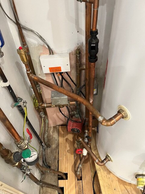

Hi

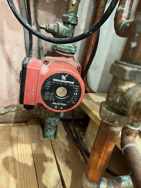

My CH system has an issue. The HWC is taking long time to heat over 2 hours, used to take an hour before. Same applies to the heating. There were grinding noises in the airing cupboard one day last week. I started looking last night, the two divertors valves are working fine, I bled the 2 AAVs and rads. The boiler is firing but only stays on for 20 sec or so then a long while 30mins or so to fire again, there was quiet grinding noise in the airing cupboard; assume from the Grundfos pump which was extremely hot to touch. I tapped the pump but no change.
I think the pump is at fault??
Any tests to do?
Photos attached, Is turning the big slotted screw would help?

You need to remove that screw and turn the inside shaft with a screwdriver. You may here the grinding noise then.
It's ok to do it with the water on, you might get some water coming out, but it's ok to check it like that.
I tried twice, screw inside turning freely and in both directions. Turn heating on, same boiler fires 20 sec stops and pump v hot to touch. Verdict?
I'd go back to the valves.

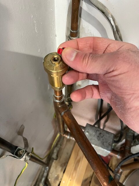

I have 2 AAVs in the airing cupboard, the heating one seems fine as water comes out when loosen. However, I unscrewed the whole of the red cup on the hot water AAV and nothing there, see photo attached, is this normal?

Change your pump. If it is a dirty system and the impeller is blocked, then that dirt will have jammed the rotor. If dirty, then clean flush it.
It's definitely NOT the port valves because boiler fires when timer set to HW or Heat stops after 20 sec and fires again after 20mins, why would boiler re start if it was/were port valves issue/s?!
Give the information; my retired plumber said exactly the same. It's been there since moved to the house in 2002. I just ordered the part. Cheers
If the circulator is not circulating then the boiler will heat up the heat exchanger and it will cut out on the boiler stat. After 20 mins the boiler will cool down and switch back on.
But the OP said in an earlier post that he was able to turn the pump rotor freely in both directions.
