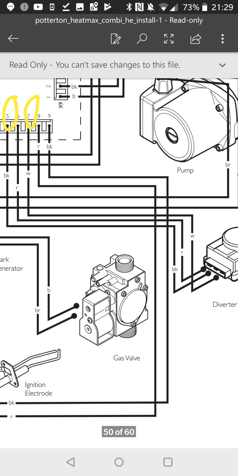

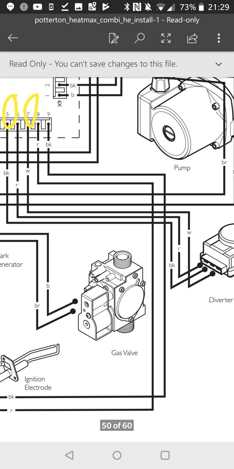

Just reread your post (not easy):D if you have 240vac between 5 and 7 on x3 on the pcb during hot water demand and the diverter head isint moving check the lead, if no 240 change pcb.
Picasso, Sorry I understand that my posts can be difficult to read, I have dislexia and sometimes spell check does not fully help :-) thank you for spening the time to work out what I am trying to say. what did you bean by on times three? I checked the cable from the PCB to the motor for resistance and they show no resistance. There is voltage to the CH wire that sends volts to the motor for the CH but none at the PCB or the other end of the cable for the Hot water demand. Many thanx
Hi dan I meant x3 on the pcb, you need to check if you have 240vac between 5 and 7 when you have a demand for hot water, if the boiler is showing a call for hot water and you don't have 240 then the board is stuffed.

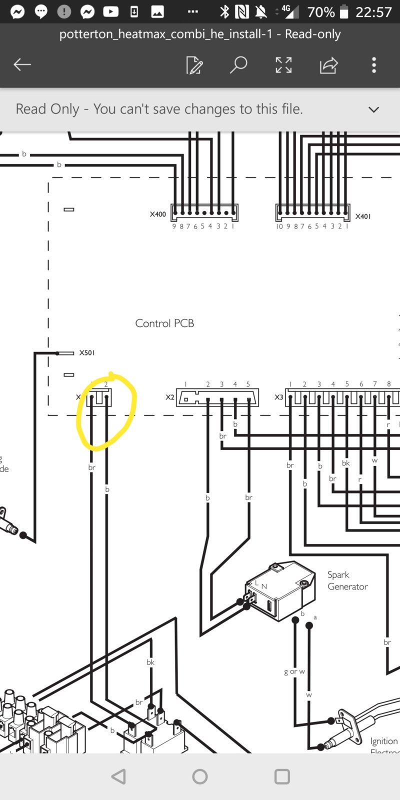

So between five and seven on the PCB? Is there anything else that could cause these to not get 240v other than the PCB? Many thanx again

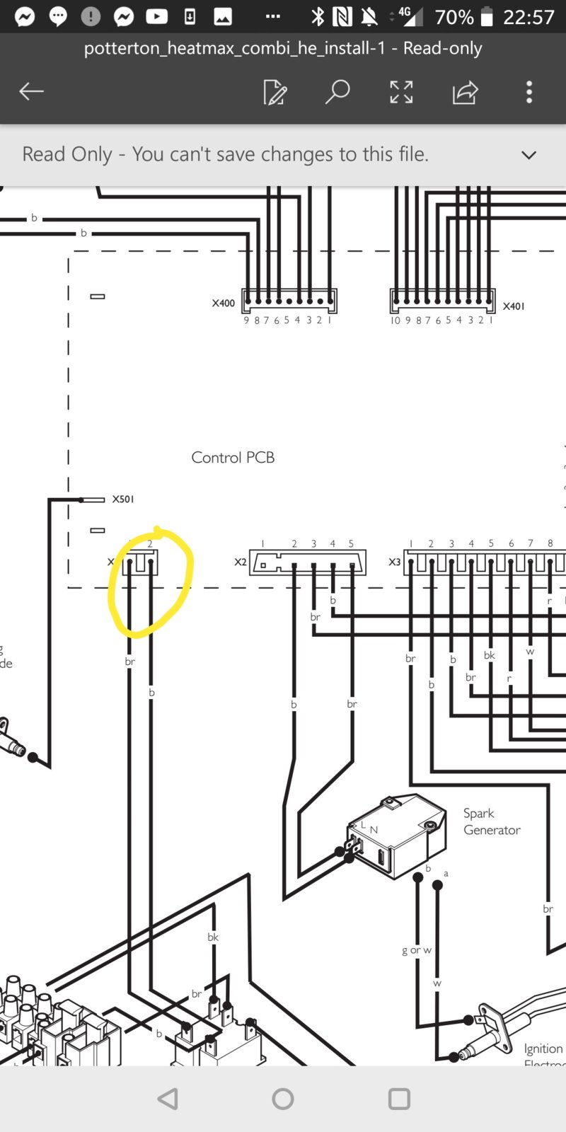

Dan have you checked mains voltage coming in at the pcb? I once had a vaillant that was a similar issue and was about to change the pcb. When I carried out my dead test, I found it was only a small voltage to pcb. I then found the wiring in the fused spur connection was incorrectly wired to the from stat and pcb would only get 240vac when heating was on switched live. :confused:
That is a really good idea I will check the mains voltage coming in at the PCB. out of interest is there any way i can get hold of a Component Layout for the PCB? many thanx
So check between these two to see if mains voltage? Should there be mains voltage at the fuses also thank you
