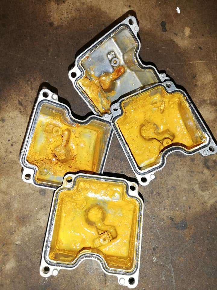

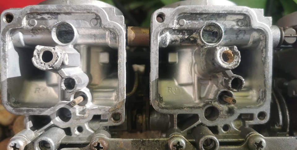

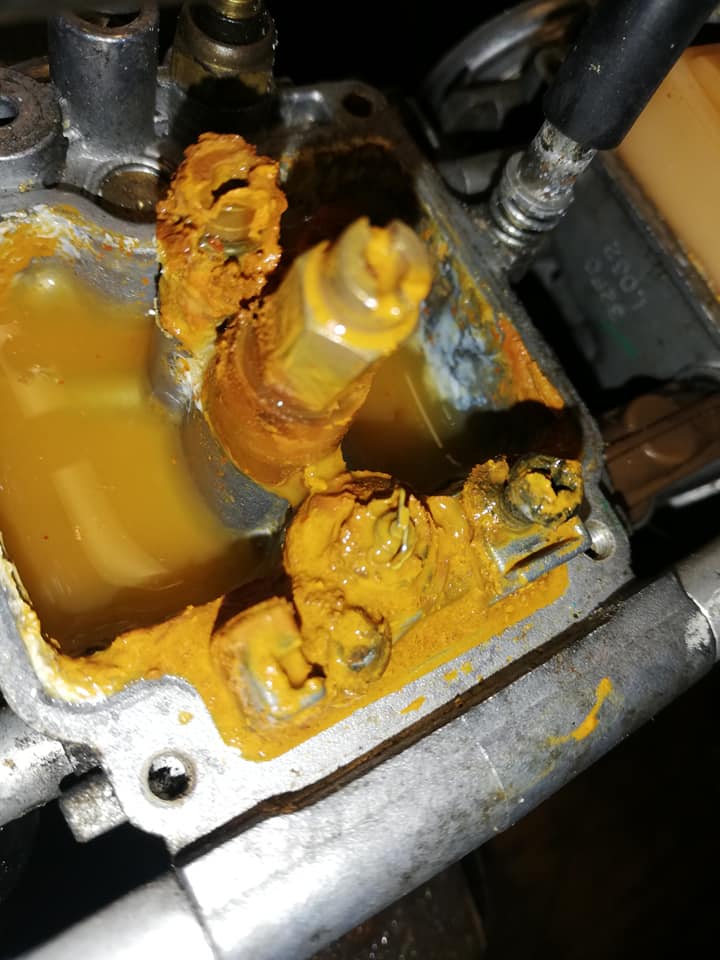

I've done a lot of work on 80's & 90's superbike carburettors & the devastating effect on them of E5/E10 fuel. The main problem is the ethanol attracts water, when the fuel goes stale that ethanol/water seperates out & becomes very caustic. It rots NBR rubber & the zinc alloys used to cast the actual carbs.
I'd assume your saw isn't all that old so it 'should' have been made to cope with E5/E10 fuel.
Just don't let the fuel go stale, which can happen within 2wks. Never leave the tank with fuel in, always drain & run dry. Even if it can cope with the ethanol it cannot cope with the glaze.

This is the insides of a mates carbs after a 10wk winter layup.
Not one of mine, but an example of ethanol corrosion from a group I frequent.
