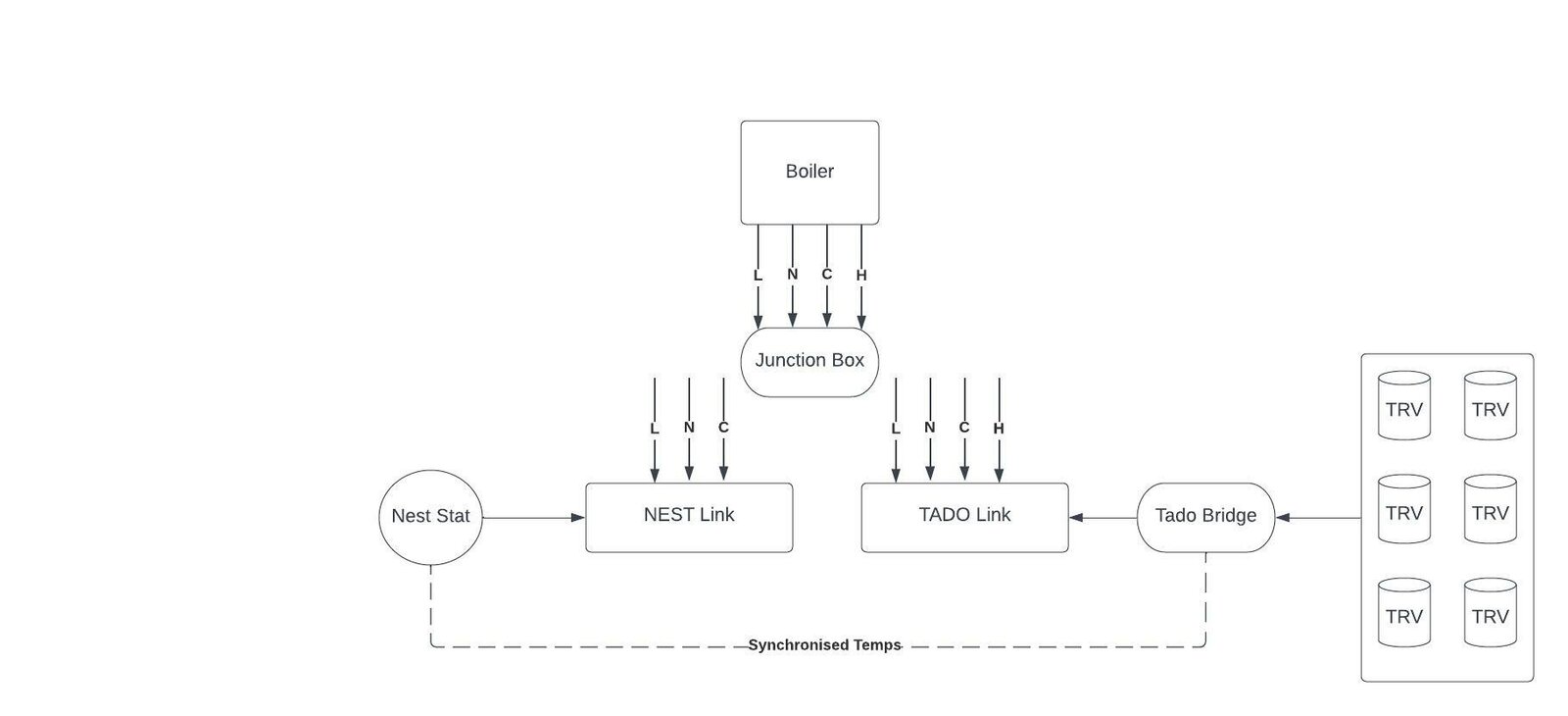

What I want to do is
N -> N(Tado) & N(Nest)
L -> L(Tado) & L(Nest)
Call to Heat -> Tado
Common -> Common(Tado) & 2(Nest)
if this is possible will a 18AWG wire work with connecting these up with terminal blocks?

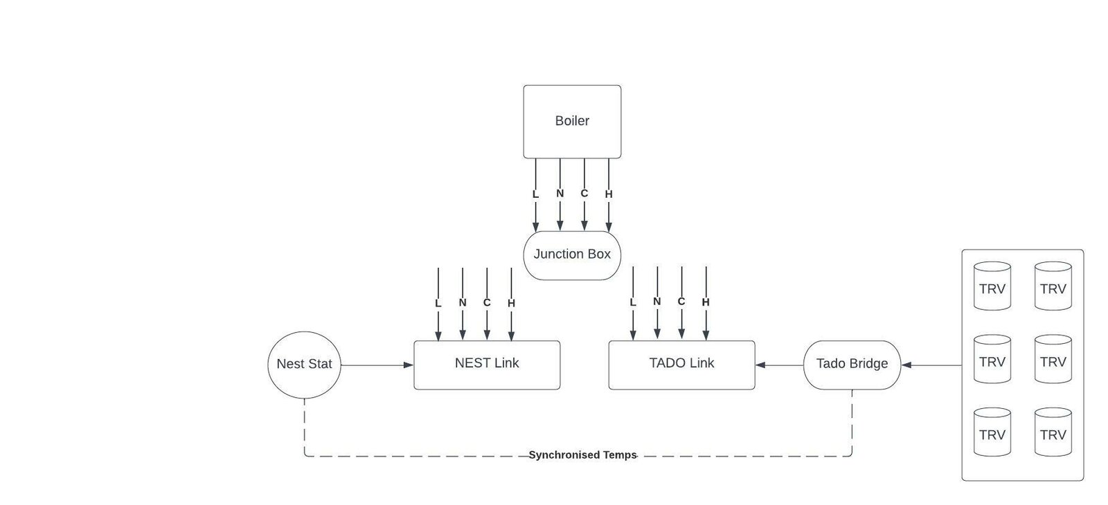

I've attached a diagram, I'm assuming this follows the "Call for Heat on the Tado to boiler call for heat" scenario you pointed out.
The Nest Thermostat won't function unless the Heat Link is powered and paired.
I also like the idea of both requesting heat.
Thanks for the info - I was just looking at purchasing everything from Amazon and the wire was just quoted in AWG so assumed it was some sort of standard.
It is, an American one. Surprised Amazon sell it here, well perhaps I'm not.

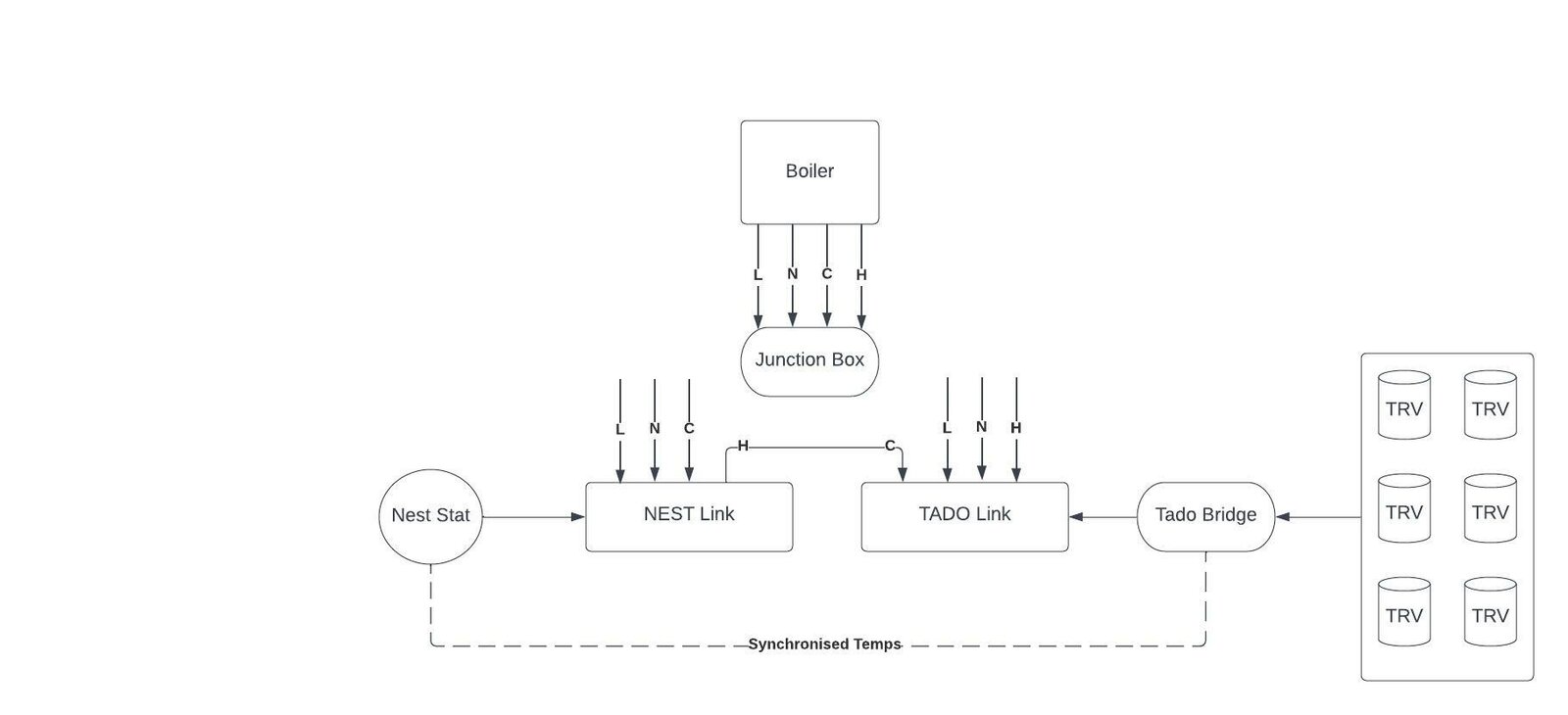

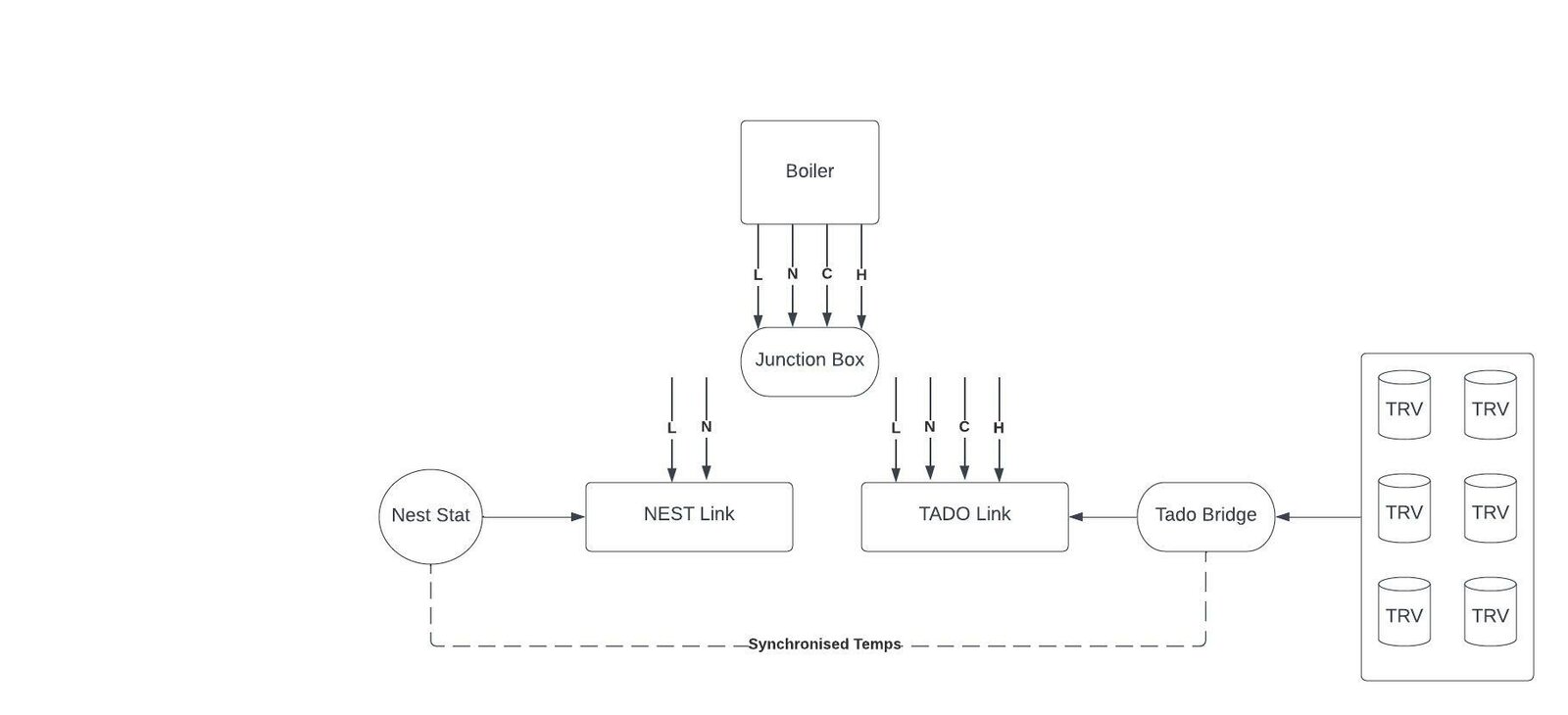

OK revamped the diagrams, @oldbutnotdead as far as I gather this is what you're saying
L = Live
N = Neutral
C = Common
H = Request Heating
Choice 1 - Have Tado Control the heating and Nest only allows to monitor temp in the room
Choice 2 - Run both Nest and Tado in Parallel, as long as any are requesting heat the boiler will remain on.
Choice 3 - The Nest can request the heating and relays it to Tado to ping the Boiler
As long as the contacts are volt free you can connect as many as you want in parallel so if any room demands heat, boiler runs.

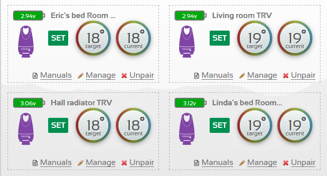

So with TRV heads there is no real need for any wall thermostat, all you want is a hub, so with for example 4 TRV's TRV-report1.jpg if any TRV has target below current boiler runs, if not boiler stops, what I can't understand is when my computer can read target and current for each TRV head, why can't I get a propriety device to simple read the temperatures and trigger the boiler when required.
So if this TRV head current below target then boiler should run, i.e. IFTTT. But does not seem to be a device which does it.
Your choice 3 is wiring the 2 controllers in series. The Tado bridge doesn't know or care what voltage is on the COMMON line, its function is to make a circuit between COMMON and CALL FOR HEAT when its internal programming requires it (ie when 1 or more of the TRVs are calling for heat).
Thanks for the info, I guess I’ll go for either choice 1 or 2. Does the wiring look correct from what I imagine?
Yes looks ok. And as someone else said, 1mm is plenty, 0.75 or 0.5mm would do (long as the circuit fusing is appropriate). Flex will be easier. I'd go choice 2, you can always disconnect the Nest if the boiler is running redundantly (ie Nest calling for heat but Tado TRVs all satisfied- assuming all your rads have Tado TRVs)
Perfect, thanks. Yes all the rads have Tado TRVs except two (bathroom and downstairs toilet)
