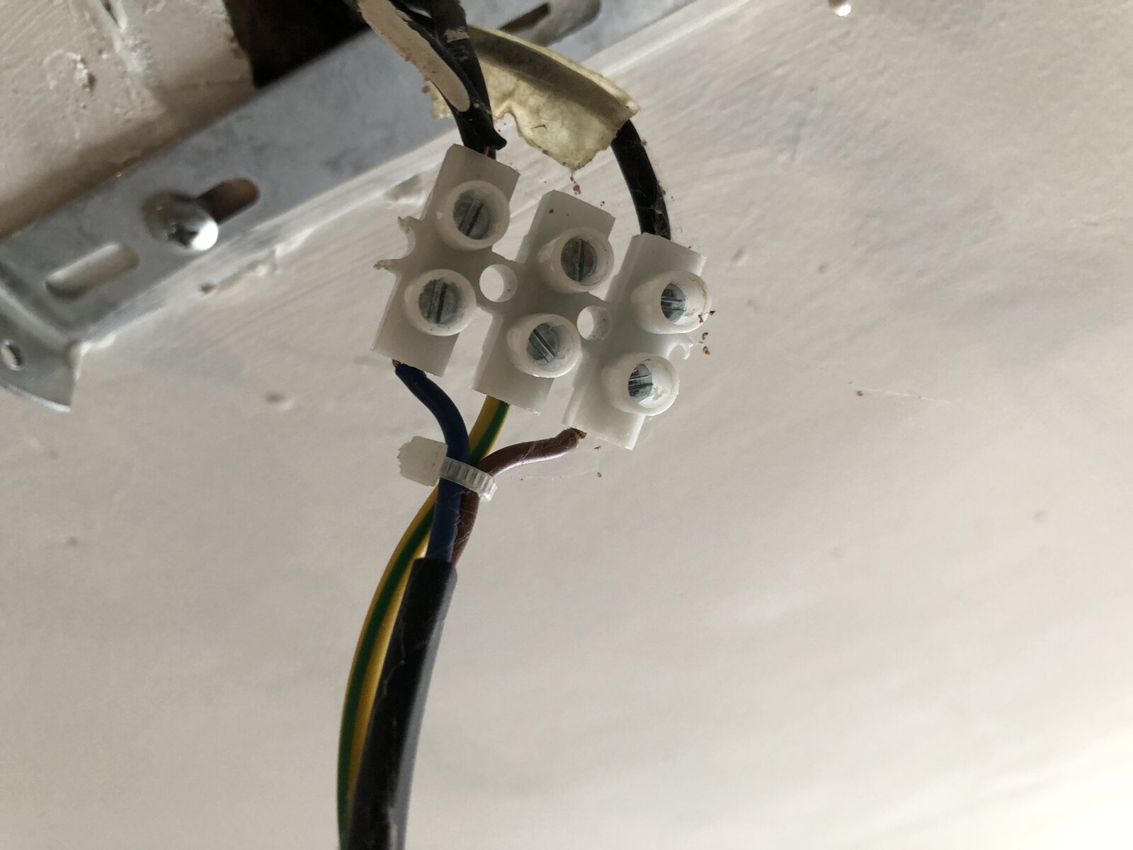

Today I replaced a light fitting in my living room.
I took photos of the wiring and replaced like for like (live to live etc.)
Turned the power back on the new socket works great.
But now the lights in the kitchen don’t work. At all. Changed one of the bulbs to see if they had blown. The new bulb didn’t work either.
How is that possible? Could it be the live m and the neutral have become switched along the ring somewhere?

If you are certain you wired it exactly like it was before, then one of the wires is not making contact with what it should be.

That’s the existing wiring of the previous light socket. I took this photo before disconnecting. I wired the new socket in using the same connections.
But something isn’t right.
For example, the previous light fitting had 5 bulbs. I could only get one to light up at a time. When one bulb blew, a different one would kick in.

There should be three red wires in a connector block. Probably in the ceiling void. Perhaps a red wire has become loose, causing the kitchen light not to work.
Also, there may be some earth wires pushed up in the ceiling void too. You will need these, if your new light requires an earth connection.
Twin and earth cable is available as two browns, but it is common to over sleeve a blue, and for the sleeves to fall off. So cable colours don't help, and since 1966 all fixed wiring must have an earth, it seems the earth is missing.

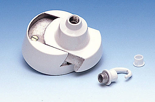

I do have lighting sockets Ceiling rose.jpg but what you show does not look like a lighting socket, and the ring final is only really done with the 13 amp sockets which will only take a plug with a fuse, lighting is rarely done as a ring.

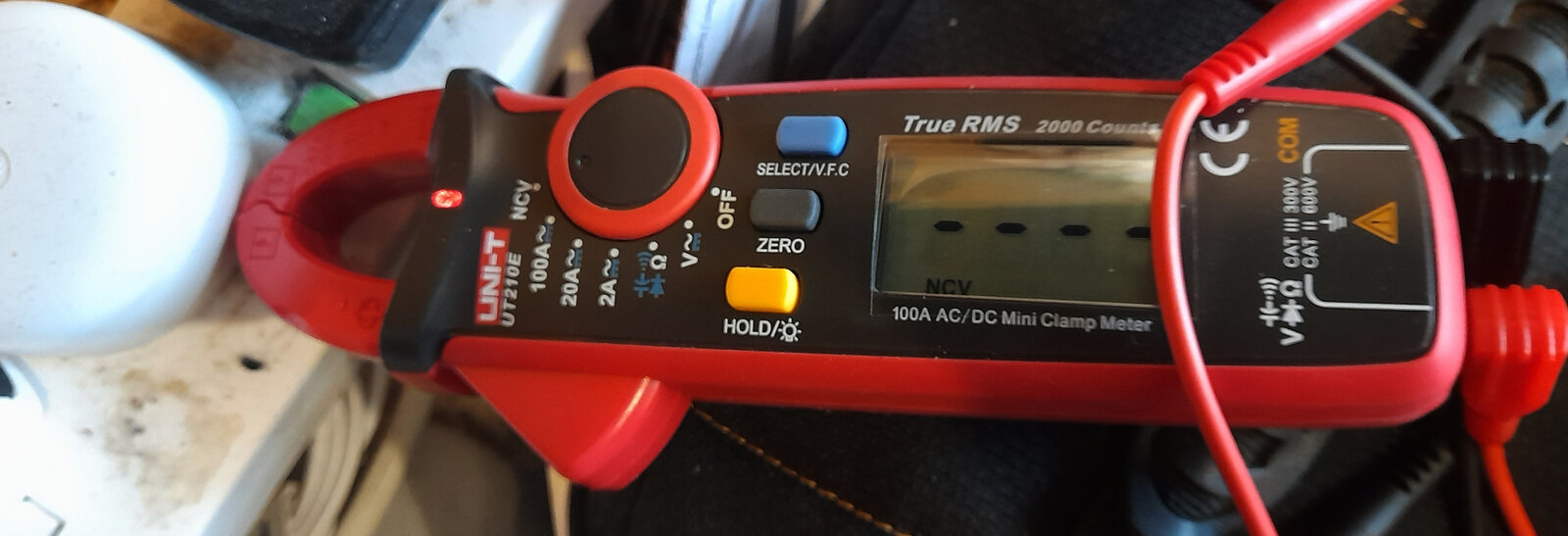

I use a meter Testing for live.jpg it makes life easy, not saying you can't work without a meter, but it does make it a lot harder, what have you got to test with.

There is no incoming earth conductor in your picture.
You state above " Earthed", what exactly do you mean by that ?
There may be other wiring connections in the ceiling ,above the connector in your pic, that you may have disturbed. Have you looked ?
But what can the connection be between the living room and the kitchen?
A wire (usually) runs from the consumer unit taking power to the light in nearest room then to another room and so on to all rooms.
This, with the switch wires, (usually) results in three Red or Brown wires being connected together at each light position.
As said, in your case, likely above the ceiling.

Have you found three red wires tucked up in the ceiling void yet???
If they are there, it's possible you have disturbed them, if they were badly connected.
Checked all the connections again.
With the power on at the mains, I can confirm power on both the live and neutral on both sides of the connection box (wire from the ceiling side and wire to the light).
I’ve read they might all be on the same circuit as in, power from the mains to the hall light - working. But there may be an issue between the hall light to the living room. Subsequently, the lights in the kitchen have stopped working as there is no power reaching them.
But if I have live and neutral working to the light, how is the bulb not working? Could it be the switch?
