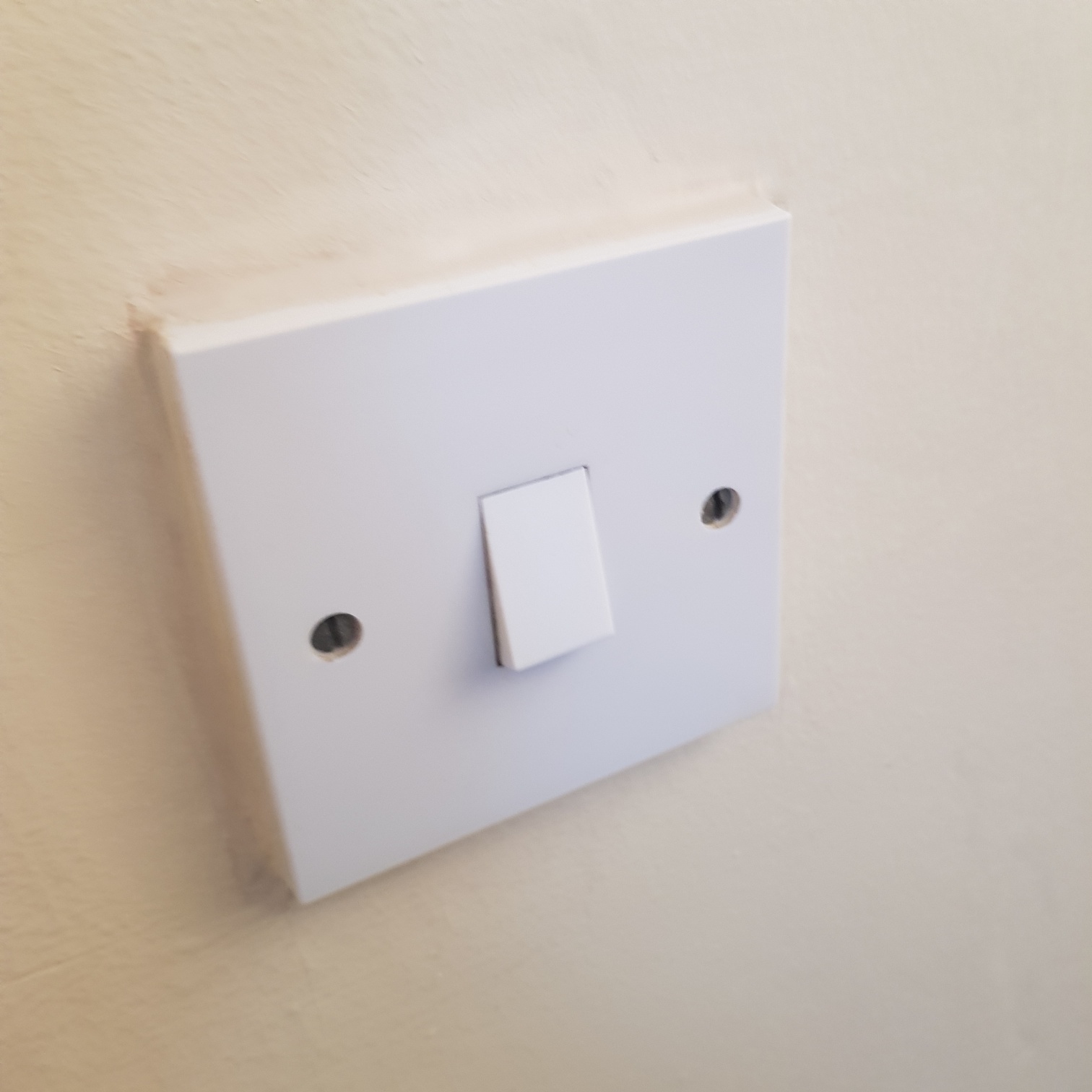

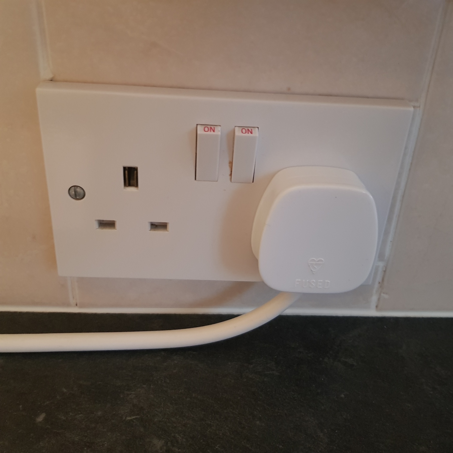

Hi all,
DIY newbie here and looking to update the flat with fresh coat of paint and potentially upgrade all the plug / interrupter (light switch – in case my wording is wrong) with something more fancy.
Is that something that a novice can do? Or do I need an electrician?
Do i need to be aware of what I am buying? in regards of specs? to my limited understanding, I believe i am just changing the aesthetic- is that correct?

Sockets should be straight forward. Switches come in different types, one way, two way, intermediate. Two way are used when a light can be operated from 2 places. Intermediates are required if a light can be operated from 3 or more places. Metal switches need to be earthed. Depending on the age of your wiring this may not be easy or possible without a rewire.
Before disconnecting anything take a photo of the connections. Different switches have the terminals in different positions.
Finally as your switches and sockets are in good nick keep them so when the antique brass fad wears off or the brass gets scratched you can put them back.
Don't forget to switch off your power before doing anything.

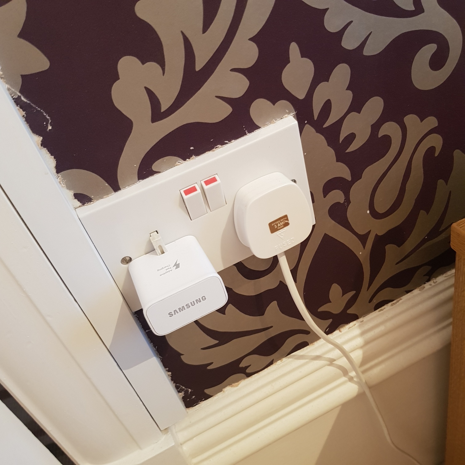

i believe all are single way - but you have raise important thoughts about earth.
thanks for the feedback - Ok so me think that is going to be a job for an electrician then maybe.
What I will do - is turn off the power and undo and take picture to check if there is earth or not and gather feedback.
If your wiring is very old, there may be no earth. If there is an earth, it may not be working properly. The current plastic switches are `double insulated` and won't be live if you have a fault. If you fit brass and there is a fault, the faceplates may be live and this presents a danger.

The simple switch often has a moulding which is common, so quick glance two way, intermediate and double pole can look the same, an intermediate can be used as two way, and a two way as simple on/off but not the other way around, double pole often used for outside lights, and there are some with a terminal to park the neutral in but does not do anything.
When we move to electronic the system changes, some need neutral some do not, and two way switching uses an extra low voltage S (signal) terminal and switches are either master or slave.
Sockets do swap position of terminals so you need to read the line or neutral marking, some double up on terminals some expect you to put all the line wires for example in one terminal.

I was pointing that an earth must be found and tested before fitting a metal socket or switch. The stuff about different types of switch applies to plastic as well as metal. Good luck testing a light switch with a plug tester.
It is not should. That Circuit must have one or more protective measures. See 410.3.3. If no cpc is present, fitting metal switch would mean the circuit does not comply with the regs. If the switch became energised, it would be potentially dangerous.

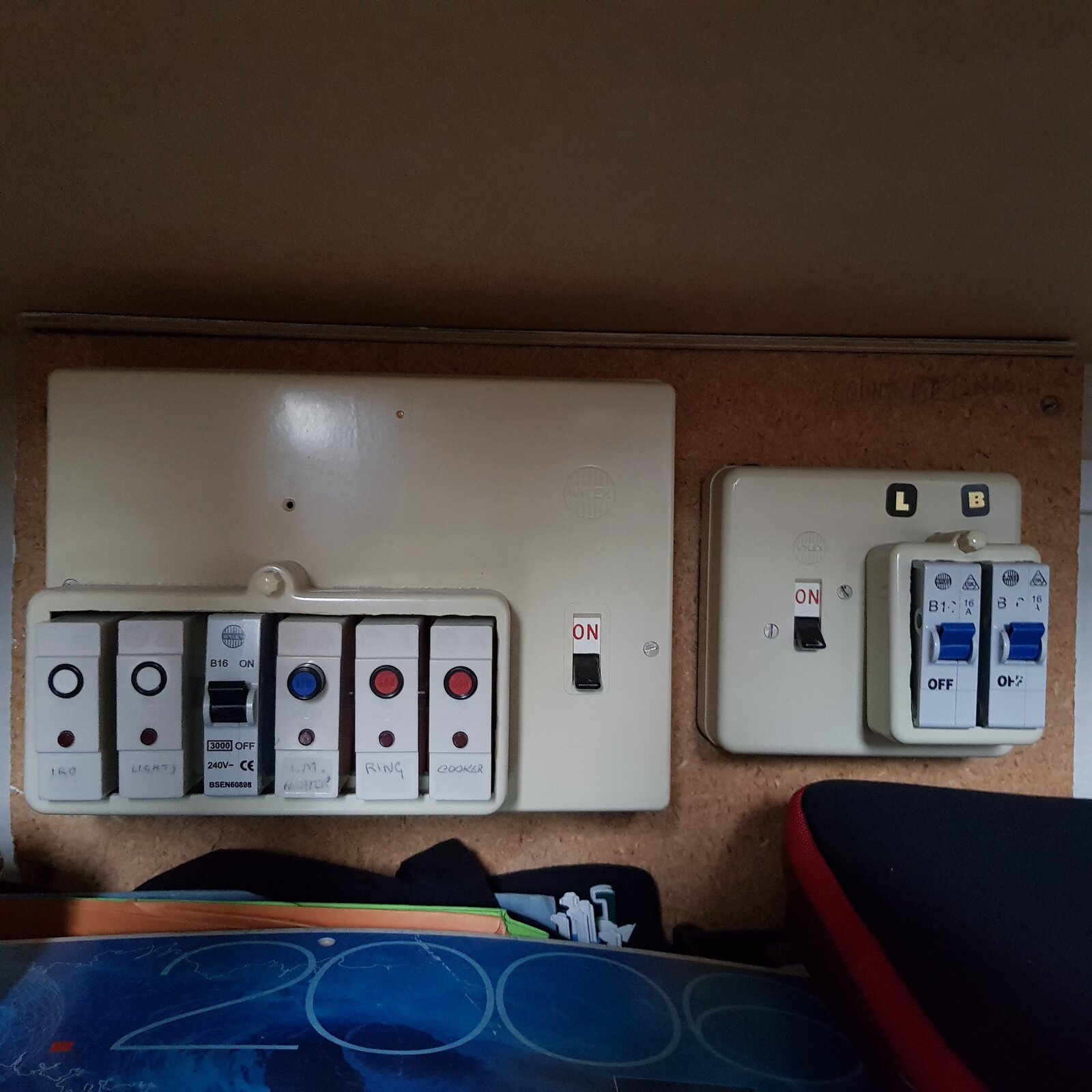

Thanks all for the additional info - have not had time yet to unscrew one switch as work been so busy. but after all that additional reading me think that might be more a job for an electrician.
I must admit as well that i have an old consumer unit - it was there when I moved into the flat over 5 years ago and never really too the time to change it - with the argument of do no change something that is not broken.
what is everybody thoughts on the consumer unit?

The converted fuse boxes you have offer no RCD protection, and the regulations require any new socket should be RCD protected, so as it stands you can't add anything without a lot of work, there is no requirement to up grade to a consumer unit, however I have in my own house, the main consideration when adding RCD protection is nuisance tripping, no one is worried if it trips due to a fault, that is what it's there for, but if the circuit is too large it can trip when there is no good reason, and also when they do trip it is how much power you loose.
So there are three stages of consumer unit (CU) each stage reduces the chance of nuisance tripping, first is simply two RCD's second is two RCD's plus some selected RBCO's (That's a RCD and MCB combined) and last is all RCBO's. What you need is to consider how much to spend v chance of nuisance trips. Personally I went for all RCBO's cost is also down to make, and RCBO type, I have cheap RCBO's type AC in hind sight maybe that was an error, but your electrician will advice what type is required, however suggest you look at the nuisance factor before hand and decide on how much to spend.
Basically if it ain’t broke don’t fix it. But as Eric said you shouldn’t add any more sockets as it is even though doing so won’t make it any less safe.
@winston1 has a good point, however that also covers changing sockets which was the start of this thread. I fitted RCD's all though years ago because my 14 year old son had become a radio ham, and be it computers or radios he was using in one way or another low voltage (230 volt) not all the bits were extra low voltage (below 50 volt AC) however with this house I realised at some point or another I would want to add a socket or light, and although you can use RCD sockets and RCD FCU (fused connection unit) and alitube cable that is a lot of messing around, so may as well replace the distribution unit (technically the fuse box you have was made before type testing started so not a consumer unit, although the replacement would be a consumer unit).
The other point is the RCD has now been around so 30 years, and we have got use to them, that includes manufacturers, and many appliances state on them they should be RCD protected, so unless RCD's are fitted a job like fitting a new boiler becomes harder, plus there have been other changes like gas and water pipes in the road being changed to plastic, although we should not use the pipes for an earth they did enhance the earth.
