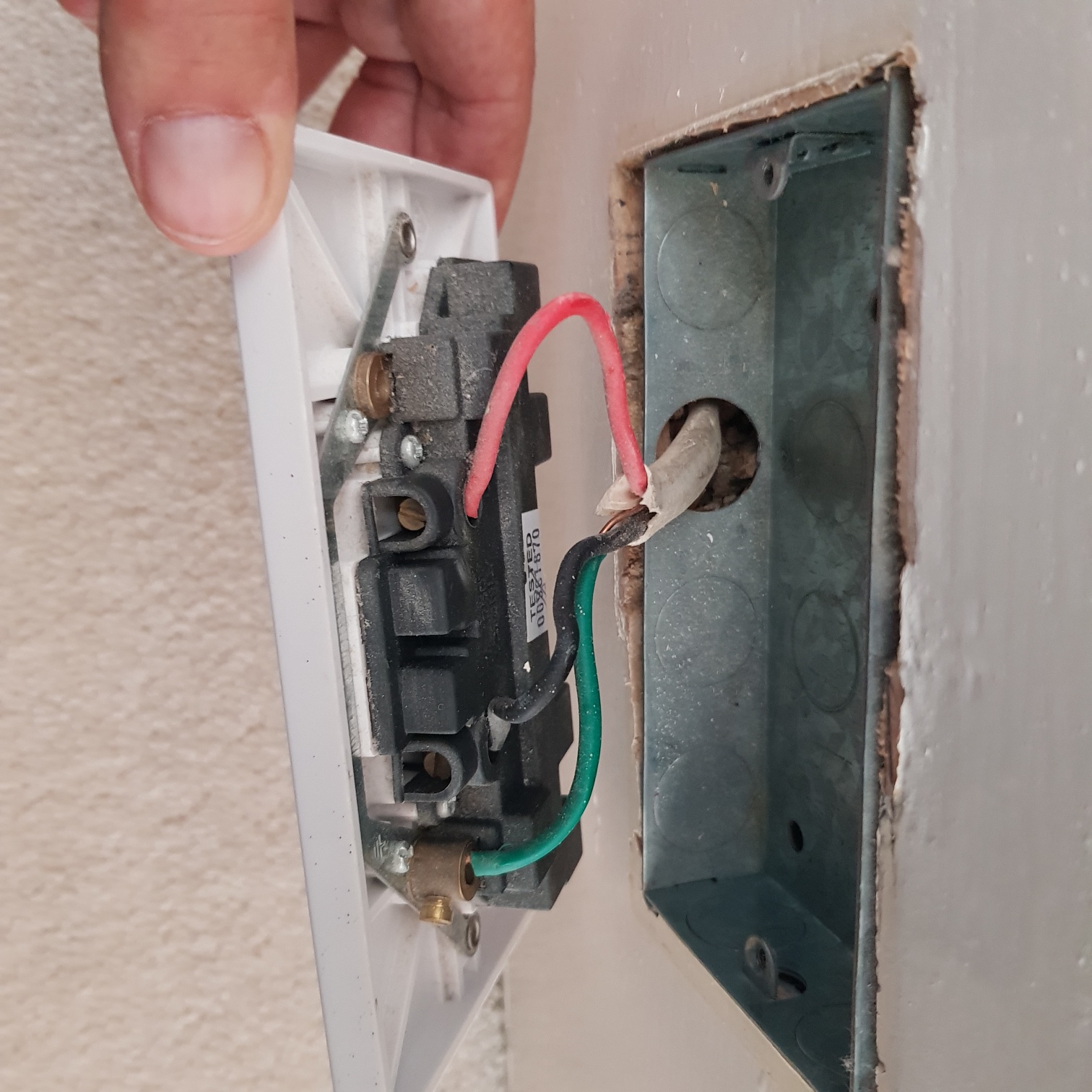

Replacing the switch face plates is not adding to the circuit. If I were called to this job, I would confirm the earth is satisfactory. If it is not, I'd leave the plastic fronts in place and stick a label on the CU advising against fitting metal switches. If the OP cannot confirm the earth, my advice is to leave it. As for the CU, the time to replace is when an EICR shows a fail. As there is no RCD it is not suitable for upgrades to the installation, without a CU change.

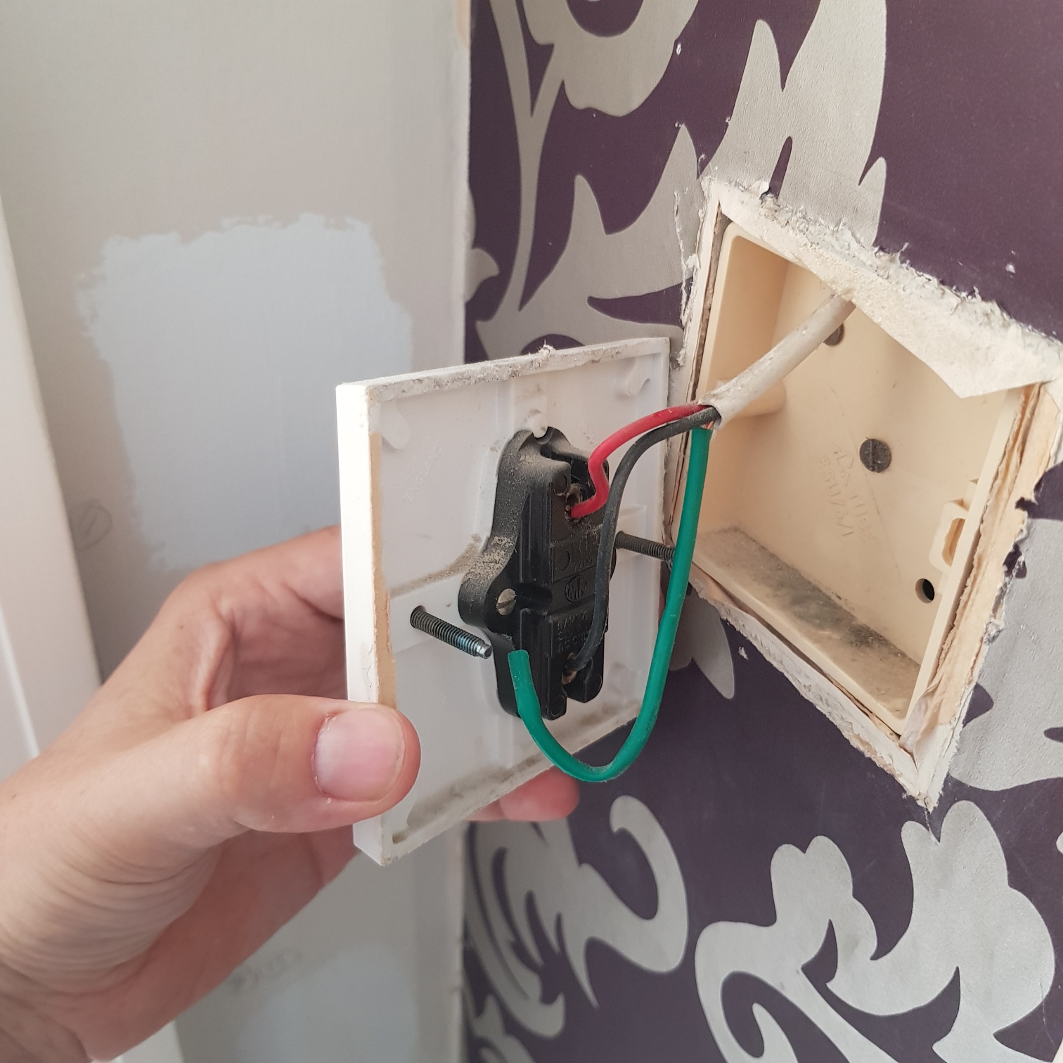

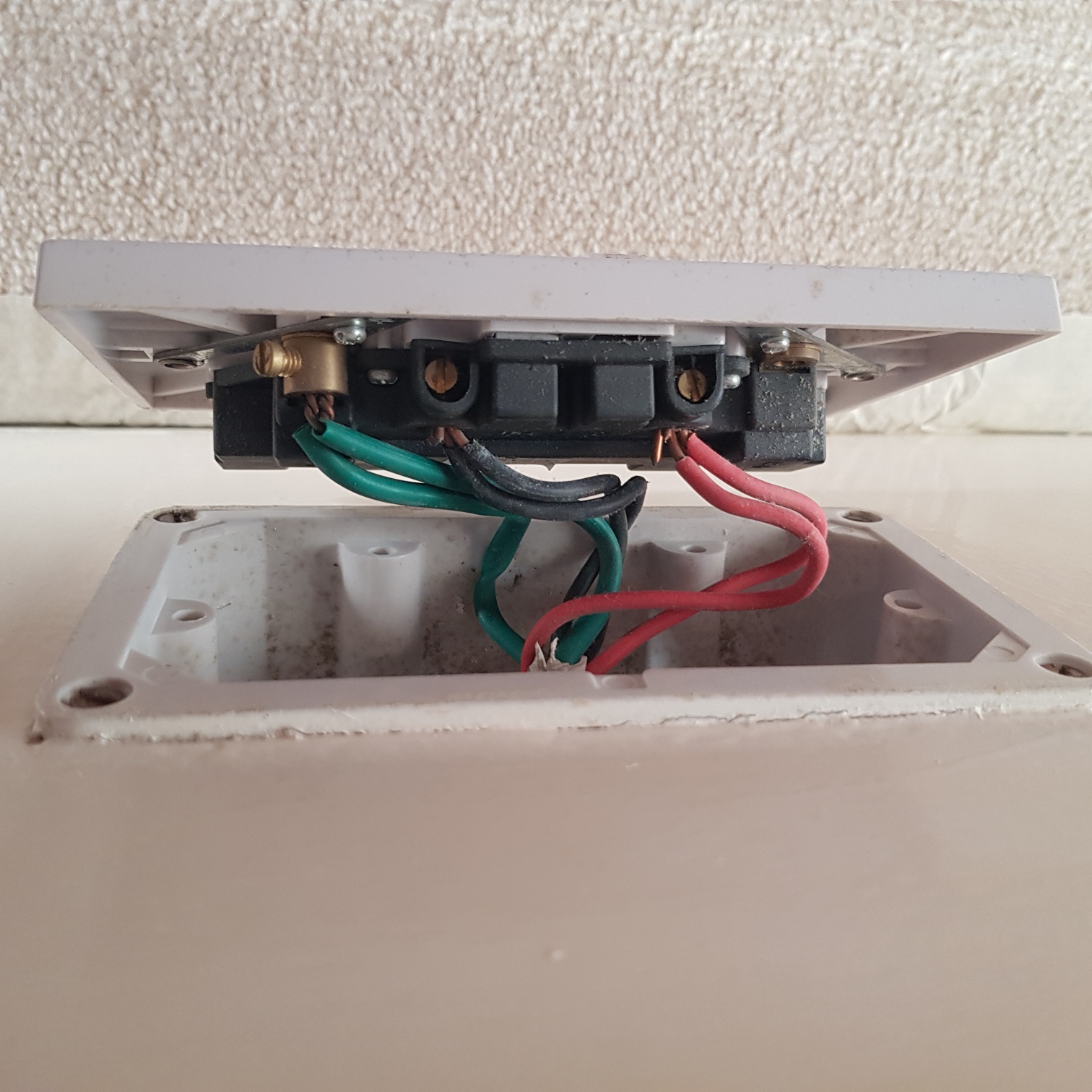

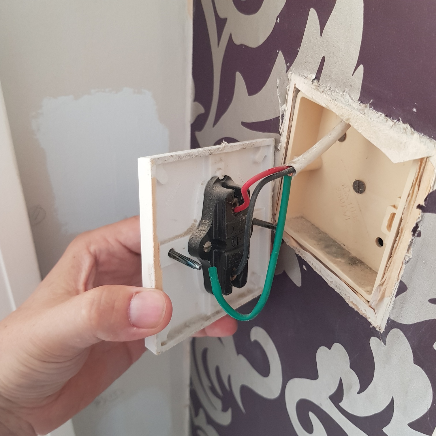

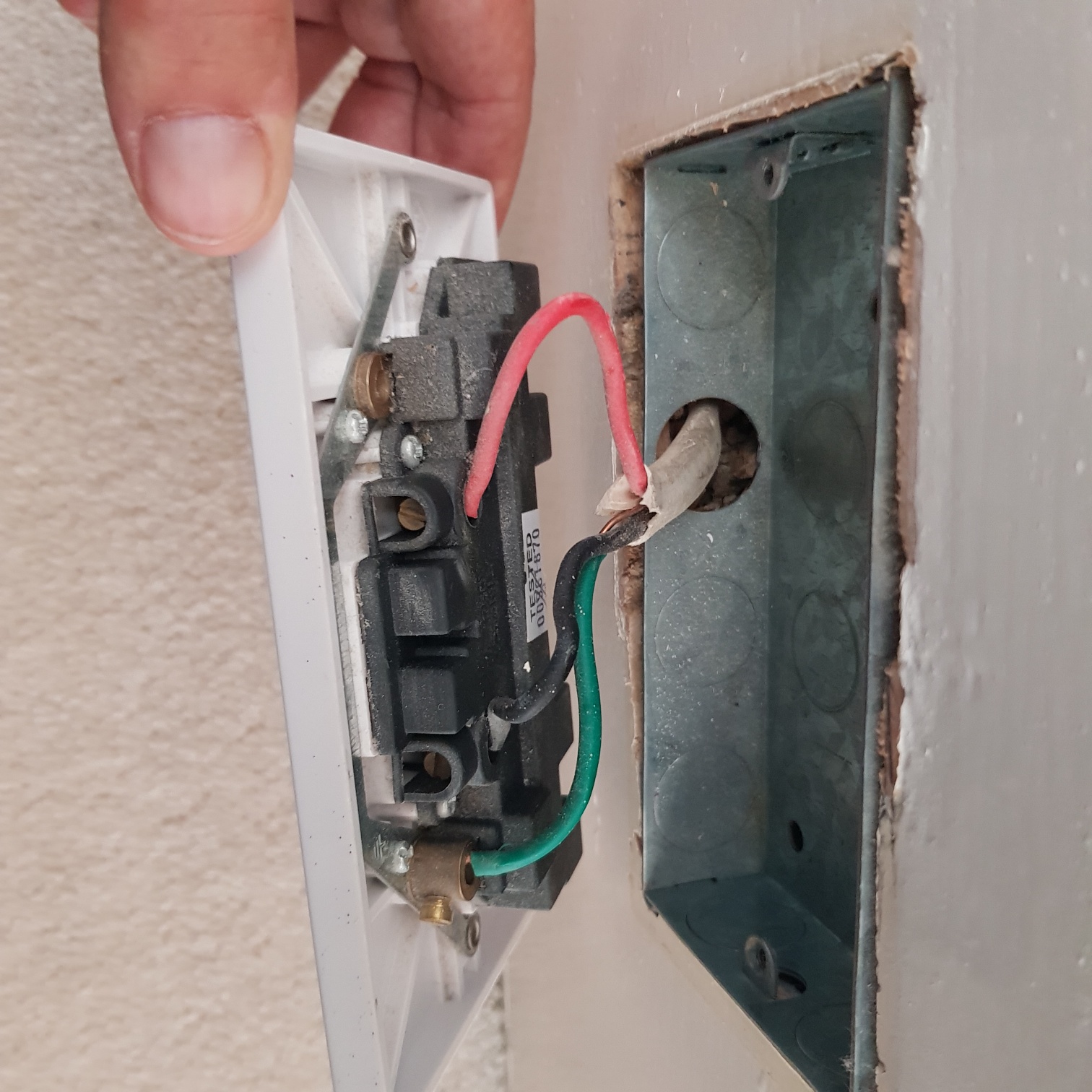

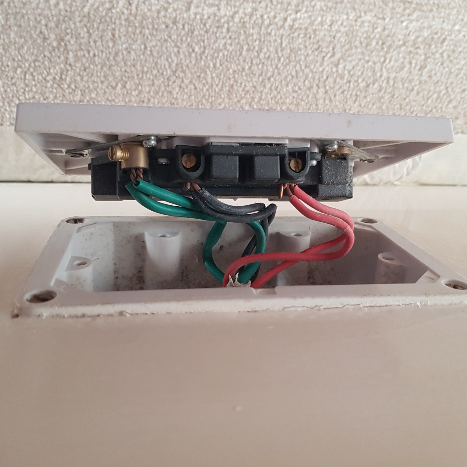

So I have got to check the interrupter and plugs and believe there is earth as per picture attached.
so as there is Earth - is that all right to change the plate without changing the consumer unit?
I guess the risk here is me to use metal socket / light switch is the risk of electrocution that would be reduce by having a RCB compliant consumer unit?

There appears to be an earth connection at the light switch, so that is a plus.
But brass?? I had to check the start date of this topic to make sure it wasn’t from 1975, but that’s your choice I guess.
One practical issue. the overall size of some ( not all) metal switches and sockets is larger than the basic plastic ones. This means that in some places the metal socket may not fit. I spotted this especially having looked at your first picture which shows some plastic trunking hard on to the side of a double socket.
