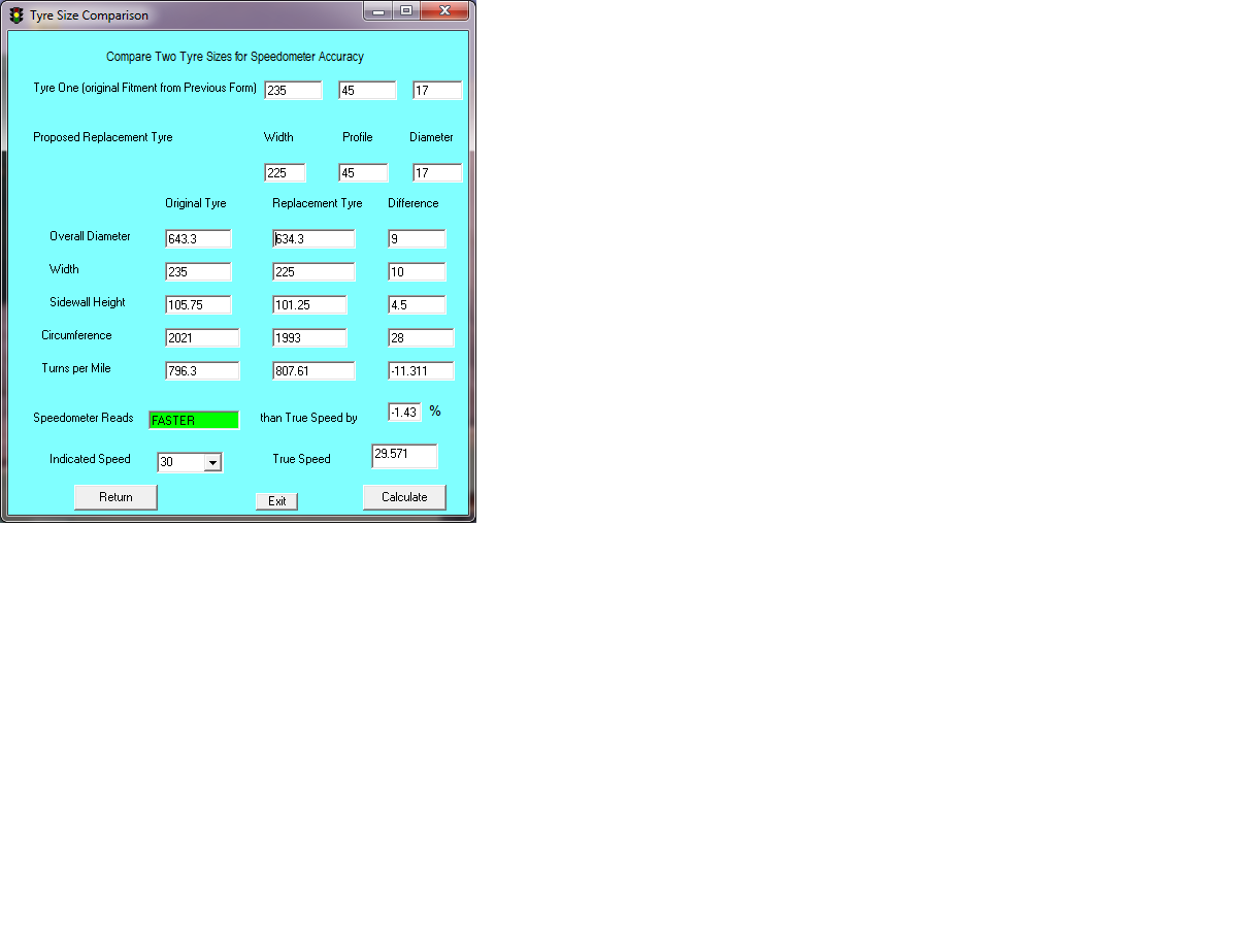

    My VW Passat is currently running on 235/45/r17 but some excellent tyres have come up a great price but they are 225/45/17.
    I'm fairly sure they will be fine to be fitted but wanted other people's thoughts to be safe as the speed and load are slightly lower at 97Y vs 94W.

    Shouldn’t be too much difference but may make your speedo read slightly different. Depending on the rim size, the tyres may look slightly stretched on the rim being 10mm narrower. The '45' in the size represents a sidewall height of 45% of the '235' mm tyre width which is approximately 4mm taller than a 45% profile on a 225 tyre. Speed and load shouldn’t be a problem - load is irrelevant on a passenger car and the speed rating is faster than your car could possibly achieve.

    I wrote a program to compare the differences between two different sizes of tyres. I have input your tyre details, and (hopefully) attach the results. 235-to-225x45x17.png
