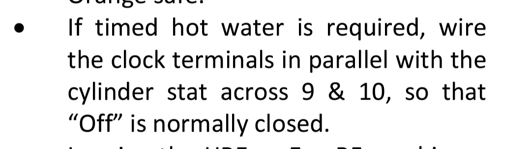

I am trying to follow the diagram uploaded by @dilalio for D-Plan where the hot water timeswitch and cylinder stat are connected to 9 & 10 on the low voltage side of the PCB.
Yes, the LP811 could be used on the ELV pins 9 and 10.
The important point to note...
The timer would be connected in parallel with the tank stat, and you would be using the normally closed terminals I.e. LP811 terminals 1 and 2.

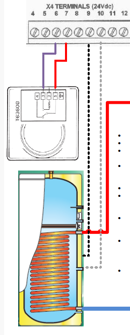

The diagram you mentioned for anyone else's benefit...

The tank stat is connected, so that when it is satisfied, it will close the circuit, i.e. connecting together terminals 9 and 10 on X4.
Or put another way, with the tank up to temperature, terminals 9 and 10 are 'shorted' together.
Connecting (in parallel) the LP811 Normally closed terminals 1 and 2, to X4 terminals 9 and 10, will ensure a relatively safe way to provide this 'short circuit', when the hot water isn't required.
