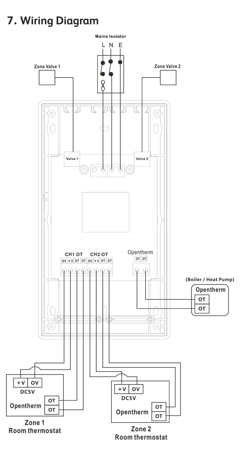

Just to add, with the Intergas X Plan wiring - it may be possible to keep a dual zone system and OpenTherm control, through the use of a specific controller.
A Honeywell Home T6R - 2 zone system has been mentioned in previous posts...
But that now seems difficult to get hold of.
This isn't a recommendation, but to prove they exist, here's an ESI dual zone, OpenTherm system...
Something like this could independently control the two C/H zone valves, whilst providing the OT output to the boiler
(Although, including the X Plan zone valves, you may end up with quite a few valves in your system!).
