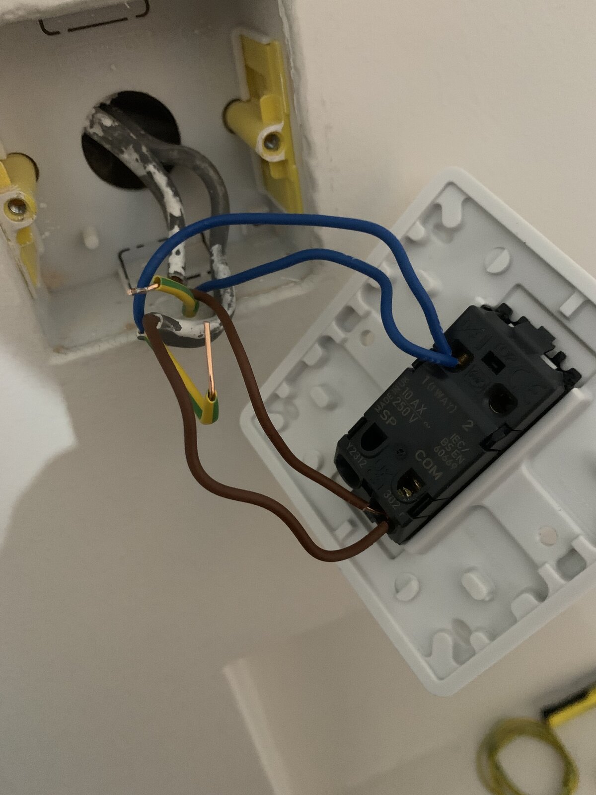

It’s just a normal one way light switch that I want to use. I have twin and earth cable on each side of it. Would the earth just be connected together and not go into the switch?

Is that picture of the existing switch that worked fine with that wiring set up ?
No, that’s what I want to wire it into. It was just a clicker type switch so I wanted it to look better in a normal light switch. It’s isolated until I know which way to wire it in.
Don’t switch it on. You’ll kill the switch.
The two neutral blue wires connect together in a separate junction. They don’t connect to the switch AT ALL!!!!
The earths also need joining together in. A separate terminal block.
Then, one brown wire to COM, the other brown wire to L1.
Like this, only you don have the third feed out cable
thanks @flameport
Show us a pic of wiring at old switch before you removed it ,if you have one.
Or tell us what the old switch terminal markings were and what wires connected to each.
I’ve only put the wires in to show for the photo to get an idea of what to do with them. Thanks Taylortwocities, that’s just what I needed to know, I have terminal blocks I can use to wire it in.
Unless you took a photo of wiring beforehand or as @terryplumb says, post photo of removed switch that’s being replaced indicating wiring layout, then you might need to test the wires, which might be beyond your skill set.

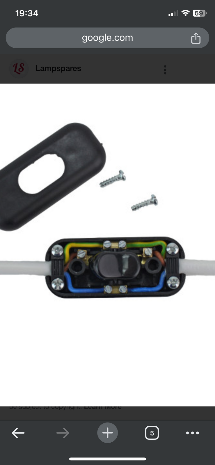

It was a switch like this one, wired just like a plug.
