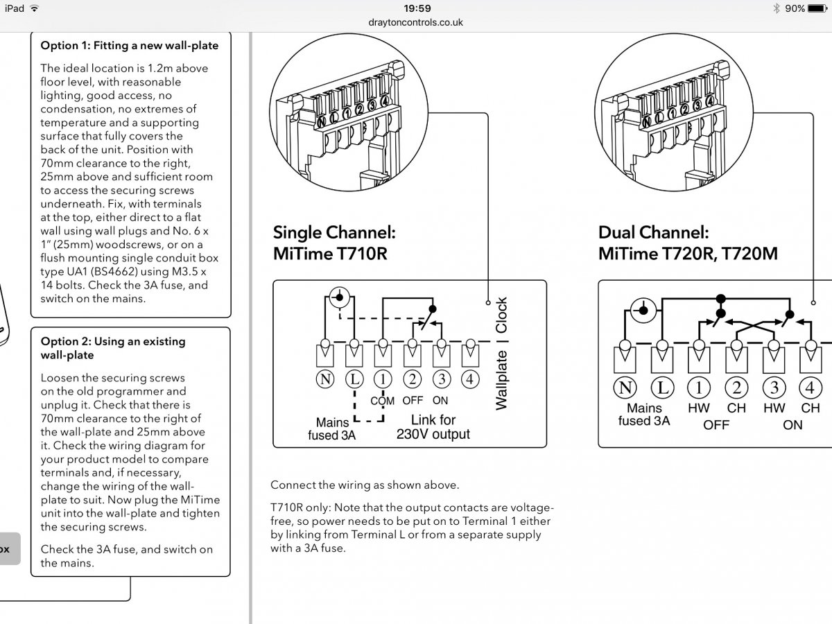

Hi. I'm wanting to change my central heating room thermostat. It currently has 4 wires coming from the wall of which 2 are unused and taped up ( neutral and Earth). The new thermostat is a Drayton MiTime T710R and I'm not sure how to wire it. I'll add some pics to help. First here is the wiring diagram from my current thermostat....
Well, i think you have the wrong end of the stick!
The Drayton MiTime T710R is a programmer that has a wireless thermostat.
The main box (the larger one of the two) replaces your existing boiler programmer. This allows you to control the heating and hot water times.
The smaller box is the thermostat and this can go anywhere.
The wiring to the existing thermostat will then be redundant and can be removed.

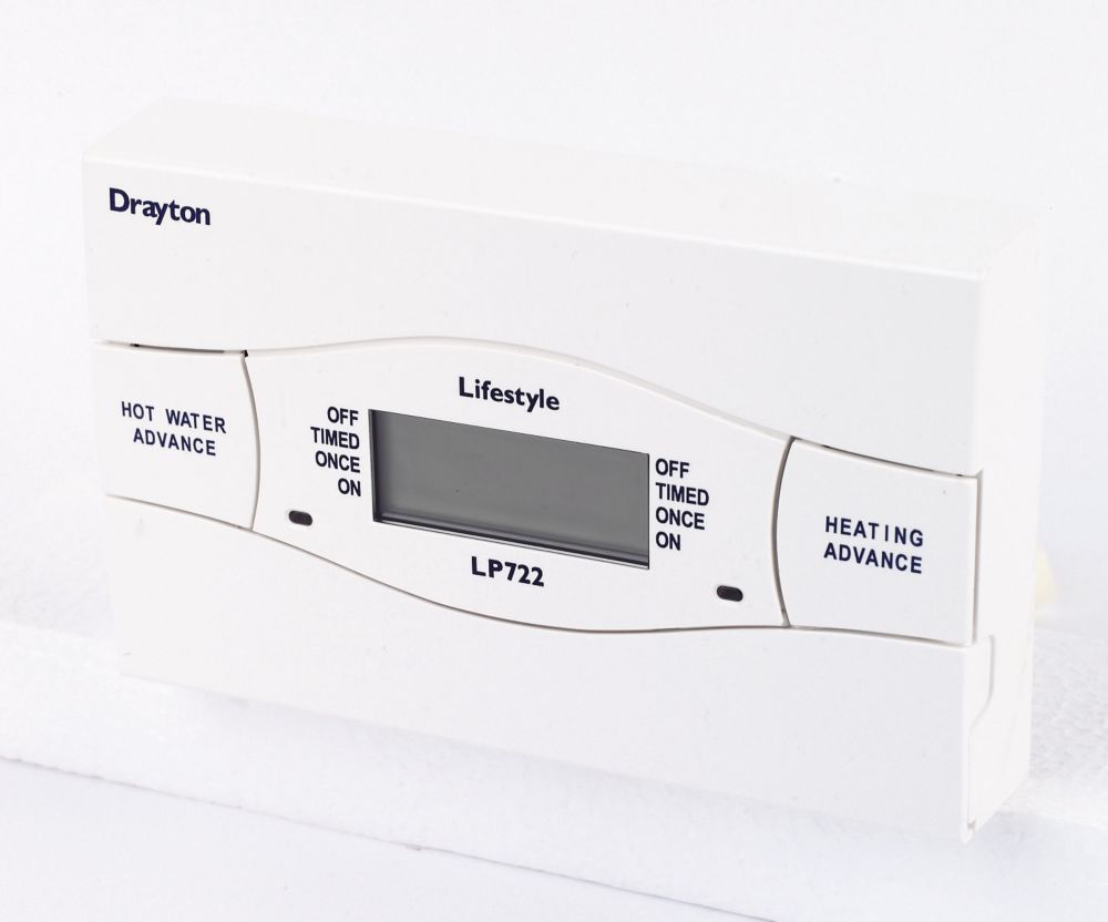

You may have another programmer,somewhere where you can set the times for the hot water and the central heating.
Something like this
ae235

I have just replaced a thermostat and timer in my mothers house for a timed thermostat. Old system has two options. It is on at set temperature or off. New one has 5 options per day non is actually off. This post only a few days ago was talking about the same thing.
Look at the Horstman DRT2 and the Horstman HRFS1 and see if these do what you want.

Okay. So looking at the diagram for this heatmiser thermostat, and looking at my wires in the first post- which goes where? I'm not sure what the yellow one is...it was used for the 'call for heat' in my digistat image.png
On your old wiring, the blue goes on to N = Neutral (you need that)
The red goes on L (live) and you need a bit of wire to link L to A1 too
Yellow goes to A2
That's it.
