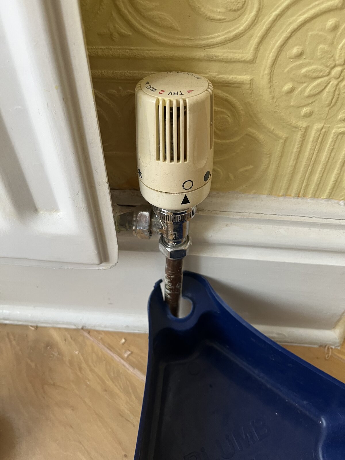

Changing Copper Olive on TRV

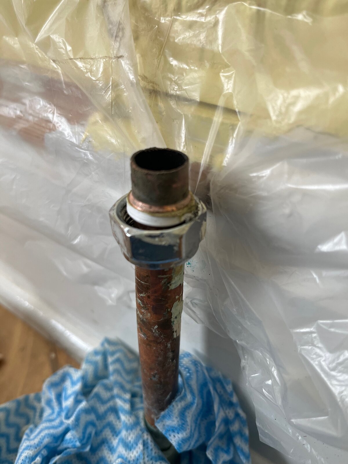

Tried backing nut off half turn and re-tightening but that didn't work. Took off valve and it looks like white PTFE already used before. Is that correct? (see pictures below).

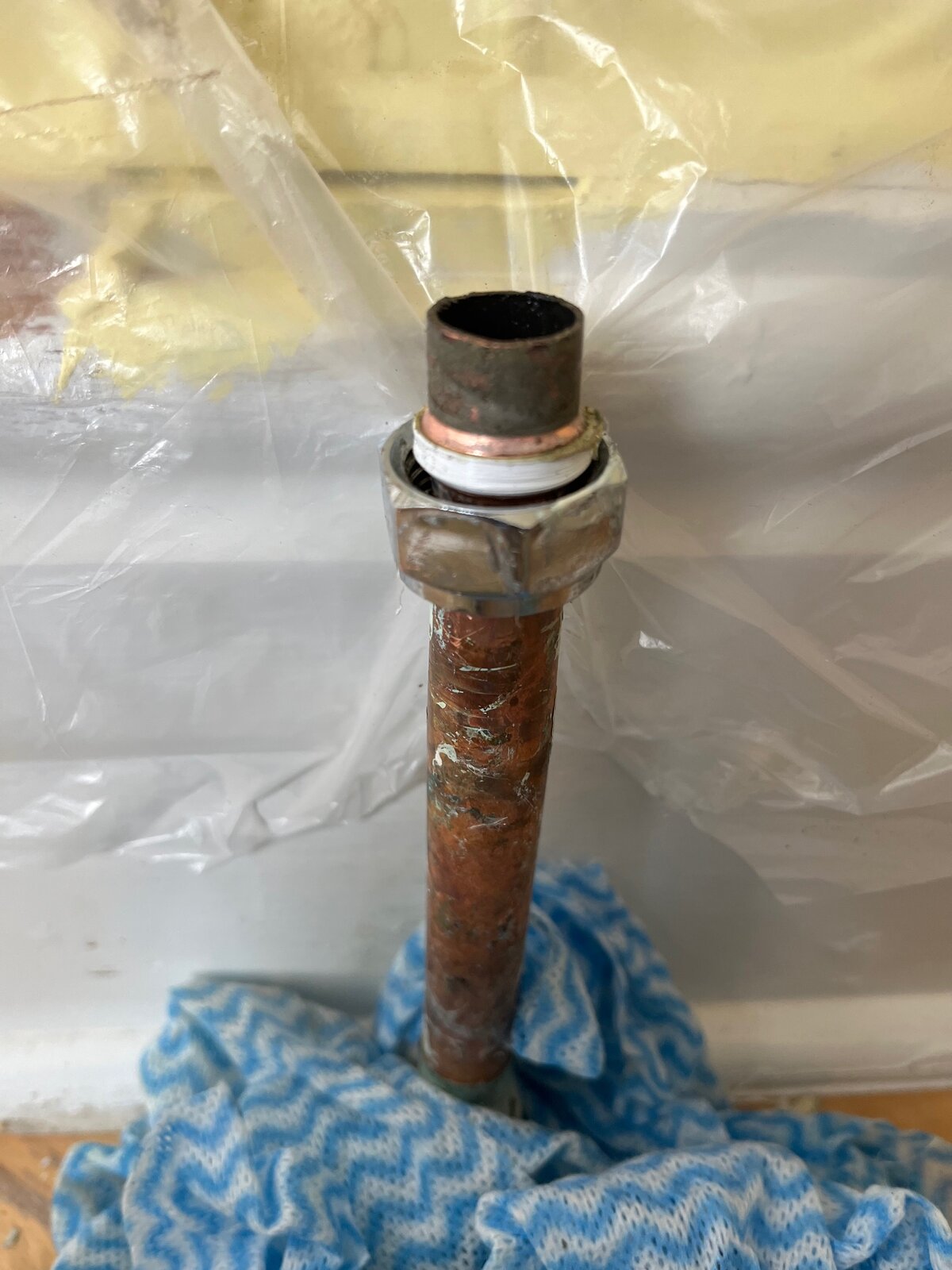

It could be tape or anything white, but if hemp had been used, the joint would not have leaked. Tape is all too easily 'squeezed' out from a joint where hemp is not.
I'm trying to figure out if I need to remove this white stuff or put the PTFE over it
It is PTFE tape - just removed it. Will clean joint surfaces and put on some new PTFE tape.
If you've got it to that point why not replace the olive? Worst case is it's a junior hacksaw and saw 4/5th through the olive and then a plain screwdriver in and twist to snap it off and replace with new copper olive.
Thanks for the advice - good point. I also have a monument olive removing tool I bought a while ago - assuming it's better than the hacksaw

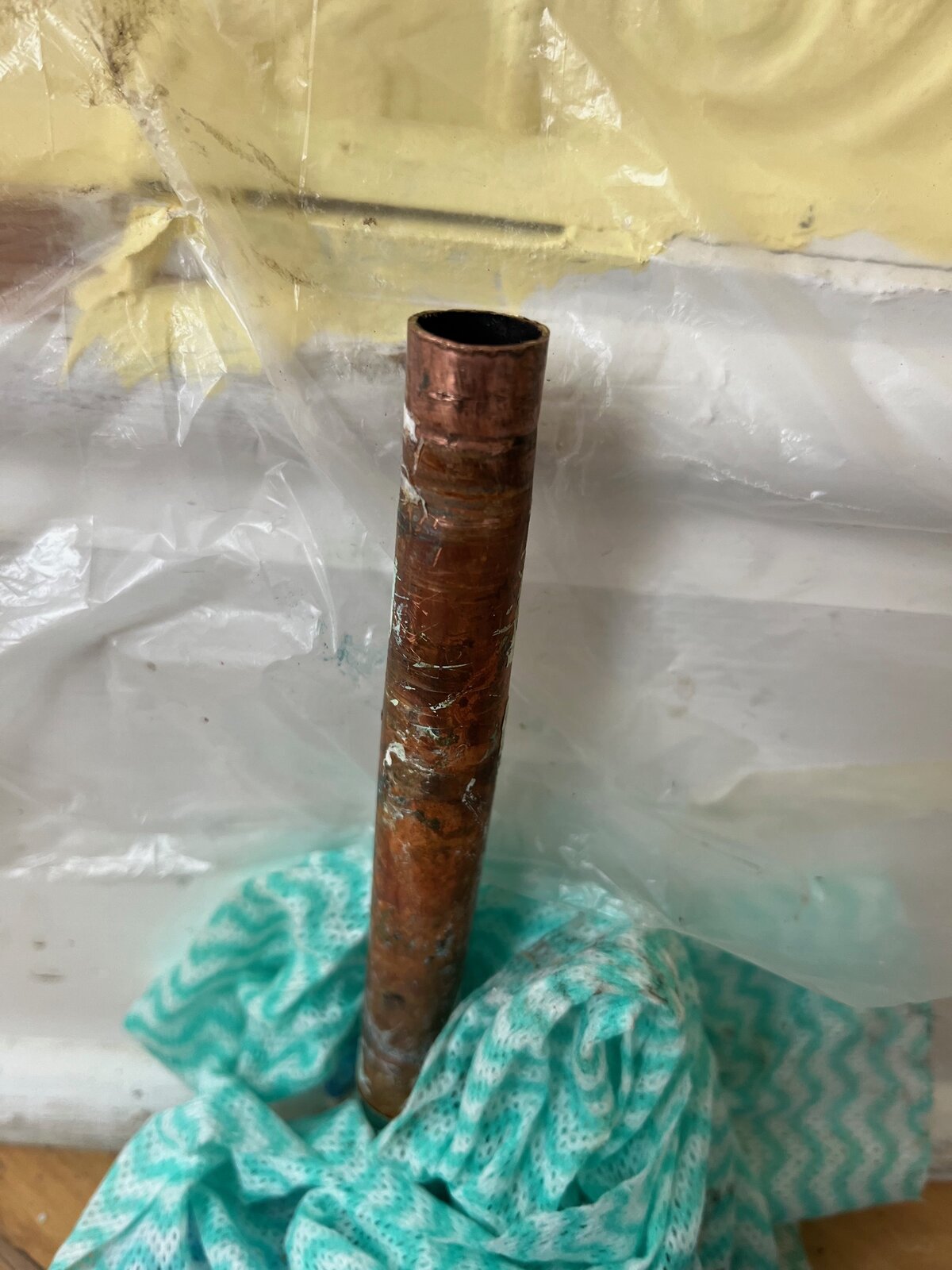

Removed olive - pipe slightly compressed - hopefully won't cause problems with new olive
That pipe certainly indicates that the removed ring was really graunched on, so put a thin smear of jointing compound on the pipe before you add the new ring and then a little after to ensure a water tight joint and then tighten into the TRV.
Others will disagree, but in that situation, I would fit new olive, gently tighten nut in order to compress olive, then wrap 3-4 wraps of PTFE around new olive and refit valve.
Used PTFE tape - leak fixed.
Thank you everyone for the help.
