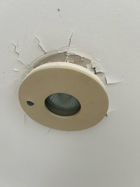

Hi all,
I am struggling to work out how to replace the lightbulb above the shower.
It seems to be a GU10 Spot bulb, but the problem is that I cannot get access to it. There is a clear cover in front of it that I can push up, but cannot remove.
Please see the pictures below. Any help appreciated!

I would guess bevel twists off, and bulb is G5.3 not GU10, so simply pulls out, and likely 12 volts.
I can’t get the bevel to move at all. It is stuck to the white section above, which feels quite rubbery.

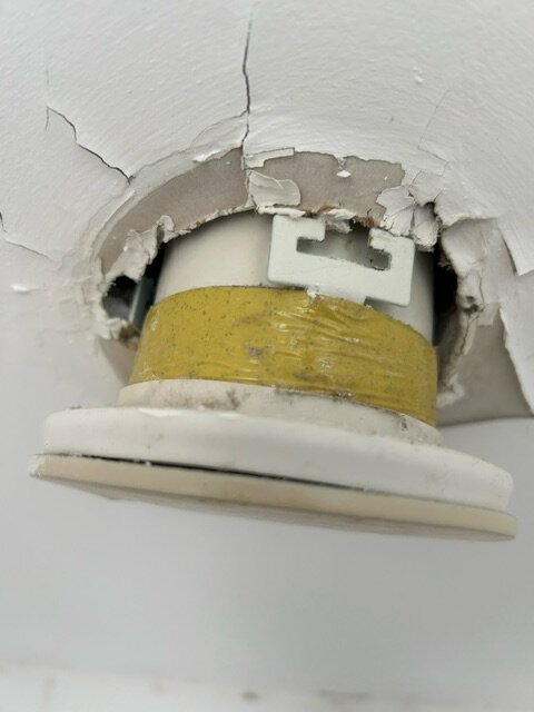

Now you have got that far I suggest taking the light fully out of the ceiling so you can get hold of it properly. You may find a makers name on it.
The ring you are trying to remove is a bezel and there appears to be at least one retaining spring missing.
