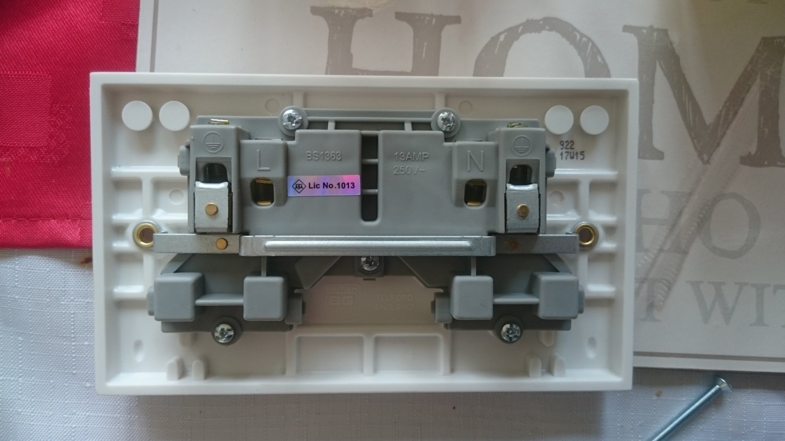

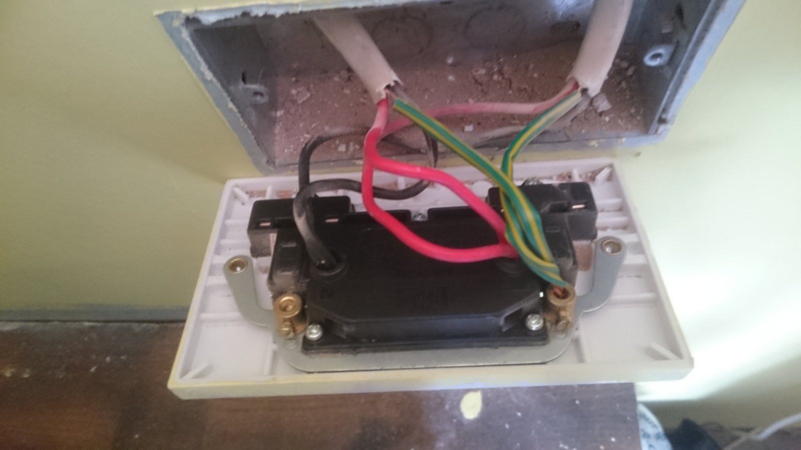

So im changing a plug socket (double) in the kitchen, as it seems to intermintantly work.
Upon opening it up, it seems the earths are both in the same earth terminal. Is this normal. And is this how i should replicate, with my new one.
Picture of existing. And new

Changed over. Washing machine and tumble dryer, back to work. Cheers dude, i didnt think it would make a difference, but when youve got this brilliant comunity at your fingertips, why not ask.

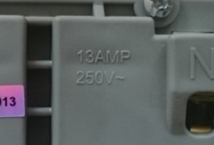

Both on one double socket. Not good. If both are on at the same time you could overload the double socket which is likely to be rated at a max of 20 amps (not 26 amps). Maybe this is why the other one failed.

It has been stated several times on these forums that some, not all, double 13 amp sockets have a max overall rating of 20 amps.
This forum does not make the standards or the regs. A double 13A socket does not have a current rating.
Well according to mk who make double sockets that's what they test to!
It's nice on this thread that the op was helped before the obligatory argument, rather then after:LOL:
As I understand it, BS1363 requires the temperature rise test to be undertaken at a total of 20A (if I recall correctly, 14A + 6A, which seems a little odd!). However, that obviously does not prevent a manufacturer designing a produced which is 'rated' above 20A, and testing it accordingly.
