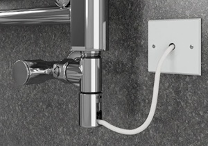

Could a set up like this not be achieved?
The idea with the "Dual Fuel" elbow is that the pipework is connected as shown in your picture and an electric heating element is inserted vertically at the bottom. Like this:
So, what you propose would work, provided that the bottom of the elbow has a blank for the outlet where the element would be inserted.
