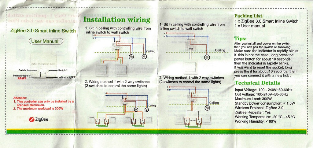

Alternatively, you could install a "smart" relay in the cavity above the light fittings and keep the existing switches.

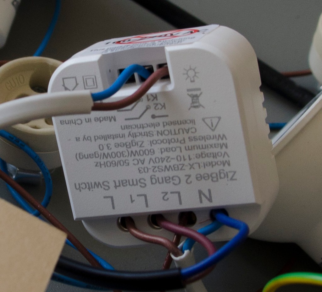

Yes you fit a relay at the lamp, the unit DSC_6061.jpg connects to switches seen at top here using extra low voltage, and a change in state of switches swaps the relay to on or off, it does not matter if the switches go off or on, just they change state. DSC_6060.jpg details on box.

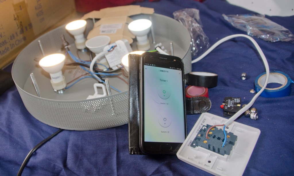

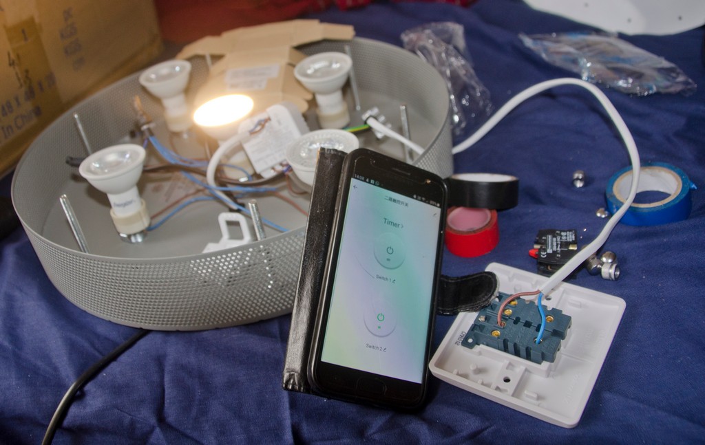

I wanted a light top of stairs, still not fitted waiting for son with ladders, but I set it up to test DSC_6058.jpg DSC_6059.jpg the idea is 1 or 4 or 5 lamps not sure if I will renew cable to two way switch so all lamps switched with hard wiring, or if just 4 switched hard wired and 1 switches with phone only.
Instructions here Landing-light-relay-instructions2.jpg Landing-light-relay-instructions1.jpg with no neutral at the switch this seems the easy way around the problem. Zigbee so does need a zigbee hub.
