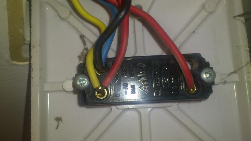

Hi i have 2 gang 2 way light switch at the bottom of the stairs this can switch either the light at the bottom of the stairs on or the top landing lights on.
At the top landing i only have a 1gang 1 way switch to control the top lights.
So is there anyway to change the top light switch to a 2gang 2way switch all the same wires from the bottom seem to be there only certain ones are doubled up in this switch.
GALLERY]
Need clarifiaction as to what you want to do.
So you'll then have a two gang switch upstairs as well. Is your intention that the additional switch will turn on the downstairs light?
If so, the answer is no. To do what you want, you would have to do two things
1. Change the switch (easy peasy)
2. Run a 3-core and earth cable all the way from the downstairs light switch to the (new) upstairs switch. (much more difficlut)
Yes, there are the same number of cables in both switches but you cannot separate them to do what you want.
It may be worth while having a look at the diagrams for two-way switching and you'll soon see where your problem lies.

Sounds like you want to be able to switch the downstairs light from an additional upstairs switch eg. 2gang switch.
What you have seems to be the conventional method. I have wired my landing lighting in the way you are suggesting. Its a pain if the downstairs light is left on and you are upstairs.
The solution is to run a 3 core and earth cable between the two switches eg. Upstairs to downstairs. However this may create disruption to your decor. A compromise you need to consider.
