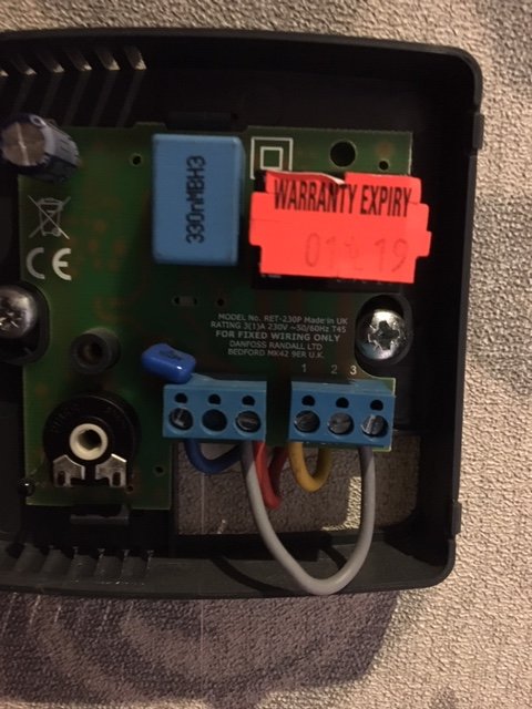

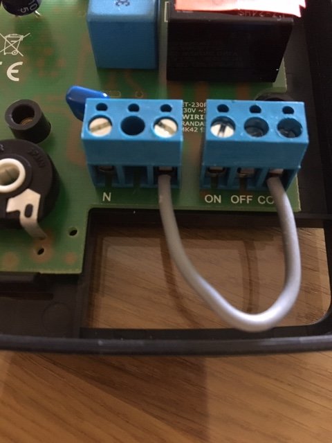

Hi is it possible to change over old standard thermostat Danfoss RET-230P to a digital one DT90E Attached a picture of old wiring and new thermostat just has terminals A B C.
Thank you for any assistance.
Red to A, yellow (on) to B and terminate the old blue (N) safely as it isn't required.
