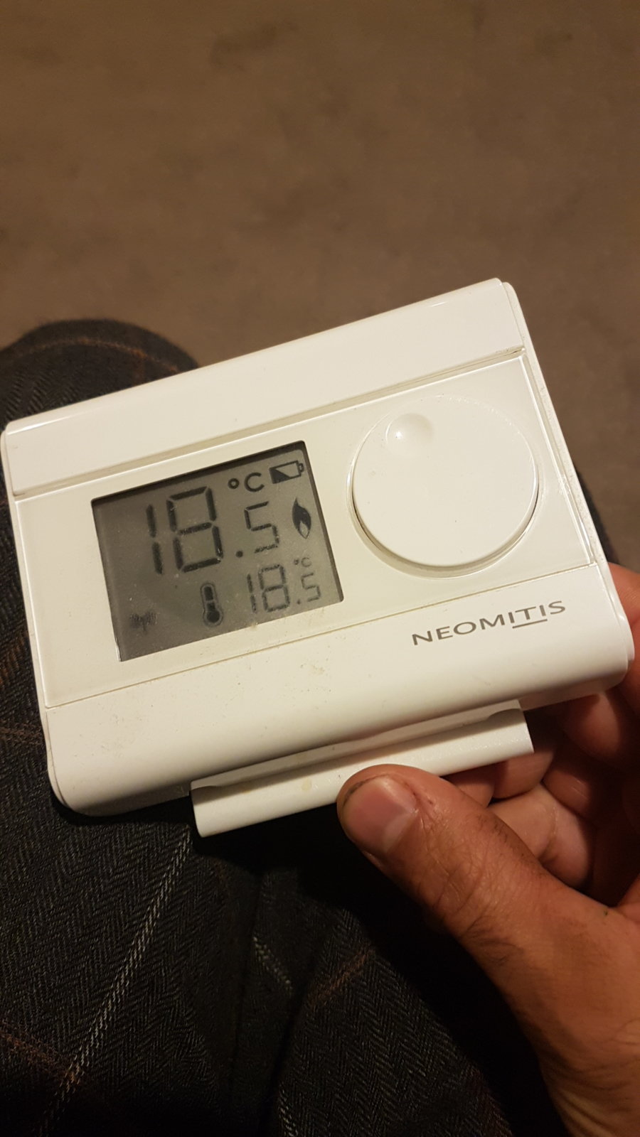

Hi, I've a very basic question and hope you can help!

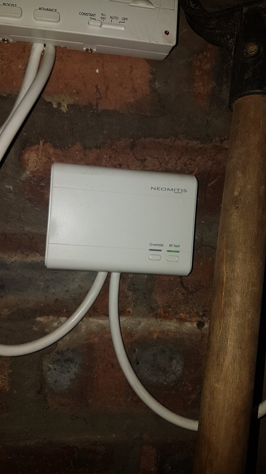

Can a wireless thermostat be changed without needing a new reciever? I have these two but want to get a programmable thermostat.
If you’re sticking with Neomitis, then it may be possible, but you would need confirmation by them, if changing to say Honeywell, then no it wouldn’t work as the frequency would be different, and software might be different as well.
Thanks. Is wiring up the new reciever as simple as wiring a plug?
- a bit more trickier, but yes similar principle.

There are so many brands to choose from some good some bad, some that are usually highly recommended, yet fail too soon. I guess it’s a preference of what you want to achieve and using which technology, eg do you want to control via phone?
your existing setup uses a standard back plate and switches between 2&4 so all other wiring will stay the same if you let us know which thermoastat you want to use we ill tell you if any changes are needed, a ten min job at most, easier than wiring a plug
Thanks. I'm not sure what to choose, but definitely need a wireless thermo that we can pop in another room when the stove's on. Do you know if the Hive system would be suitable, based on this? Sorry, I'm a complete clueless customer (I have a trusted boiler guy that I'll probably use but want to buy the right thing).
yes Hive single channel would suit, you would have to move the existing wires in 2&4 to 1&3 and clip the hive heat link on and job done
