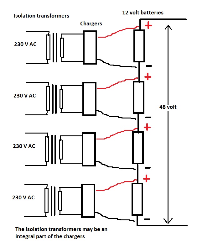

Charging 4x 12v 7.2amp in serious 48v
I have 4x 12v 7.2 batteries
sensible maximum current is going to be about 5 amps but any decent charger is going to self-limit.

Charging batteries in parallel is not reccomended. In fact connecting batteries in parallel is never a good idea. If one cell in a battery fails then the good battery will discharge through the defective battery. Depending on the type of failure the current from good battery to bad battery may be high enough to damage them and / or create a hazard of boiling battery , fumes and maybe fire.
it is acceptable to use four 12 volt chargers to charge a 48 string of cells provided that the chargers ouputs are totally isolated from each other.
Care needs to be taken that the batteries are evenly charged and that all chargers are on at the same time. Rotating the batteries ( or chargers ) monthly will reduce the effects of differences in charging rates between chargers.
That, in itself, can obviously be prevented by the use of diodes - by that doesn't alter the fact that the appropriate charging voltage (or the charging current if the voltage is fixed) will differ between 'good' and 'bad' batteries.
