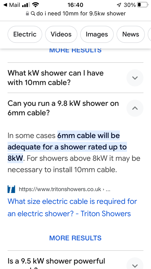

Thanks, I was just going by Triton website, so assumed 10mm was a must
So should be fine just to run on 6mm.
However it looks as though the cable for the shower on the new Mira needs to be on the left, but on the original Triton it’s on the right, so probably best I take the opportunity to re-run 10mm anyway, as maybe one day we’ll get a 10.5kw shower.
