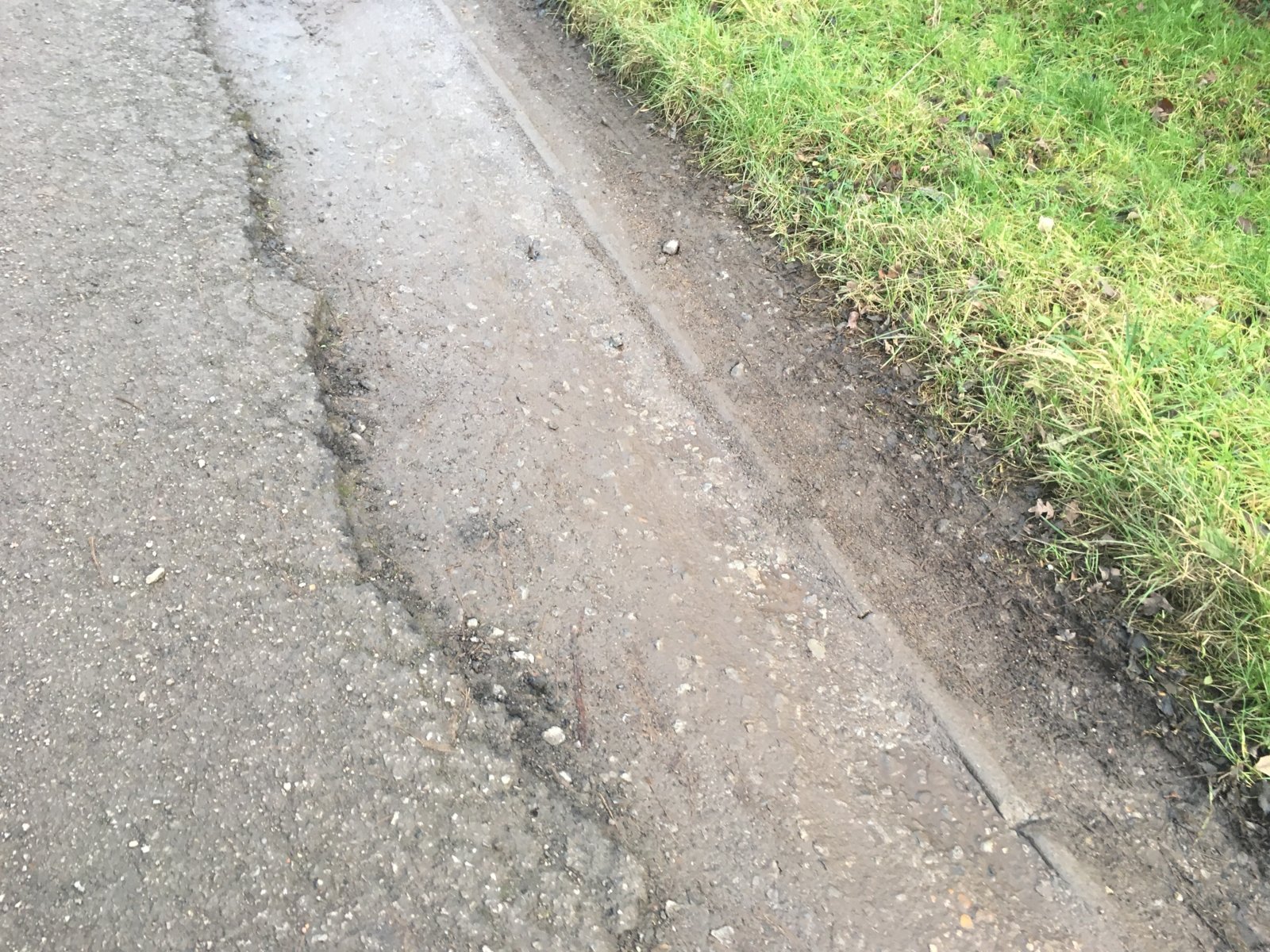

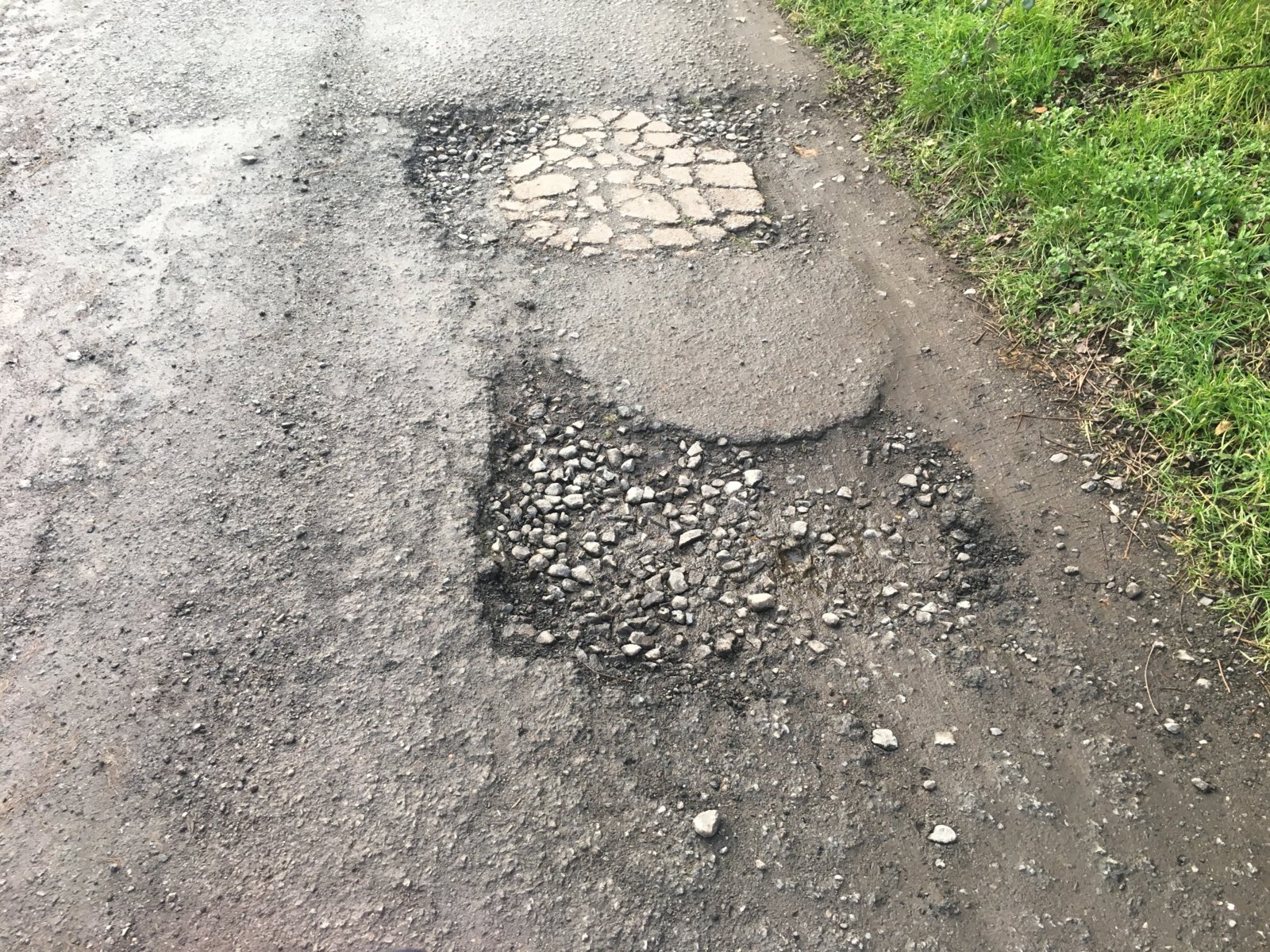

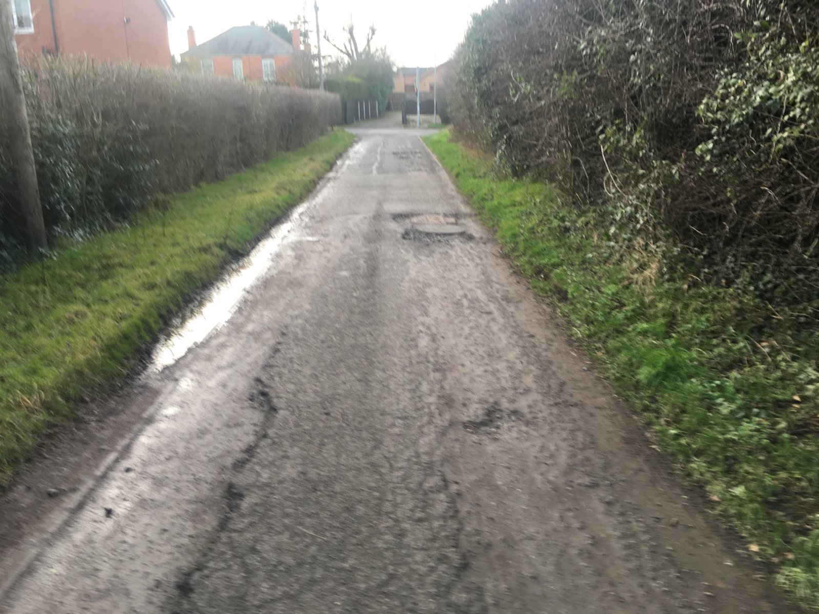

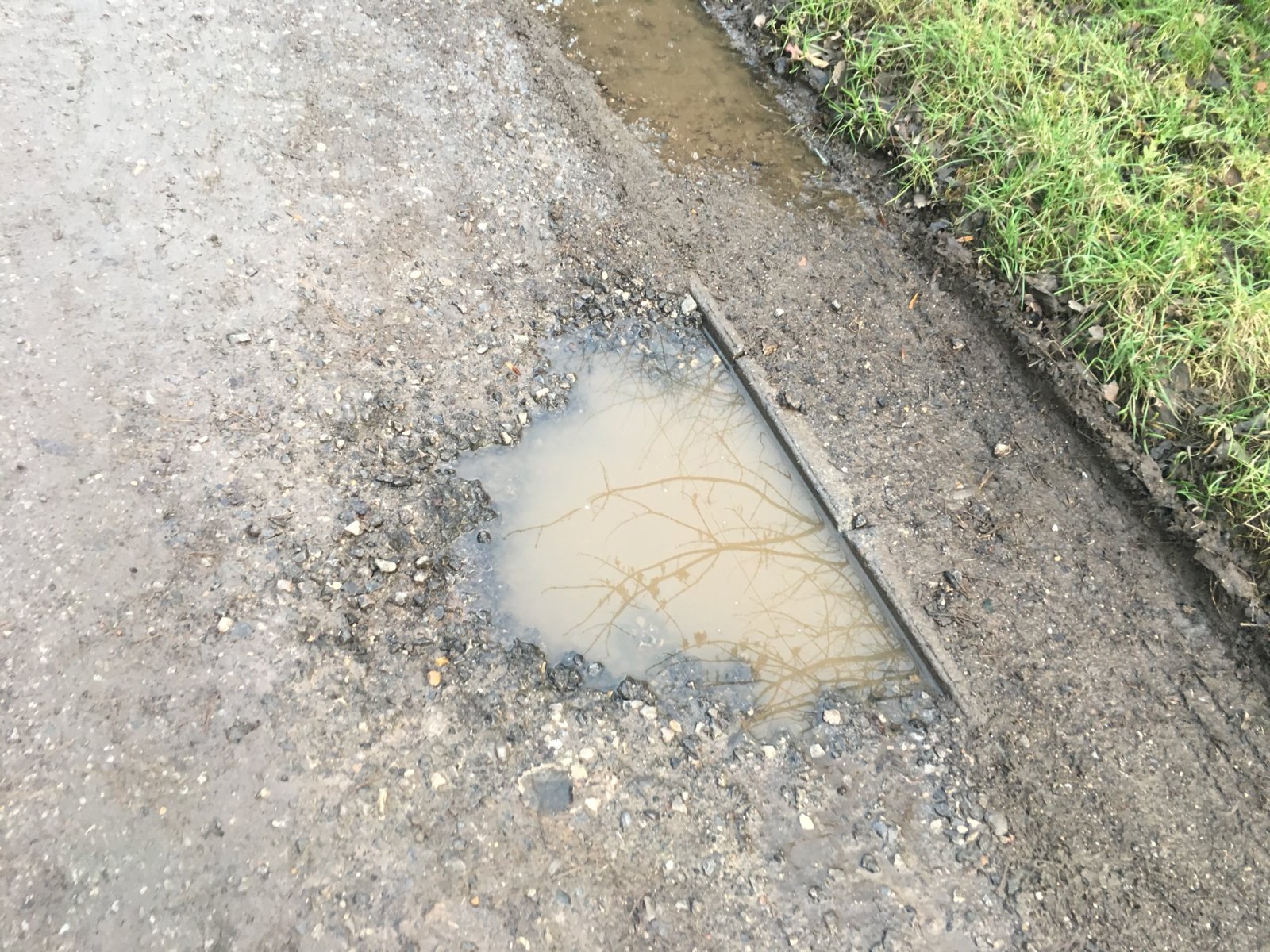

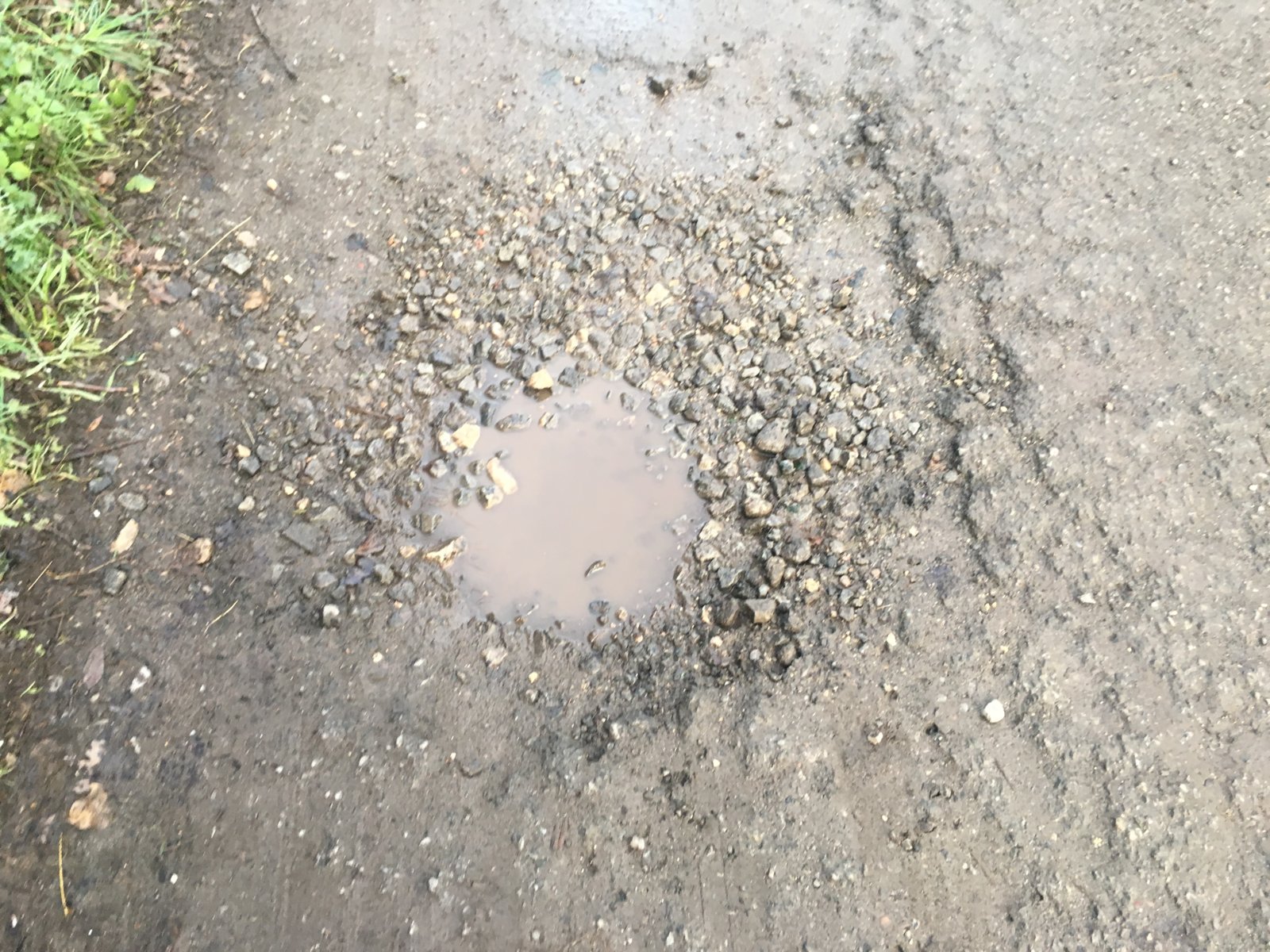

What are my options for the cheapest method?
You want to cut them square then use a wacker to put some decent cold lay into them.
Or if your not too bothered about looks maybe a concrete dyed black would be cheaper.

It will be the cheapest and it will last the shortest. A few weeks, whether ballast, sand or whatever. So a false economy.
A proper job will involve widening the hole, excavating out all the damp, soft, soggy, spongy, hardcore, reinstating hardcore and then if you are doing all this, might nas well do the tarmacing with a base and top coat and sealing the edges.

I get that this is the proper way and one that will last. What if I sweep out all the loose material, compact whatever is remaining, part fill with concrete any deep holes and then top of with 20mm of cold lay tarmac?[/QUOTE]

In reality, you can fill it with concrete or tarmac and that will form a surface. But the things which will determine how long it lasts is whether the base is firm and whether the area collects water - which then either degrades the repair or degrades the tacmac around the repair.

How many vehicles/houses use the track?
3 houses, I’d say 10 cars but it’s also a rear access to a farm which use it very little apart from harvest time and getting grass in for the cattle but when they use it then it’s literally 12 hours solid with big heavy tractors coming every 10 minutes. It’s the tractors that have caused the damage in my opinion. Further down the lane, which I don’t use, is really bad in comparison.
I don't think the tractors will cause potholes, but there's one section where it looks like the whole side has sunk 3" for a couple of metres, heavy vehicles and poor foundations have probably led to that.
No point doing a complete bodge, with 3 houses it won't last long at all.
The budget option might be a local general builder/contractor supplying a ton or 2 of hot tar. The cold tar in plastic bags is quite expensive.
