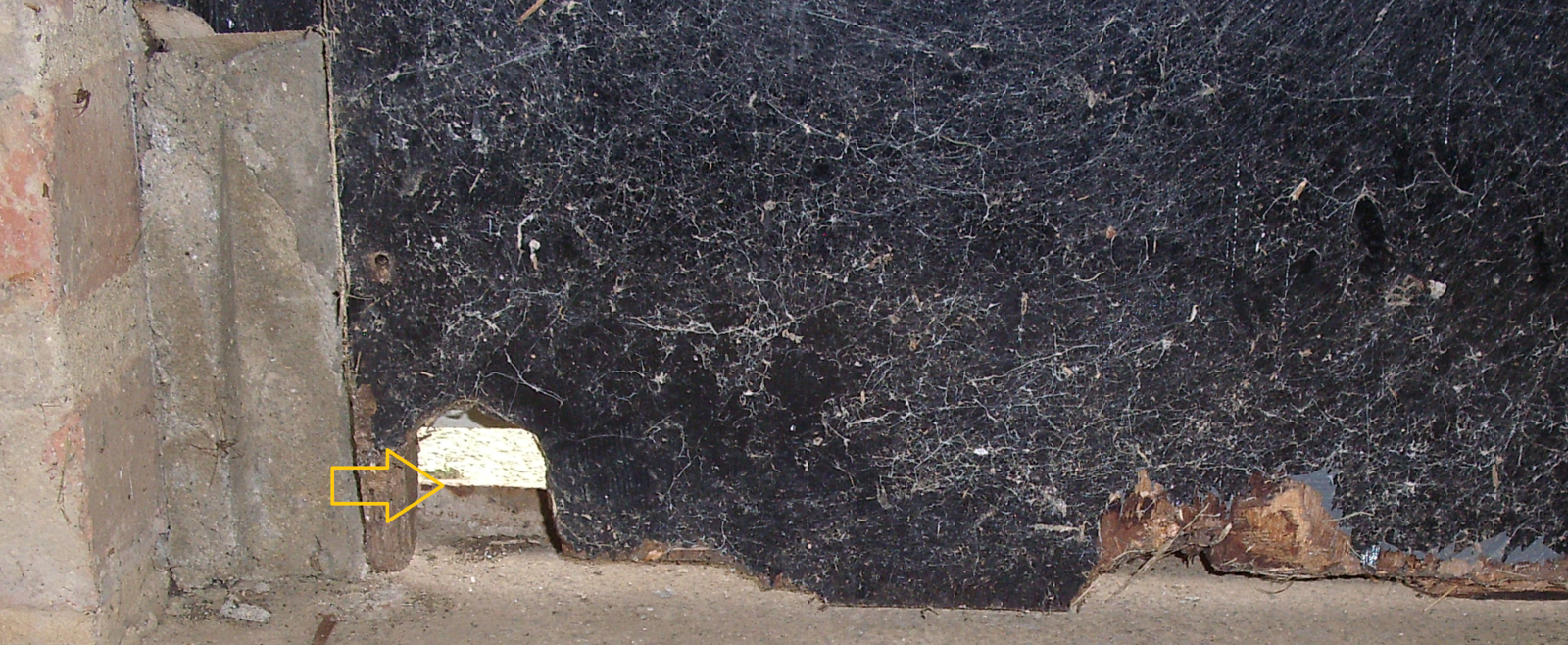

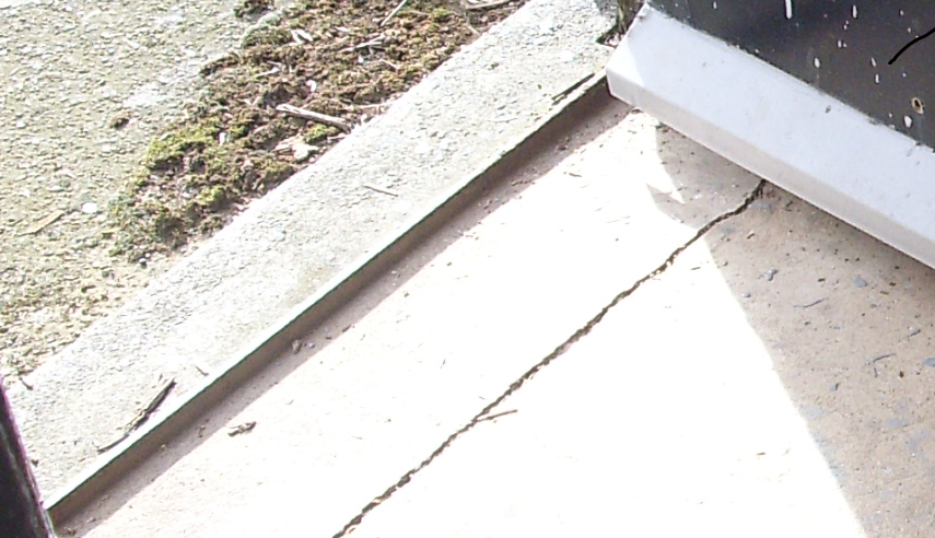

This door includes a thin steel sheet for radio frequency screening to withing a few mm from the bottom or just enough to clear the threasdhold (arrowed).
EDIT: Just to clarify the pic, the arrow points to the top of the metal weather bar, the brighter part is the concrete step t'other side
