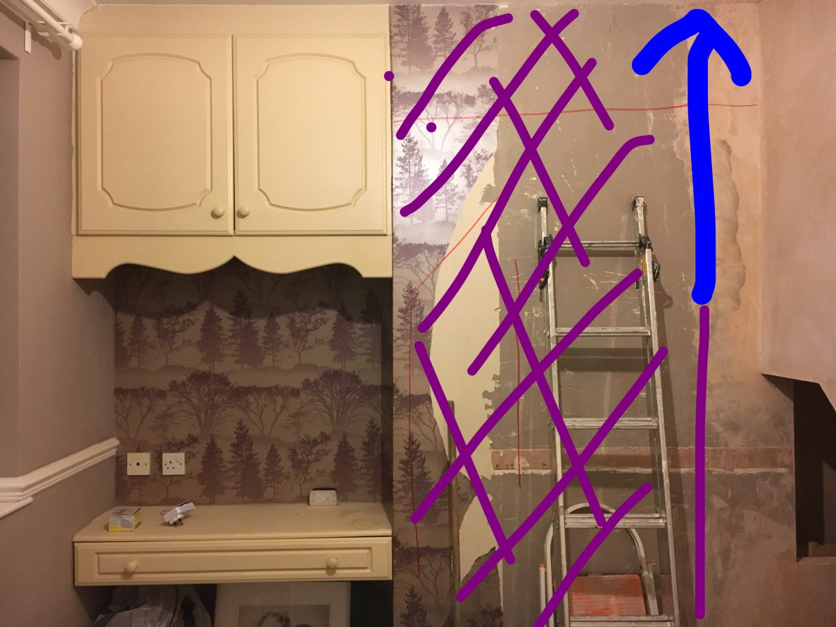

I want to remove a chimney breast in my daughters bedroom to give us more options on bed / furniture postions ( don't like the idea of her bed under the window ).
Anyway on the picture the blue arrow shows where the corner of the chimney breast is supporting one of the loft conversion beams. The purple section is the bit I want to remove.
The chimney has already been removed above to ceiling level and I should mention that theirs also a false ceiling joists attached to the breast .... how's best to approach this ? Gallows bracket on the right ?

Why not post photos showing the c/breast to ceiling line, & another of the whole c/breast.
If you are aiming for more room then remove the whole c/breast up to the ceiling joists.
Assuming the c/breast below is absent or redundant?

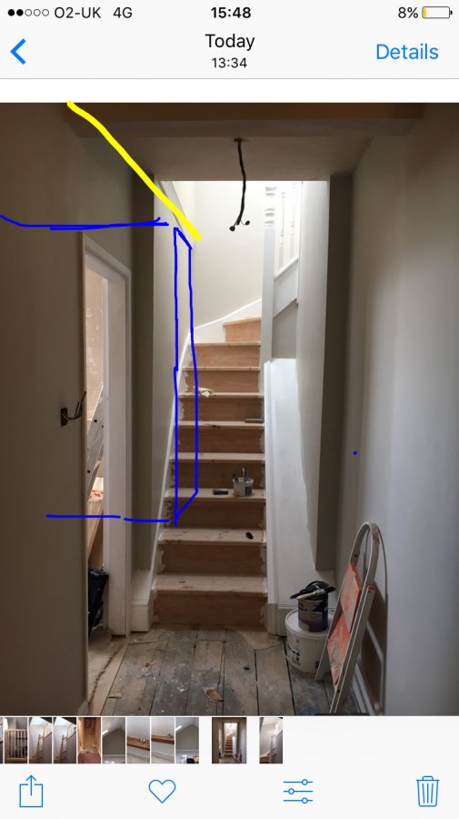

It's a gable and the SE said it was better to use the corner of the breast as well as a single brick seating into the gable because the of the condition of the gable brickwork and also the position of the beam was such that we were just on the edge of the where the inner skin met the opening for the chimney.
The beam is only actually supporting the roof and a stair well trimming and not actually any floor joists.
Then bedroom from the first photo is on the left through the door and the rough footprint of the chimney is in blue ... the beam runs across as per the blue line.
Building controlled have passed this structurally ? Surely a problem would have been picked up then ?

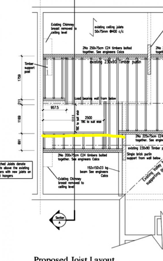

Photo attached and will post the joist layout plan shortly

This is the configuration but the beam is actually where the yellow line is and not as drawn ( because where it's drawn the gable is single skin ( rear of removed chimney stack ) and wasn't great condition to be honest. We moved it closer to the stair well for a more solid fix on the inner skin / corner of the chimney stack.

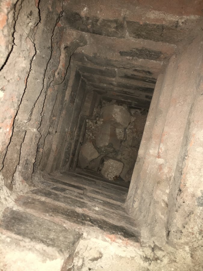

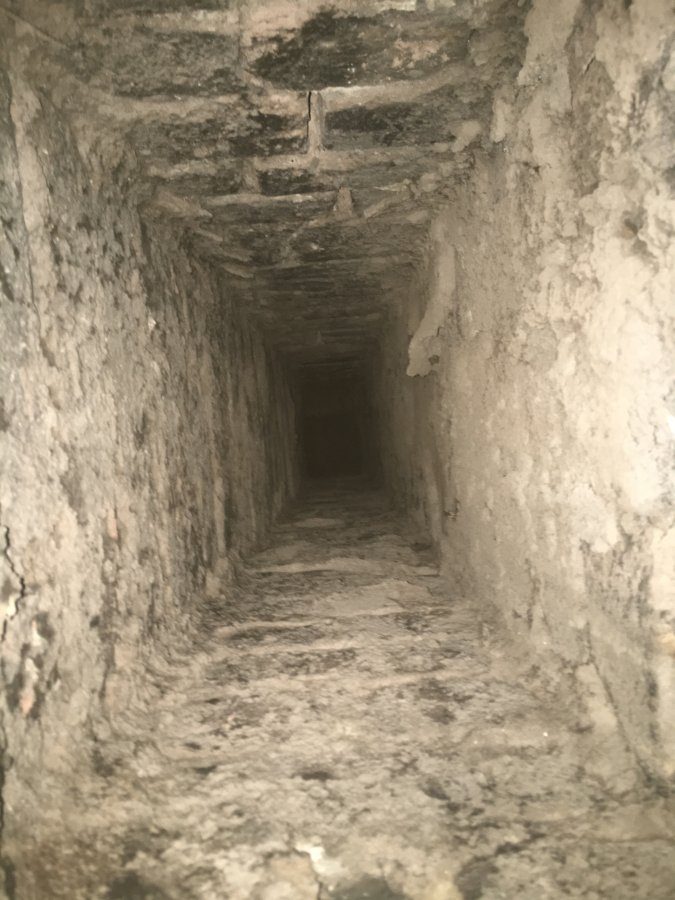

Thanks fella, was talking about the salts from the flu / soot but having now inspected the situation further it would appear that the half I want to remove is full to ceiling level of bricks and rubble, so it would be complete ( even more so ) nightmare now to remove.

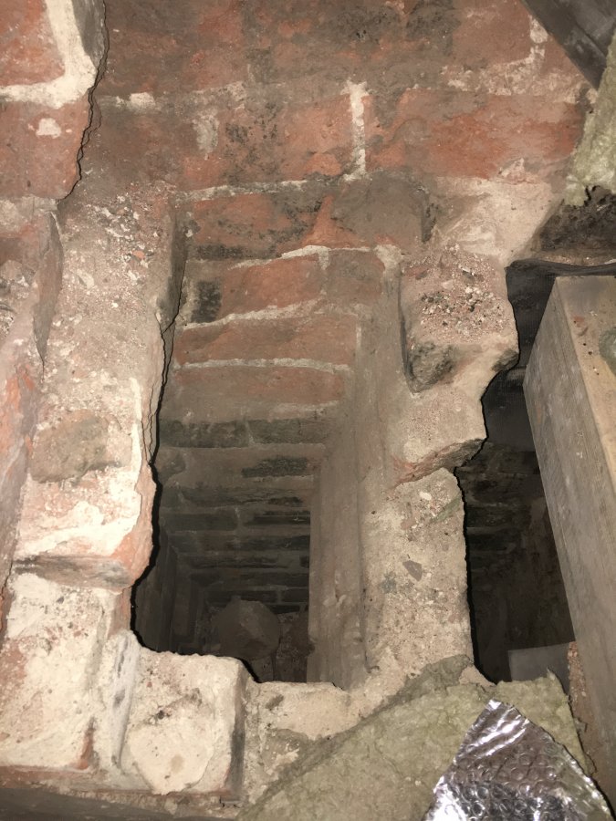

The side down to ground level is clear enough I've attached pictures where you can see the loft beam sitting on the breast.
I'm having second thoughts tbh ....

I can see a joist that has been run into a flue and is resting on the single brick flue wall.
For a few reasons, there's no way would any BCO I've dealt with allow such an arrangement.
Neither would I have detailed such a construction.
If you wish to bite the bullet, then prop the joist in question, and remove the whole chimney breast (both flues) down to first floor level.
You could then bolt a noggin or block in the joist bay - tight to the joist.
Then use angle brackets from noggin to joist, to pin the joist in place. A heavy duty angle bracket could be bolted to the wall below the joist - google pics of these HD brackets.
Removing the debris from the LH flue is a simple matter - just pick it out and put it in a bucket.

From what you say, the sistered LH joist in question is actually doing nothing for anything at the moment? I'm not even certain as to how the other RH joist is situated? Or how supporting the roof comes into it - is the stud wall supporting a purlin?
